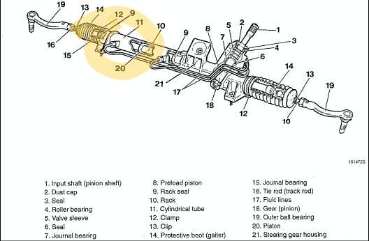

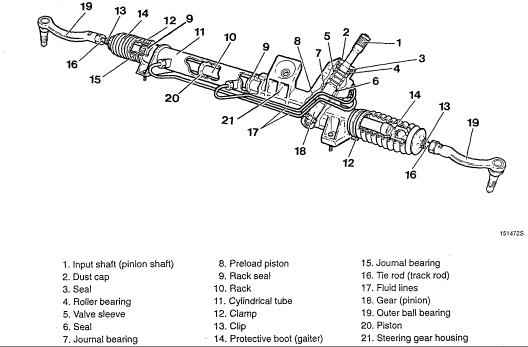

Hi guys I'm trying to find out where I can get the hard lines for the steering rack. Just the small metal hose that on the rack not the pressure or return houses. I thought it was pressure line, but I replaced it and it still leaked. Went under car while helper turned the wheel and saw fluid spraying out the small hose. Now I need a new one and don't no where to get it. I was gonna try using a break line, but they don't have that extra part where the oring resides on. Number 17 fluid hard lines
