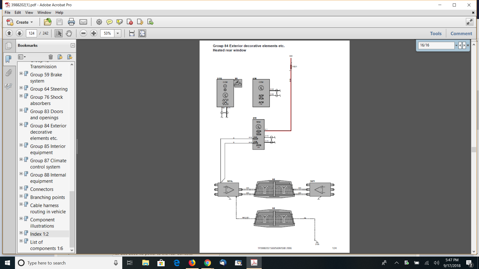

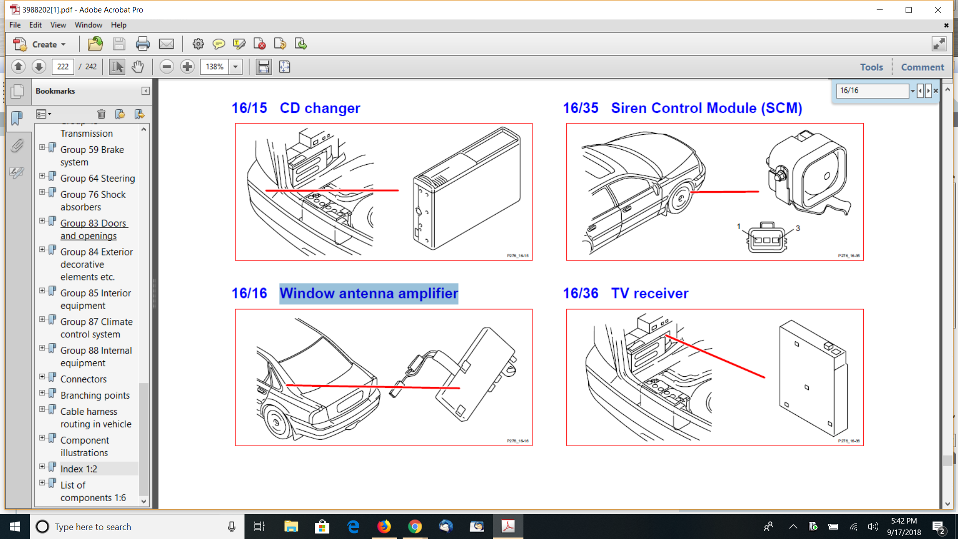

No relay, power to the heating elements is through the Window antenna amplifier and the fuses are F37 & F38 in the trunk. The heating is controlled by the REM (Rear Electronic Module ).

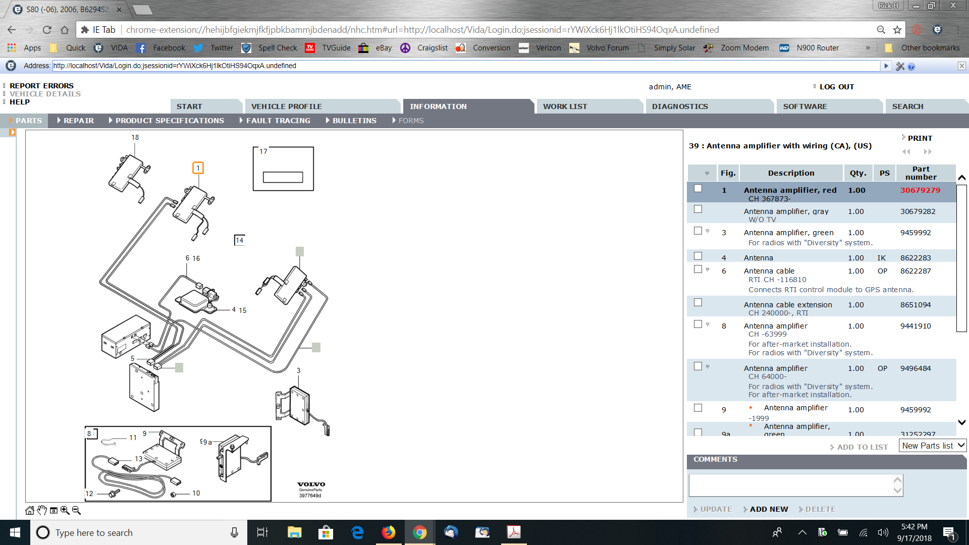

Thank you. My connectors are like the ones on item #18 on the top picture. From the vida replacement procedure of the rear window, it seems the power connector is the one that looks like a 9v battely plug (2 buttons side by side).
In my case, radio works fine so I guess the antenna module isn't dead? Fuses 37-38 are not burned, and the main fuse of 40A (#31) isnt burned either... Since Vida doesnt throw a code either with the Dice unit, is there something in particular I should look into? The whole REM module dead?

Have you inspected the rear window heating elements for opens?
