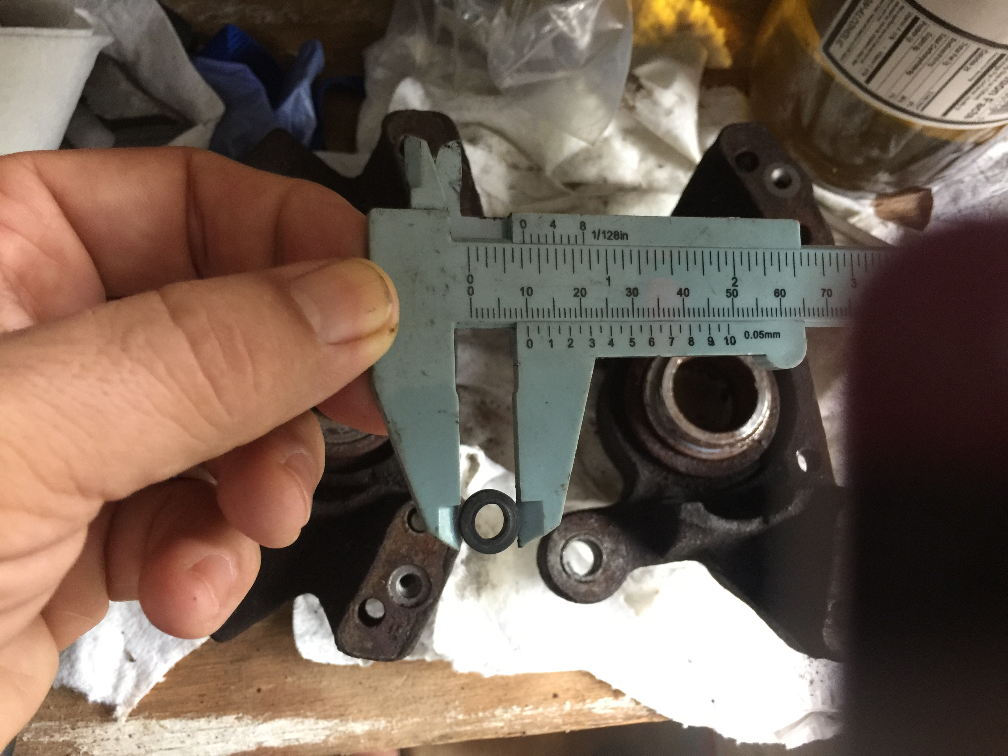

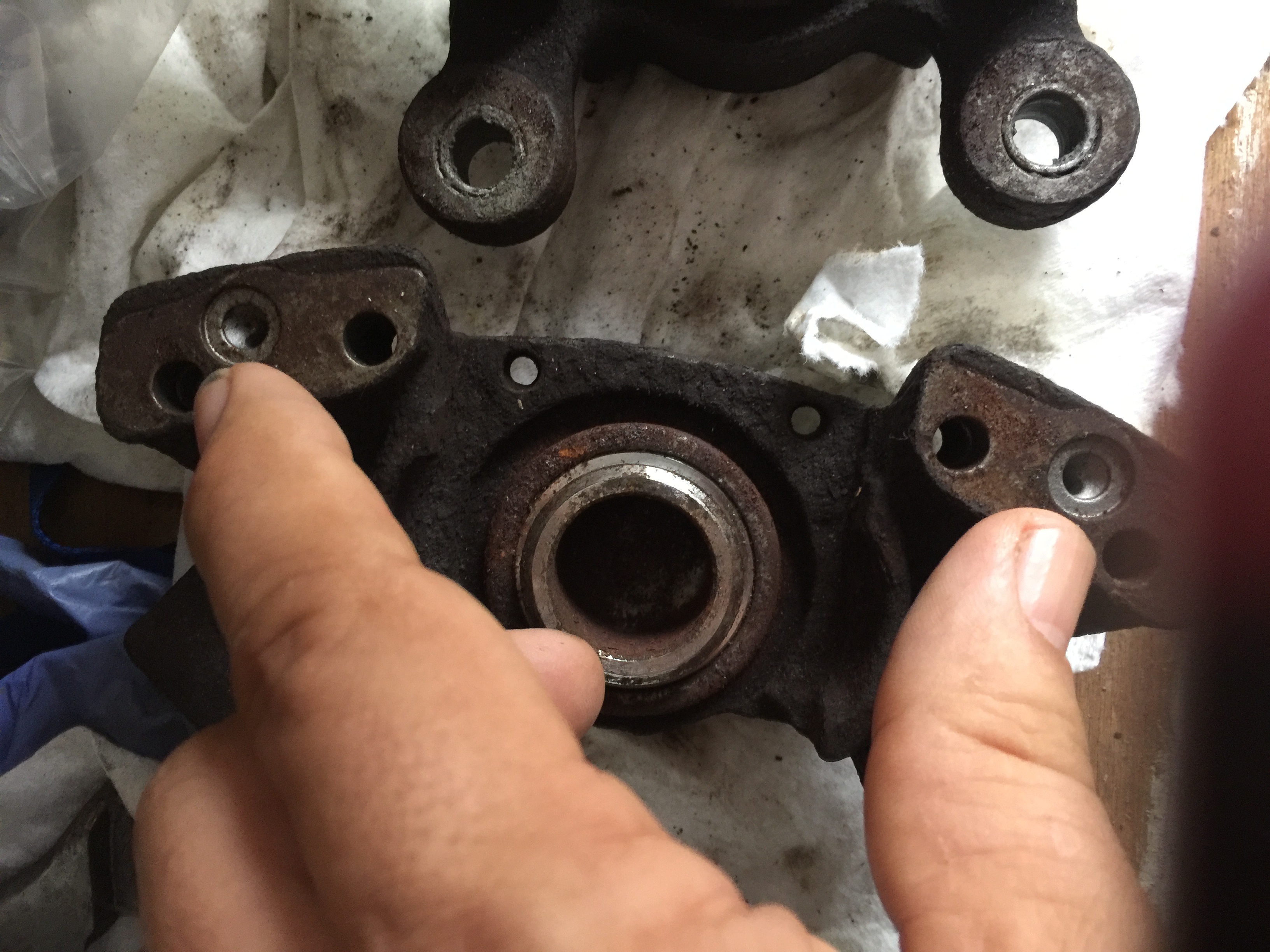

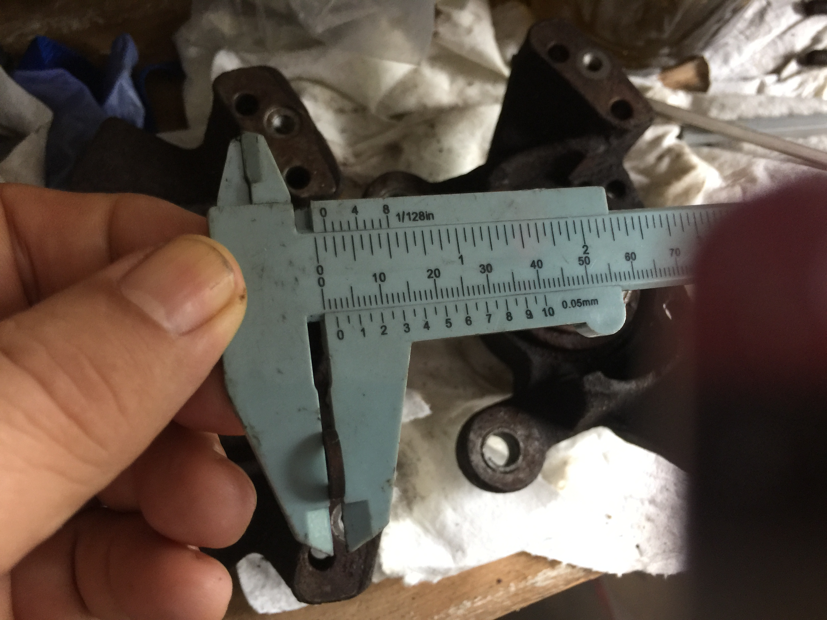

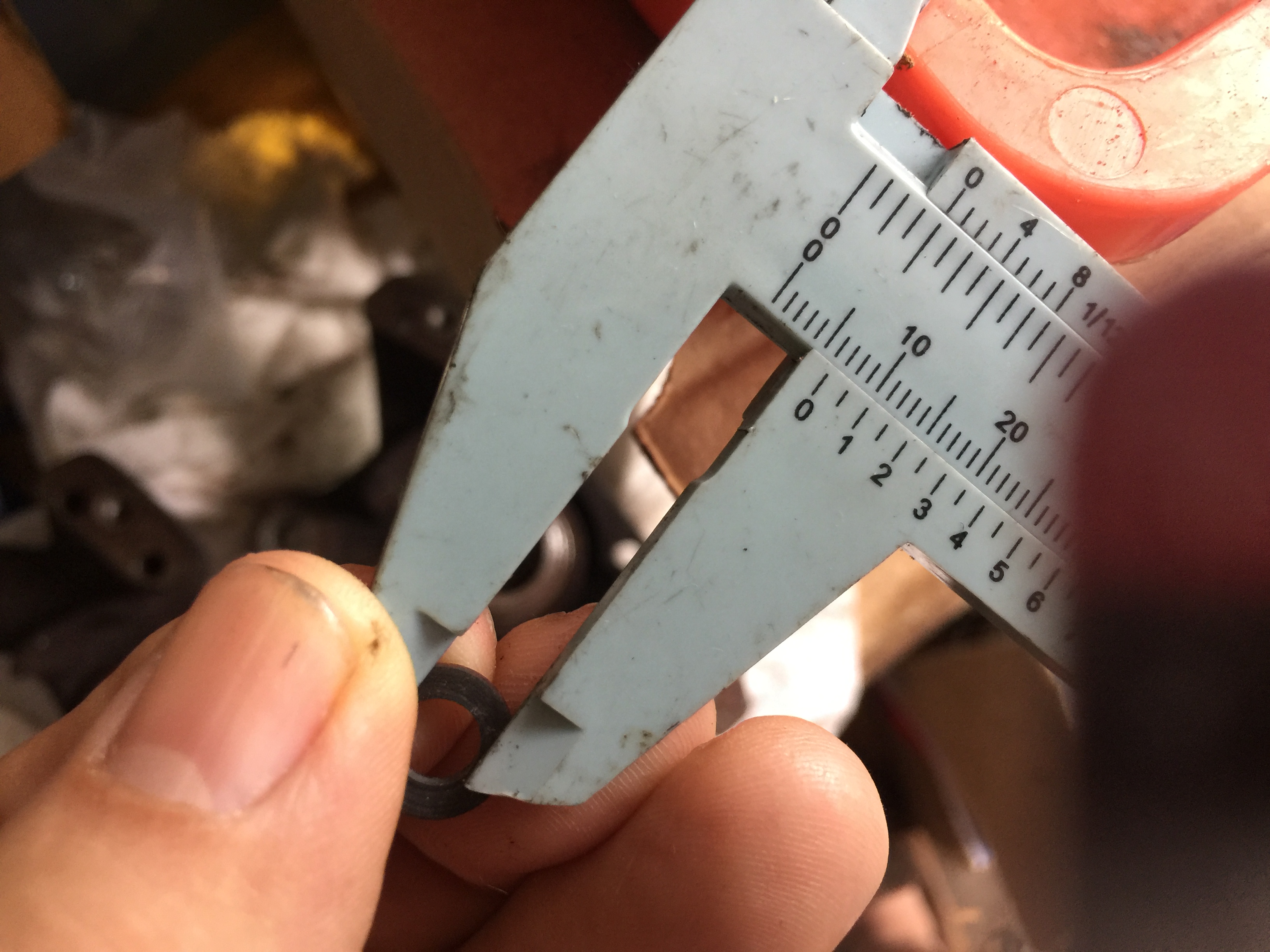

Dimensions of internal caliper orings
- rspi
- Posts: 7304
- Joined: 05 Nov 2011, 10:40
- Location: Cincinnati OH
- Has thanked: 34 times
- Been thanked: 72 times
Contact rspi..
