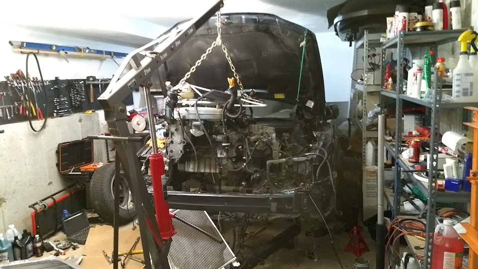

Picture- rest of front all taken off for other reasons?
Pete

Post by vtl »
Yes, I was swapping out chassis that met with rocks and trees in icy forest ;) Every good bit was taken out and put into a reasonably cheap, neglected donor.
