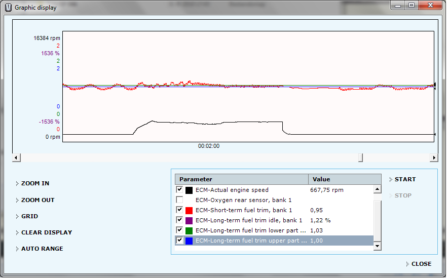

Thanks! Immediately went back and checked. Does it matter if engine is at operating temperature? It was still warm, but probably not at operating temperature. Readouts changed after running for a while, although I don't know what any of these mean. These are the results.
The following readouts do not change when revving to about 2500rpm, but do change slightly after having run the engine for a while
Long-term fuel trim idle, bank 1: starts at -0,09% then 1,22%
Long-term fuel trim lower part load, bank 1: starts at 1,01 then 1,03
Long-term fuel trim upper part load, bank 1: 1,00
Short-term fuel trim, bank 1: starts at 1,18, then oscillating from 0,95 to 1,05. Behavior changes when revving, although the value does not really change. Does not return to this oscillating behavior immediately after revving; see the attached photo.

See how your fuel trims converge to 0% ( value of 1) at revs?
At idle the ECU is hunting the fuel trim trying to compensate for air that the MAF doesn’t see.
Vacuum leak. Beautiful data.
