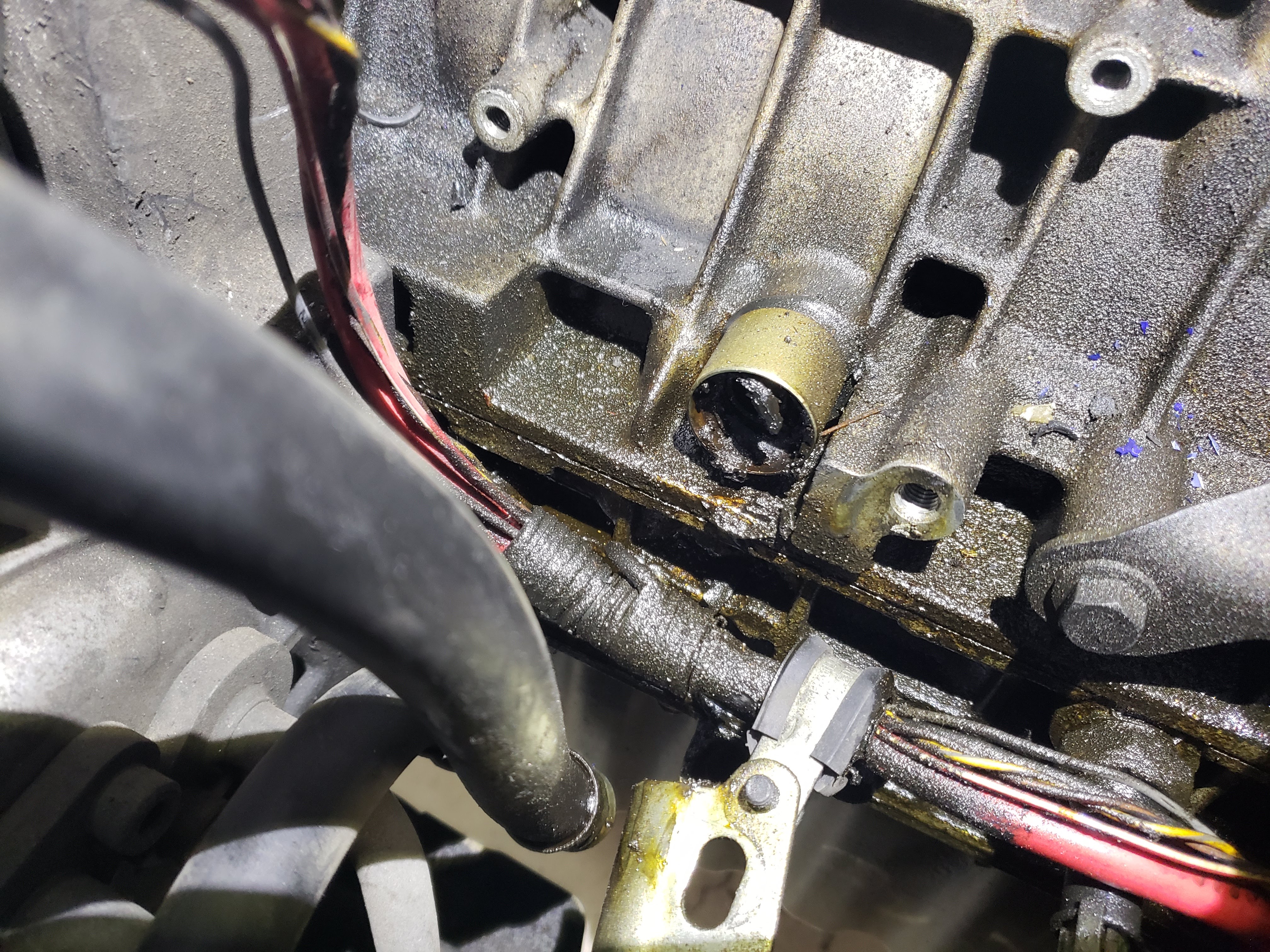

When I first got this car it had a really bad oil leak. Turns out the rear cam seal popped out behind the cam sensor. I figured it was likely due to a blocked PCV system so I replaced it all with a URO Parts PCV system.

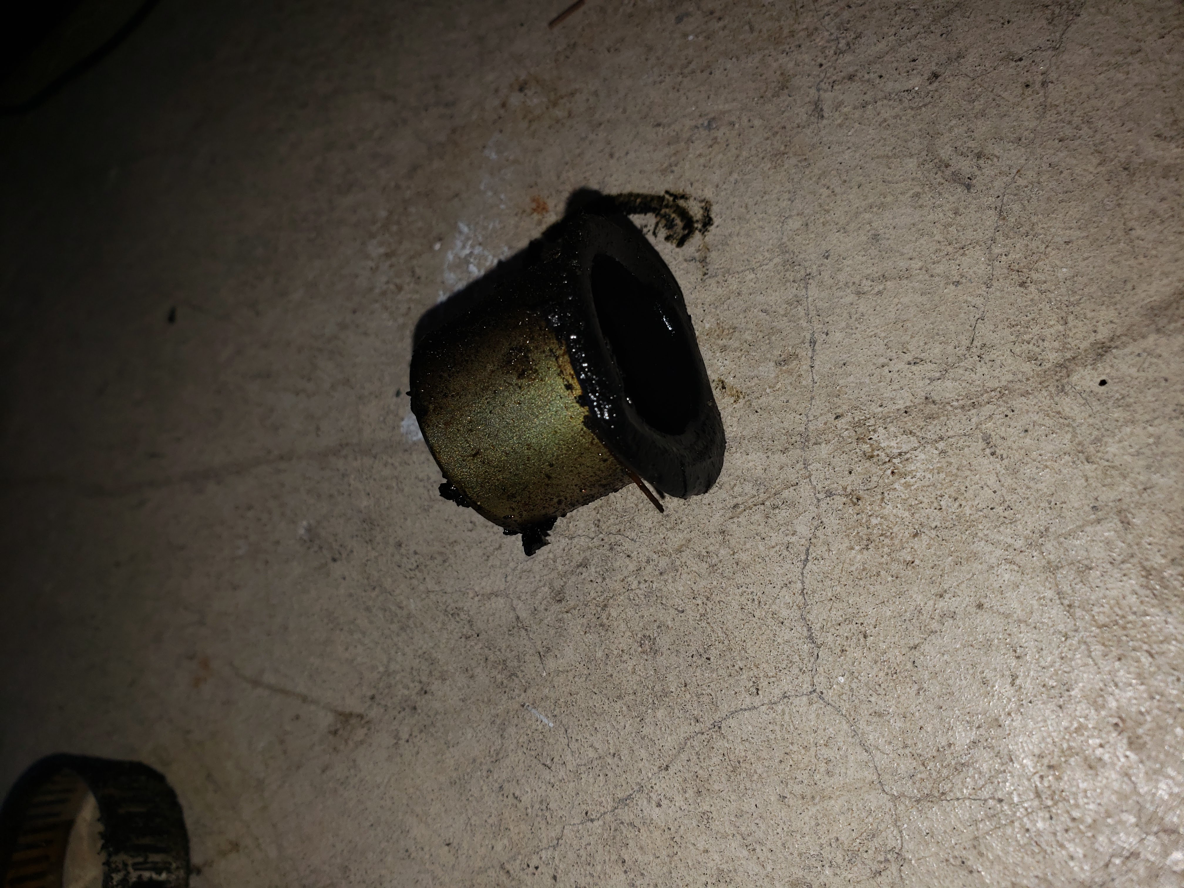

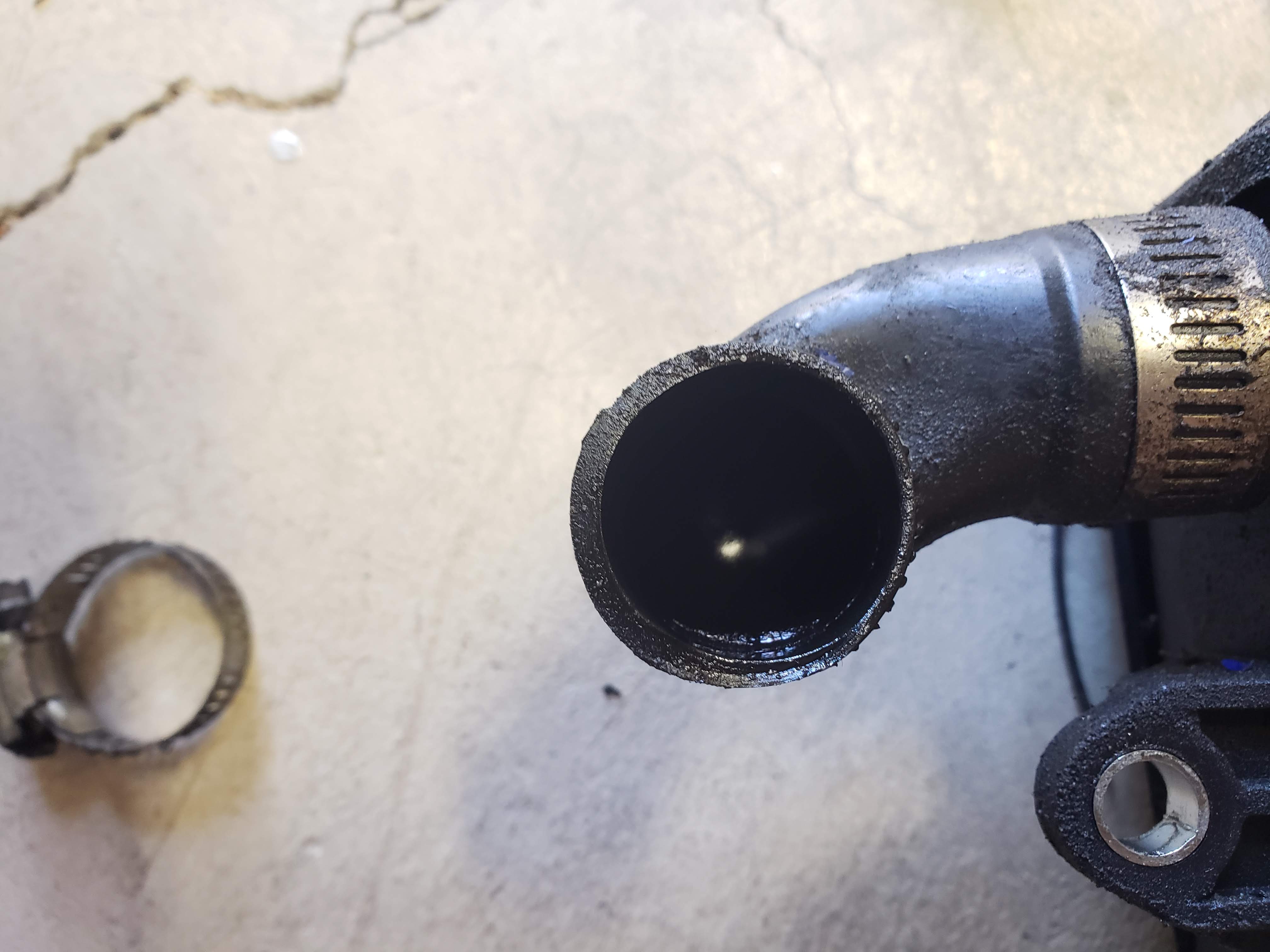

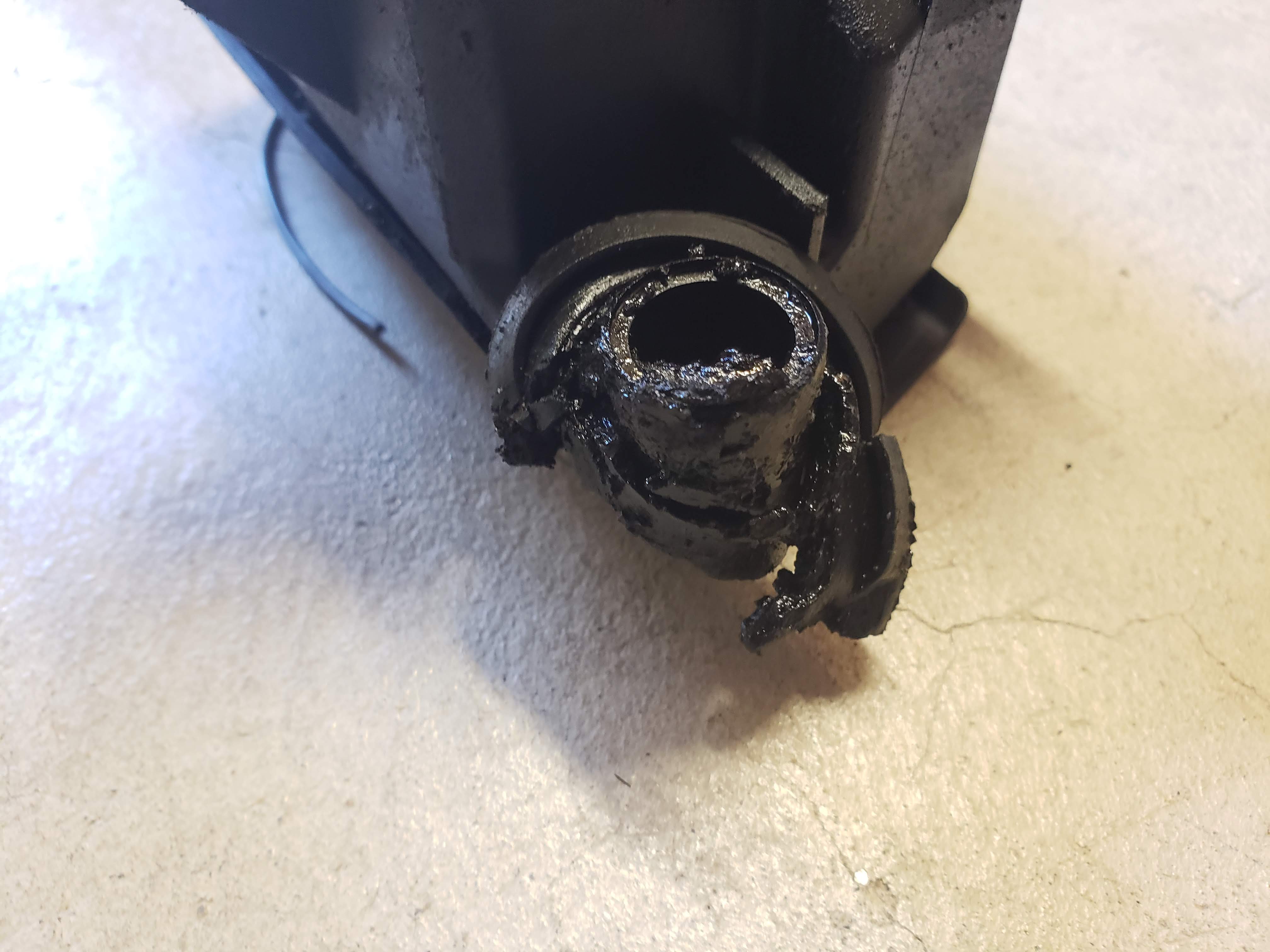

5.5 years and 20k miles later the car is leaking a bunch of oil from the front of the engine. After lots of cleaning I figured it was coming from the PCV oil trap box area. The lower hose/bushing thing was total mush. The upper hose was also trash. About 3 years ago I had to replace the two 90 degree adapters that connect to the PTC valve. The 90 degree adapter going to the intake manifold disintegrated when removing the manifold.
I replaced it all with genuine Volvo parts. Lesson learned.
