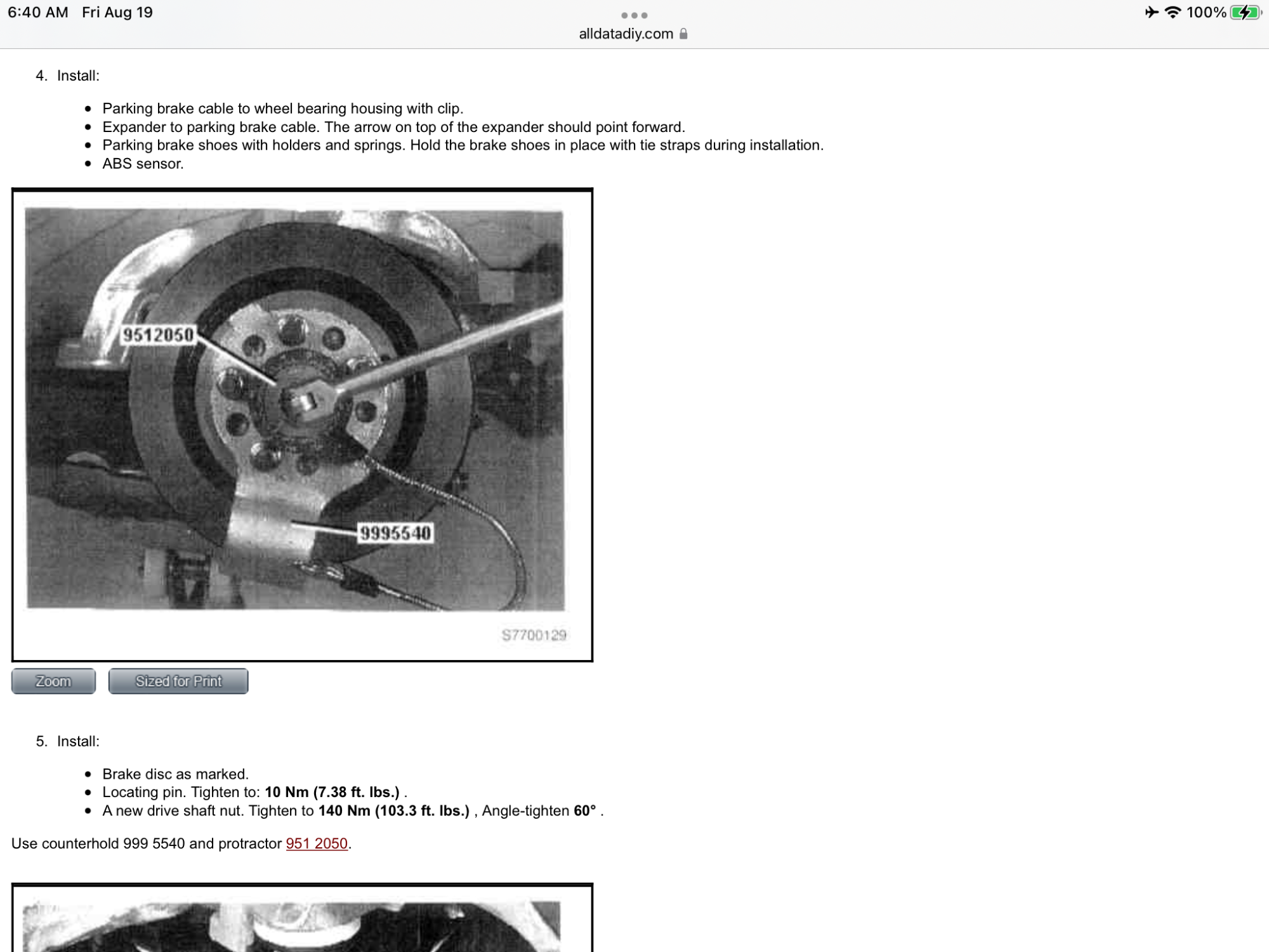

Torque different for AWD later models and for 1999-2000, too)
Added A2D rear wheel bearing hub specs

I think there are different parts for FWD and AWD
Also, FCP says the part is the same, but Alldata says the torque on the 1999 on is different

Ensure the shaft is clean.
Use a new nut. Tighten to 120 Nm . Angle-tighten to 30°.
Use bevel protractor 951 2050.
Check that there is no play in the bearing after installation.
Install the cap.
Use drift 999 5225.1999 rear hub nut spec
Install the cap.
- Posts: 36156
- Has thanked: 1611 times
- Been thanked: 4072 times
It looks like they backed the torque off in 99
A change in angle torque from 120 degrees ( early) to 30 (1999) is a huge change in final torque
The nut doesn’t see any rotational force, it just pins the hub to the shoulder on the spindle.
Confessions..when I did my rear hub I re-used the nut as I calculated the deformation was near zero, well below the plastic limit
- Posts: 36156
Jim - I have no idea if that spec is retroactive, but the parts are the same according to FCP and Volvo Parts Lisle
