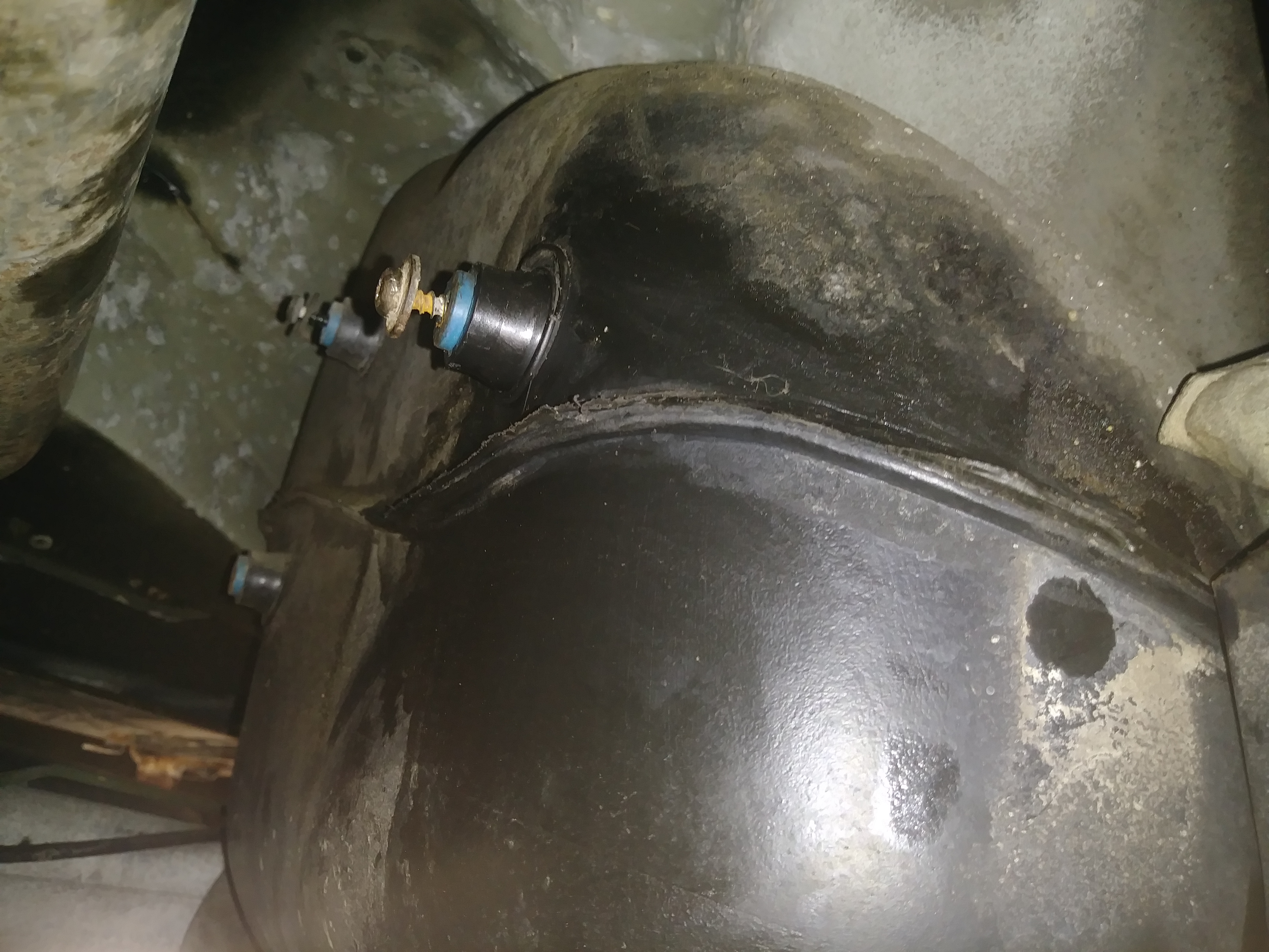

**I do not know a lot about the fuel tank on a P80. That said, A leak at only 6 gallons (1/3 of tank) is not very much. I don't think a leaky line for fuel filler or evap system will cause a leak at that level of fuel. I think it is very likely that you have a hole in the fuel tank and you should definitely get that fixed asap. I do not know if the early 850s had metal or plastic fuel tanks, as that would greatly effect the recommended repair solution.
Can you crawl under WITH EYE PROTECTION, and see if you can find the leak? Like I said, should be somewhere low on the tank.

Was there not a recall on fuel tanks on early 850's?

It was on the fuel filler neck. The symptom was you'd have trouble filling it up.

Go to the dealer with honey, not vinegar.
Most recalls have a use-by date 10 years after issue date
Recall Number
04V368000
Recall Date
07/30/2004
Component
FUEL SYSTEM, GASOLINE:STORAGE
Summary
ON CERTAIN PASSENGER VEHICLES, AFTER PROLONGED EXPOSURE TO HEAT, THE FUEL TANK MAY SEEP OR LEAK FUEL AT THE POINTS WHERE THE HEAT SHIELD IS ATTACHED.
Consequence
FUEL LEAKAGE, IN THE PRESENCE OF AN IGNITION SOURCE, COULD RESULT IN A FIRE.
What Owners Should Do
VOLVO WILL INSPECT THE FUEL TANK AND REPLACE IT IF ANY EVIDENCE OF FUEL SEEPAGE OR LEAKAGE IS FOUND. ALL VEHICLES WILL RECEIVE NEW REINFORCEMENT BUSHINGS AT THE HEAT SHIELD ATTACHMENT POINTS TO PREVENT FUTURE LEAKS. THIS RECALL WILL BE CONDUCTED AS A SAFETY RECALL IN THE HOT WEATHER STATES OF ALABAMA, ARKANSAS, ARIZONA, CALIFORNIA, FLORIDA, GEORGIA, HAWAII, LOUISIANA, MISSISSIPPI, NEVADA, NEW MEXICO, NORTH CAROLINA, OKLAHOMA, SOUTH CAROLINA, TENNESSEE, TEXAS, AND UTAH, AND AS A SERVICE RECALL IN THE OTHER 33 STATES AND THE DISTRICT OF COLUMBIA. THE RECALL BEGAN ON SEPTEMBER 24, 2004. OWNERS MAY CONTACT VOLVO AT 1-800-458-1552.

The only possible leak I could find was here behind the exhaust pipe heat shield
The tailpipe had a clothes hanger holding it up before, so I assumed it was constantly banging against that sheild causing the plastic to eventually crack....
How do I seal a plastic tank?
