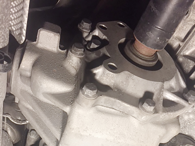

Bevel gear fluid drain and fill port. This photo reference was overdue:

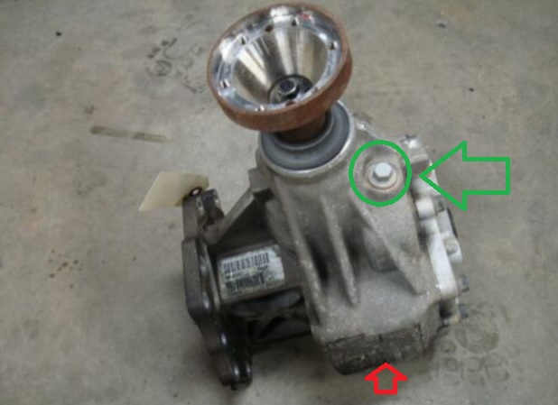

XHeart,
Green Arrow is the drain/fill port.
Red Arrow is the bottom of the Angle Gear.
Note: this only applies to the Angle Gear housing with the side flange that is 90 degrees to the Half Shaft center line
If you have a PTU that is a 45 degree angle to the Half Shaft center line then I have no idea where the drain/fill is.
Note: I drilled a drain hole for mine, getting the tube to the bottom of the Angle gear assembly is very difficult.

The port faces green arrow -- next to the axle. It is a 14mm plug.
