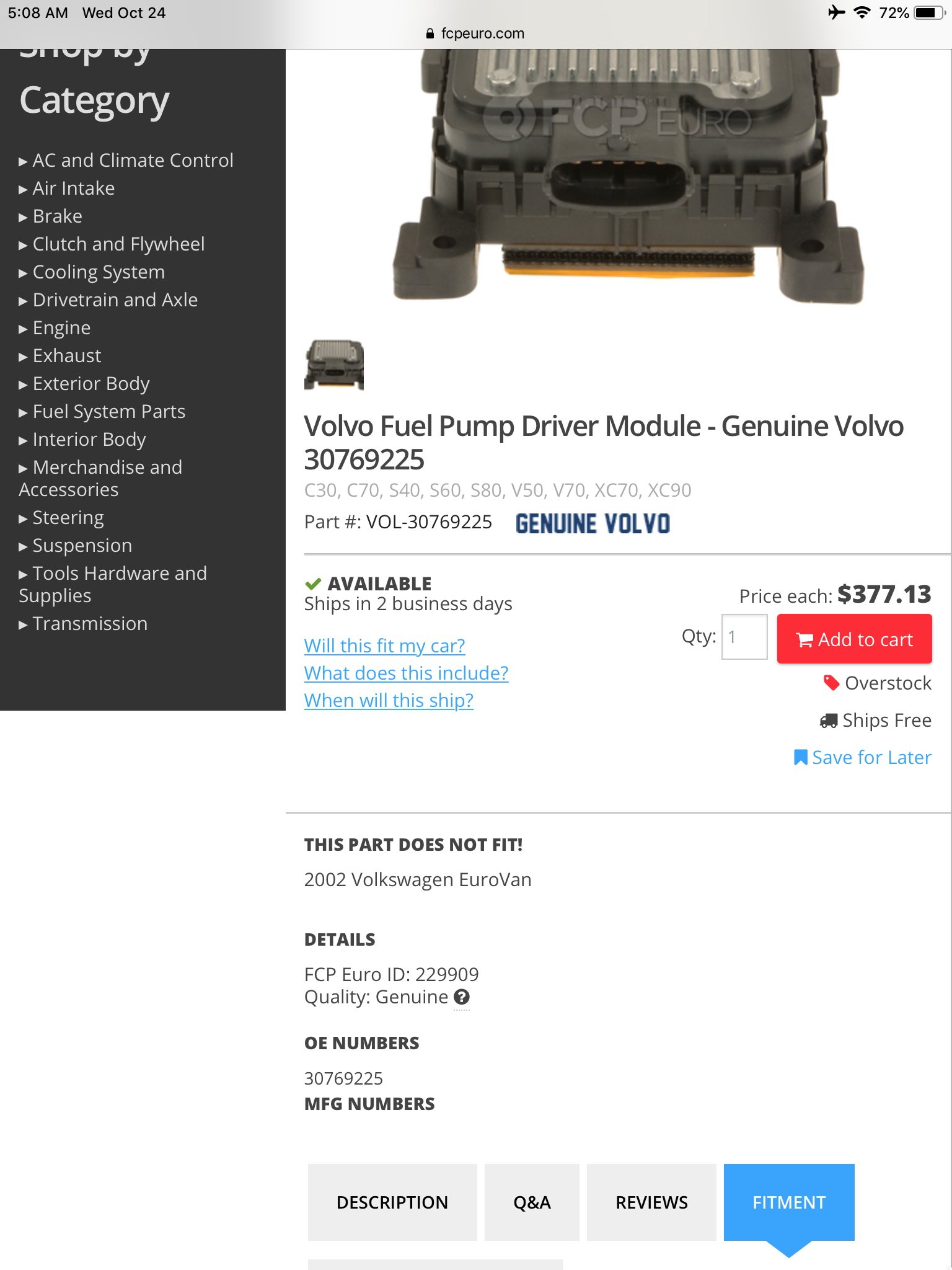

Most of the vendors have compatibility or fitment charts, just load the part number into the search tool.
FCP reports this...note this is for the metal tank only, so if your S60 has a plastic tank you need to explore more

I'm fairly sure they're interchangeable also. The couple different PNs denote different style mounting brackets, not any difference in the actual PEM.
