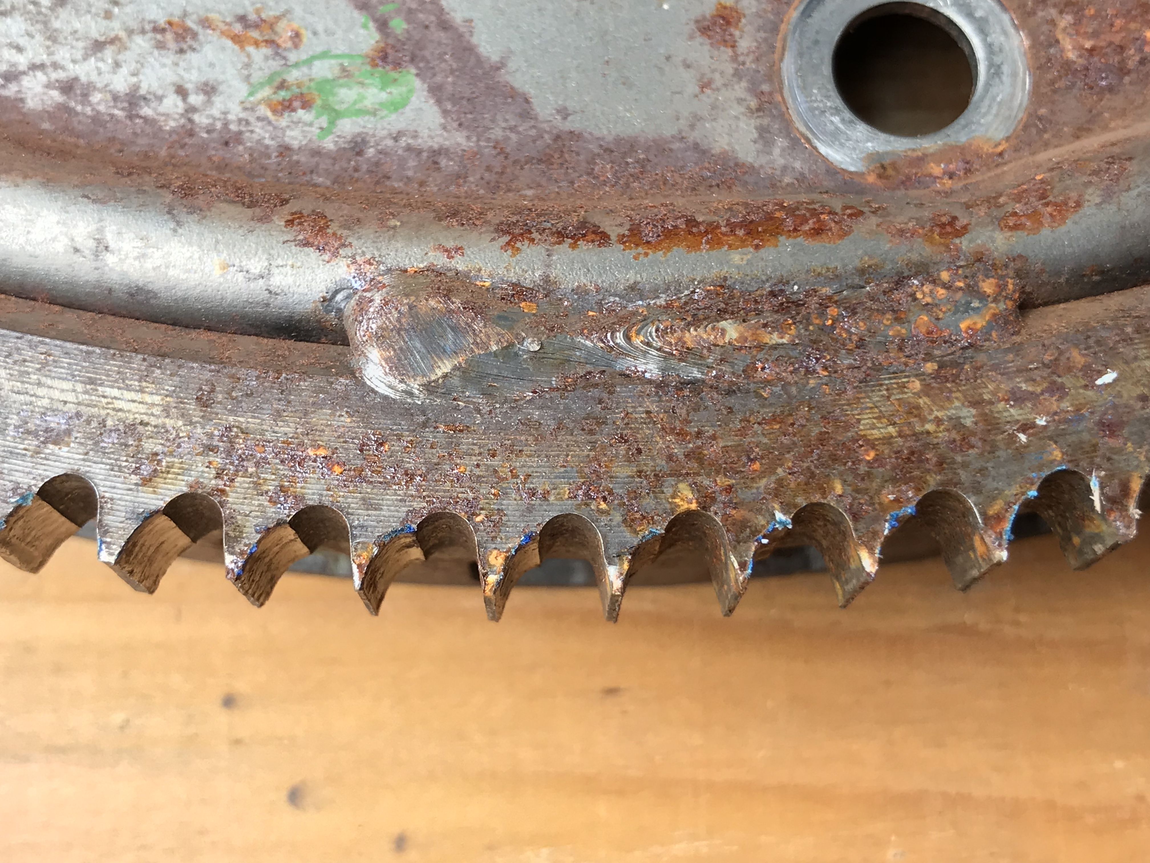

Anyhow, this is what a healthy flywheel for a 2.5T should look like.
This is out of an XC90 2.5T with about twice as many miles as are on this 04 V70 AWD (128K).
There is probably twice as much material at tips of the teeth on this as there are on the one in the V70.
$40 at Stranberg.

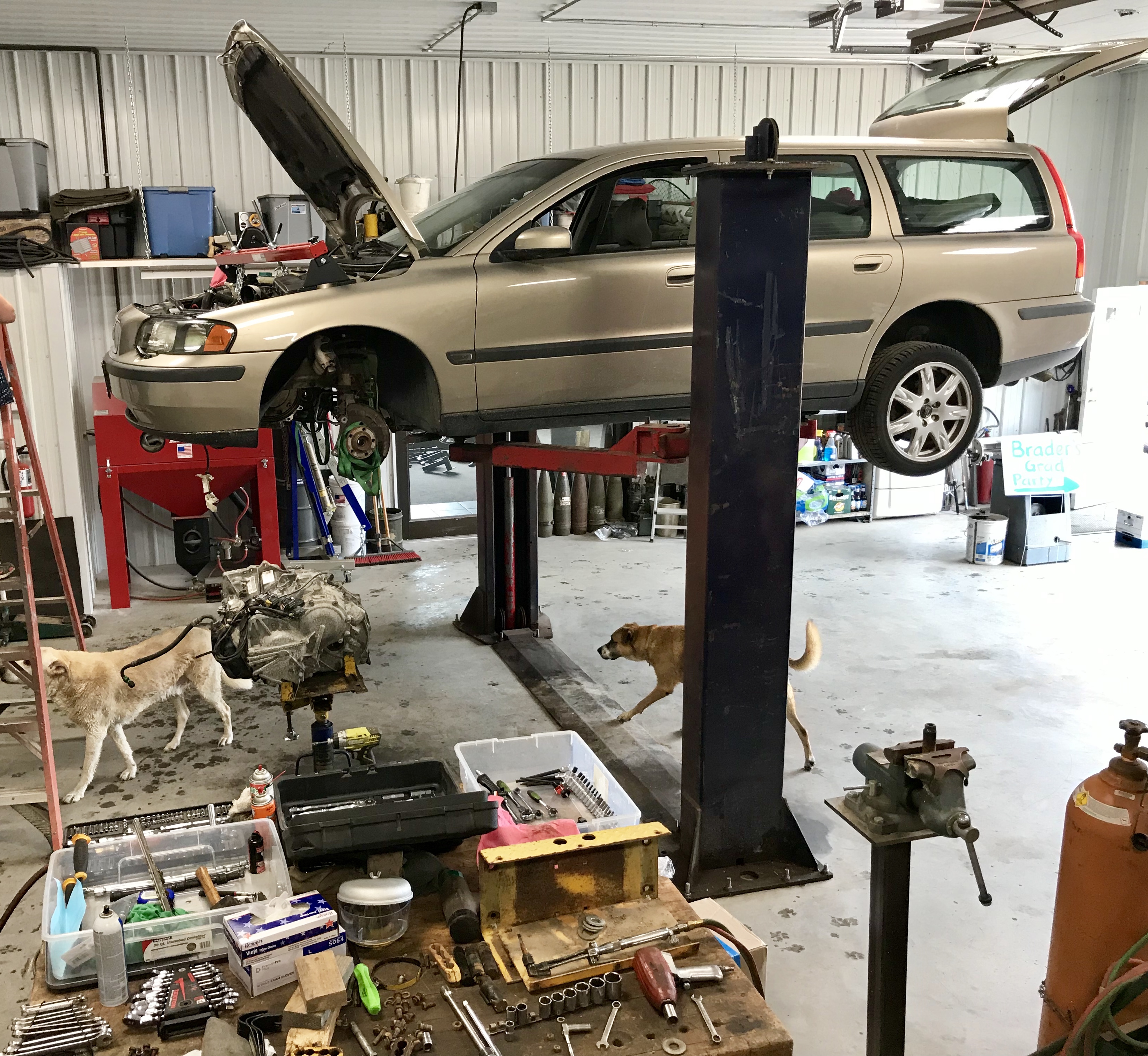

I am mid-transmission removal right now. BTW, I have a really great tip for freeing the angle gear from the driveshaft collar, but will post a dedicated thread just for that, & link it here.
I'll be suspending the engine tomorrow, dropping the front subframe, then lowering the trans on a trans-jack - everything else is out of the way as of now.

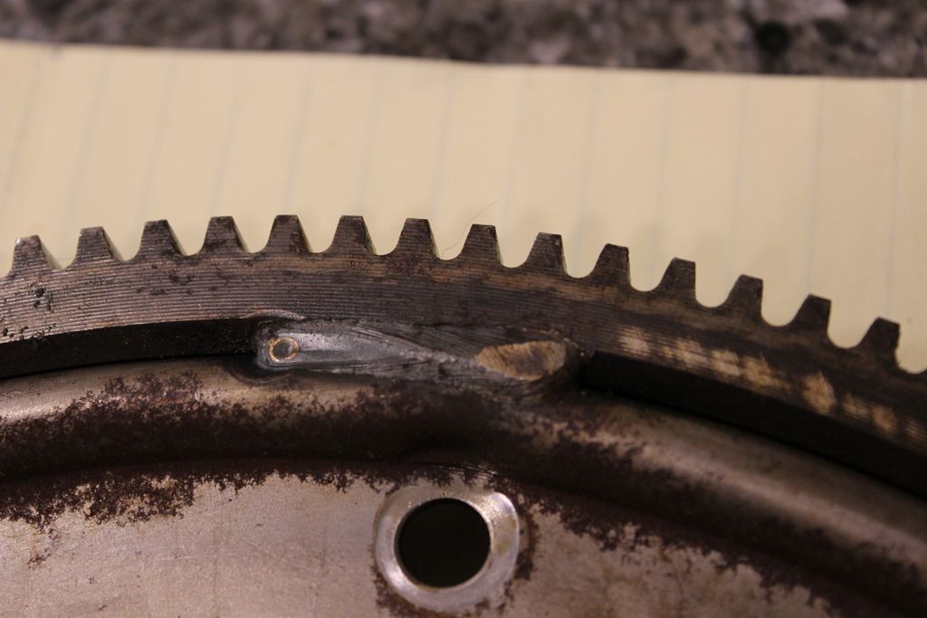

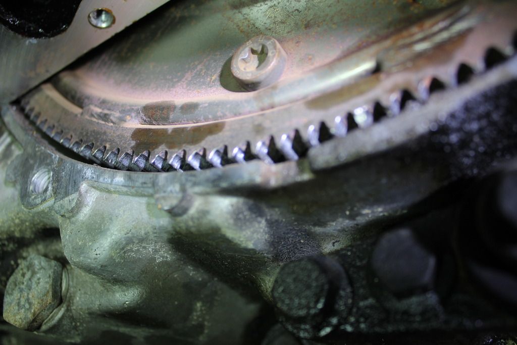

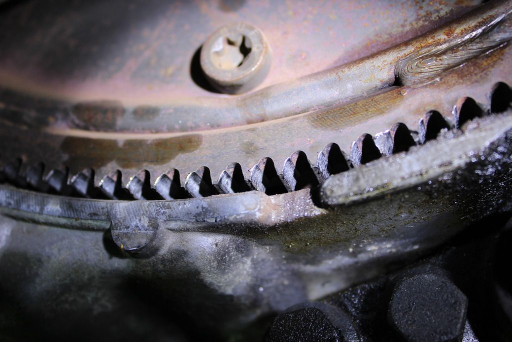

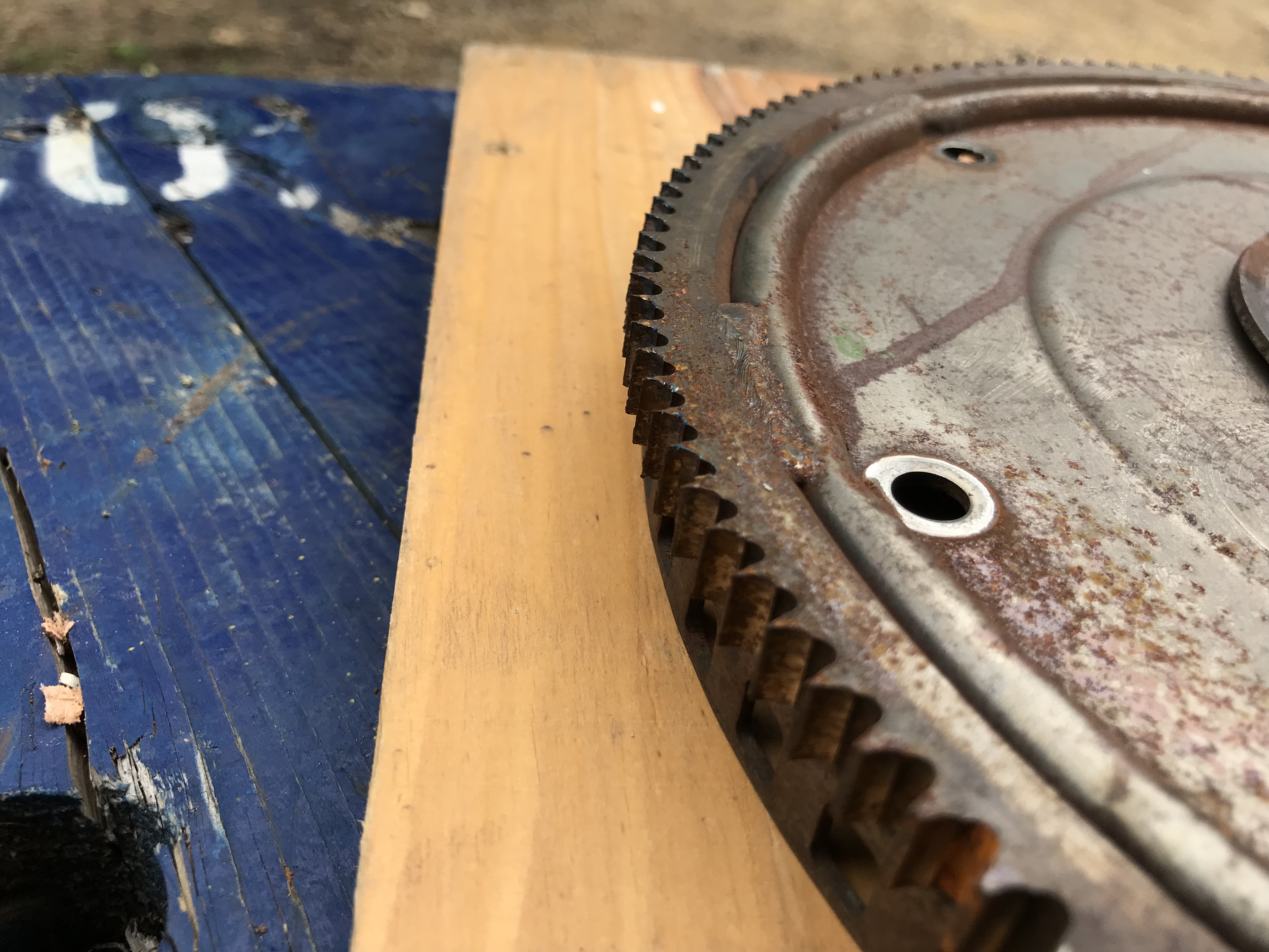

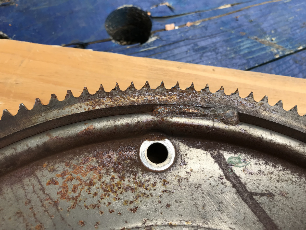

Here’s the flywheel at just over128K.
Here’s the flywheel at 130k, pretty crazy how fast those teeth have been reduced to sharp, jagged, barely-there teeth. I sincerely hope none of you need to do or pay for the repair I just finished. I firmly believe & understand why this would be a $1500-2000 repair at a shop. I paid $40 for a used replacement flywheel & did it myself with my father. We did it on a lift, used a transmission jack, engine bridge/support, and a good assortment of air tools & hand tools. I did learn a lot & no longer am intimidated by the thought of having to remove a bevel gear, transmission, or motor for that matter.

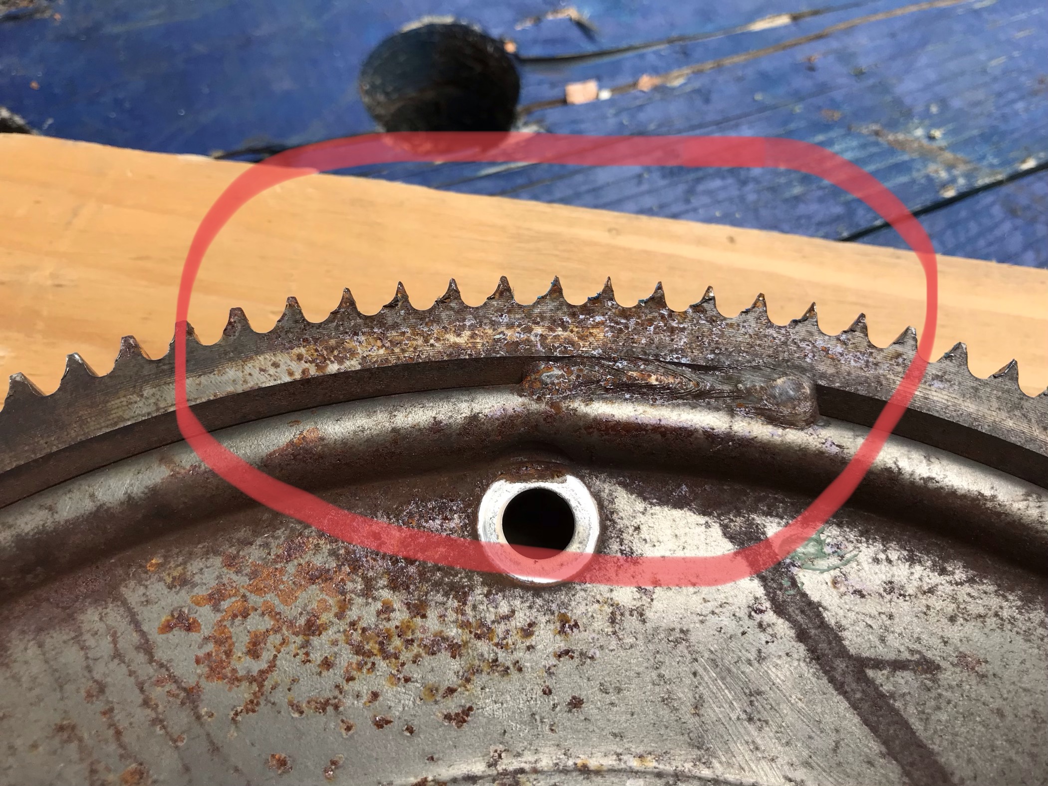

Nope.
There is an explanation & it is inferior metal on this flywheels ring gear. You don't have to take my word for it, but I've been beating my head against the floor, the wall, etc trying to accept any explanation other than the conclusion I have ultimately arrived at and my mind is not being convinced of anything other than inferior liquified metal in the casting process of the ring gear.
When you hit the key, the bendix contacts the worn face of the teeth on the ring gear. It is not dragging on the opposite side of the tooth faces.
As you look at the pictures of the flywheel, that face you can see mounts to/touches the crankshaft. That face you see is the one that spins clockwise, were you able to look at it while it was in motion, fictitious vantage point being from the crank pully.
The circled segment of teeth is where the starter initiates it’s purpose the majority of the time you hit the key. I know most engines like to stop in the same 1 or 2 positions, but maybe these are different being 5 jugs. There are 5 segments of teeth that are in bad shape. The one I pictured is by far the worst so this engine obviously likes to stop at that juncture most of the time.
