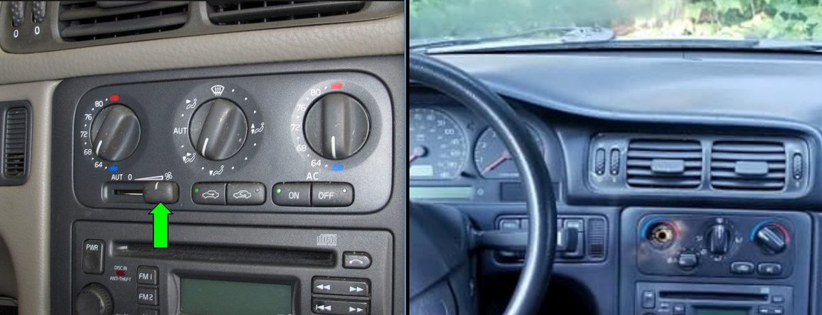

Hi guys. I'm new here. Buying a 99 s70 tomorrow for $500. Got 180k miles. Needs a lot of work but in mint cond. Even seats look new cause everything was covered and garaged. One thing that is busted on the inside is AC Heat control unit. I went to 4 junk yards and all had them in 98-2000 volvos but the units had sliding fan speed control. Ebay sells dozens of the same (sliding) with 4 buttons. Mine has round knob with 2 buttons. For the life of me I can not find a matching part. I've looked at hundreds of pictures, all show sliding unit. What am I missing here. Picture attached. Mine is on the right side.

The one on the left is ECC (electronic climate control) and the right is MCC (manual). The manual one is cable operated, and comes in the base models. They aren't too common, which is why you aren't seeing many (if any) of them.
If you're searching on eBay, try to add "MCC" or "manual climate control" to your search. Someone on this site may even have one for you. Unfortunately I don't have on sitting on the shelf currently.

You should be able to find this using the part number

Part number 9171600
The MCC control unit is available new for about $125 if you search

One of the few parts like that that make sense to buy new! I'd do this if you can't find a cheaper one used.abscate wrote: 28 Oct 2018, 07:36 Part number 9171600
