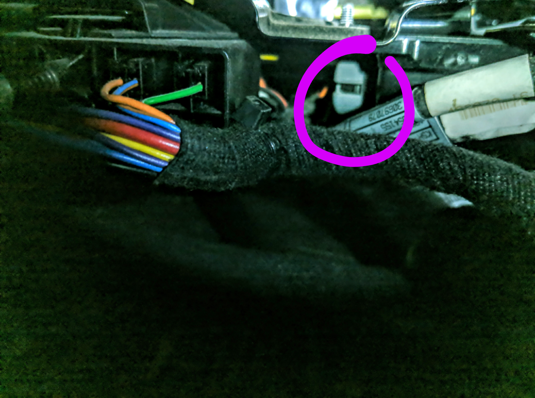

Have the airbag warning on my 07 xc90. did some searching already on this forum, and located all sorts of electrical plugs underneath the passenger seat. I did find one, that was disconnected, so I went ahead and reattached it. Now, I'd like to find out if there's a way to clear the code without a scanner. Thanks for any help.
I'm hoping that connector was the problem. I'm attaching a photo that has the connector I reattached circled. Hard to get a good picture though.

You will need a scanner, VIDA, or dealer to reset that.

Usually airbag trip wires are solid orange; if that's what that is you got your man. The Autel AL-619 does this after an upgrade from the Autel site
