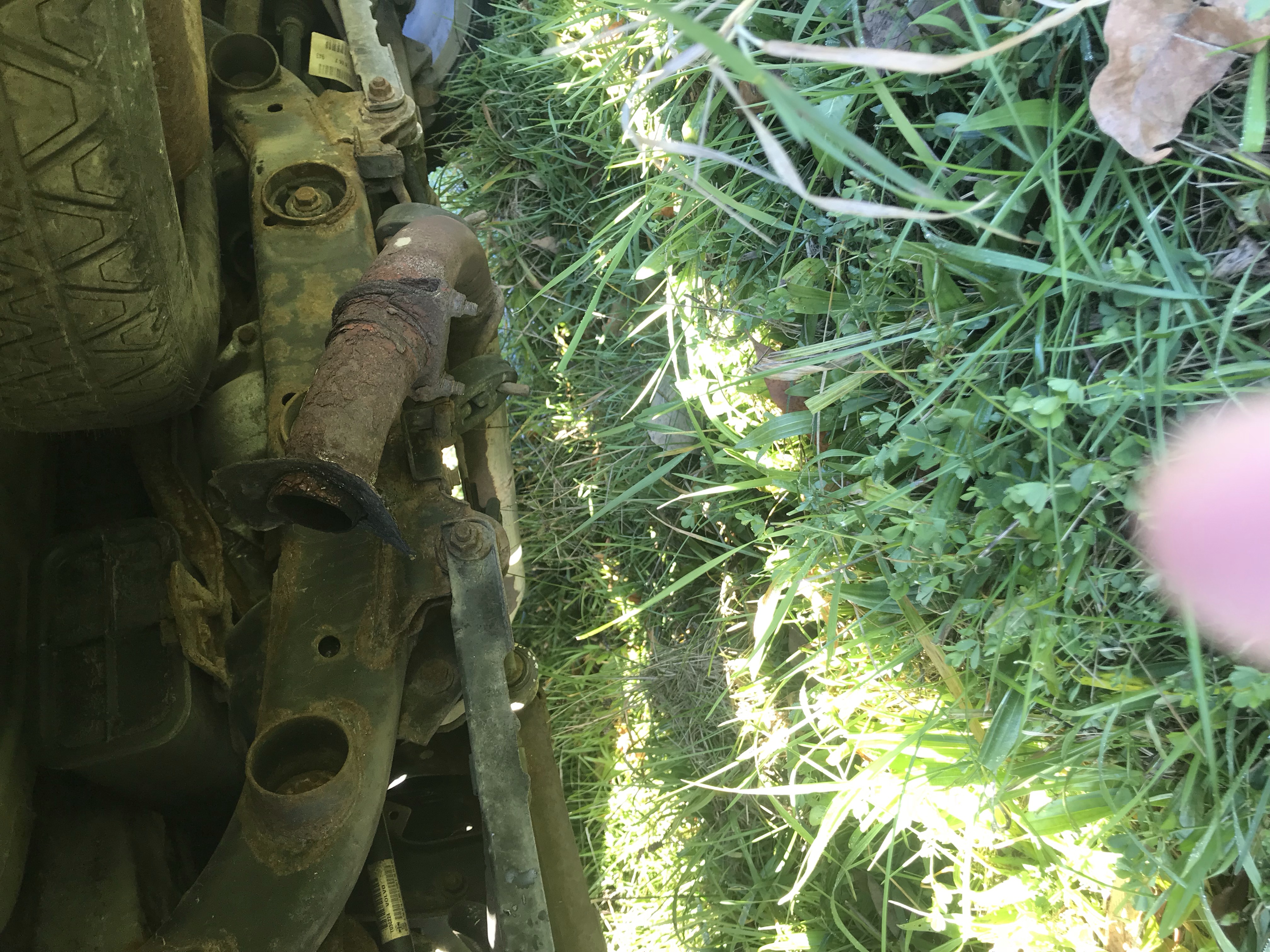

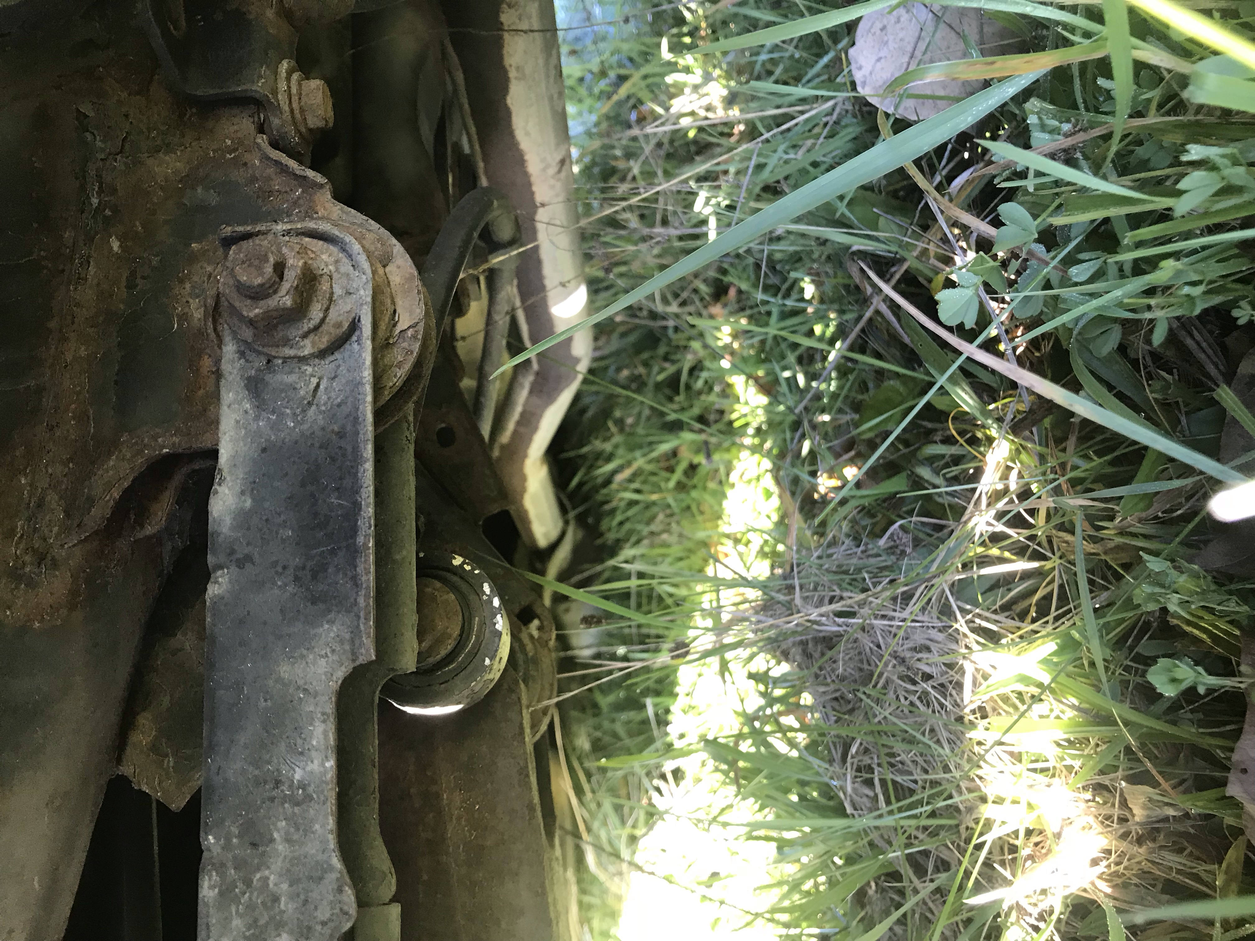

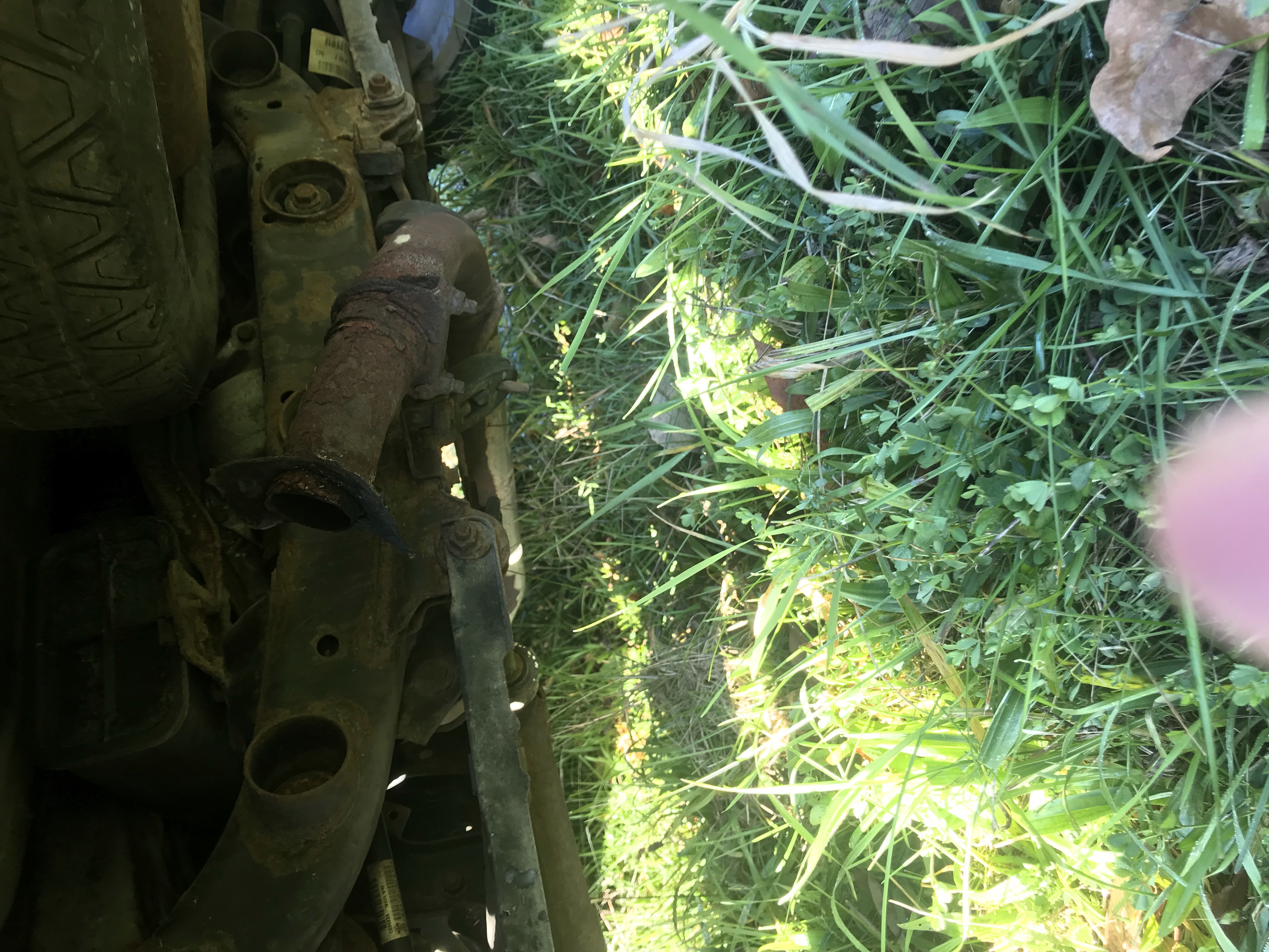

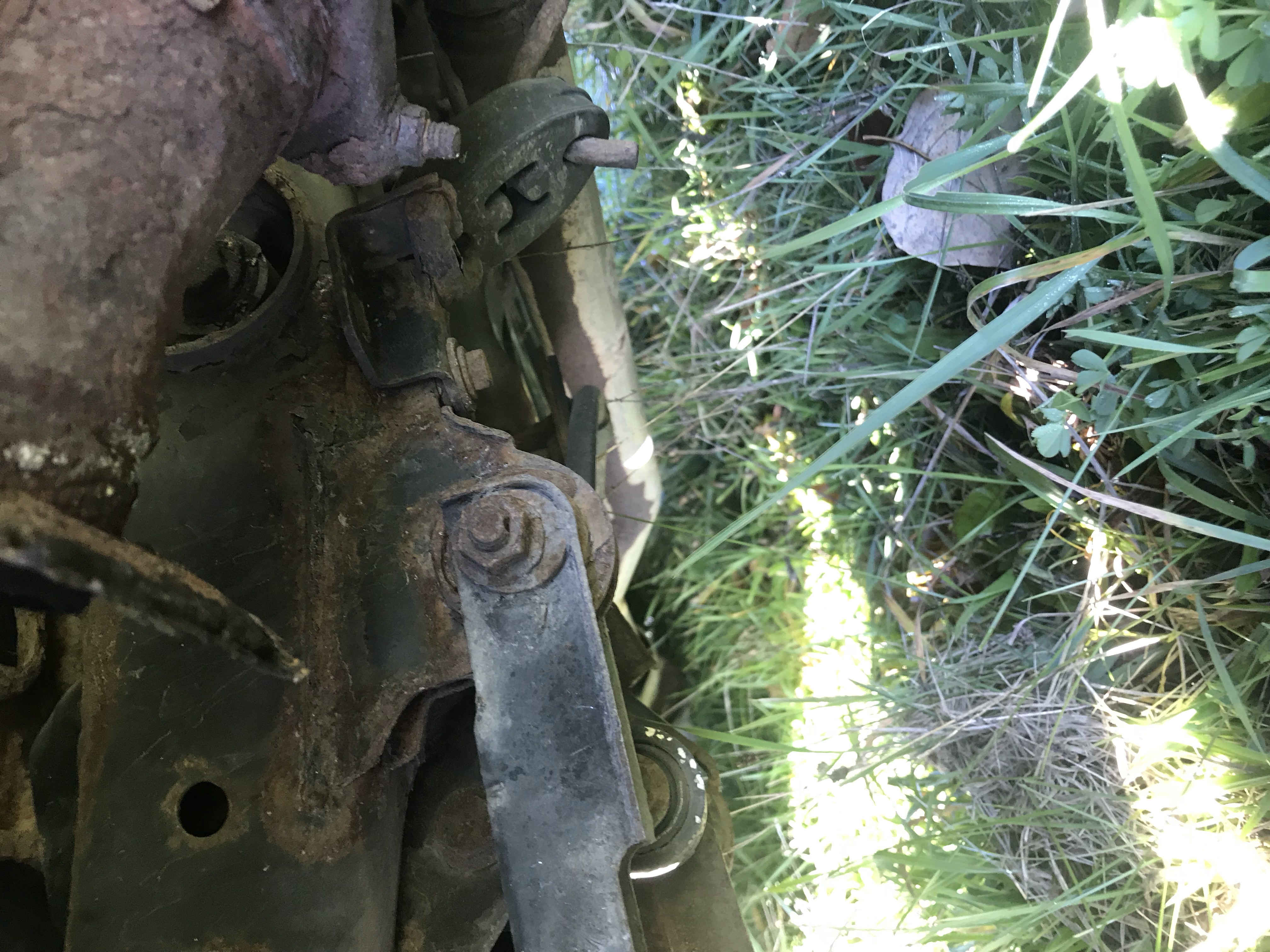

Here are some pictures of what is left. https://imgur.com/a/bDH4rEn Can anybody tell if its Volvo or not? Worth keeping anything that's still there or not? I remember seeing some text stamped on the muffler before I tossed it. Would Volvo have big text on their mufflers under the heat shield?
I'll try and take some better pictures at lunch. Was running into work today and had to rush.

I'm don't feel like this is a genuine Volvo with that U clamp on it

oragex wrote: 30 Oct 2018, 14:55 I'm don't feel like this is a genuine Volvo with that U clamp on it
Thanks. The rear muffler that was on there seemed kinda big. Maybe too big to put a heat shield over and still fit. I'm wondering if the front part is Volvo? I should take some pictures of that section.
