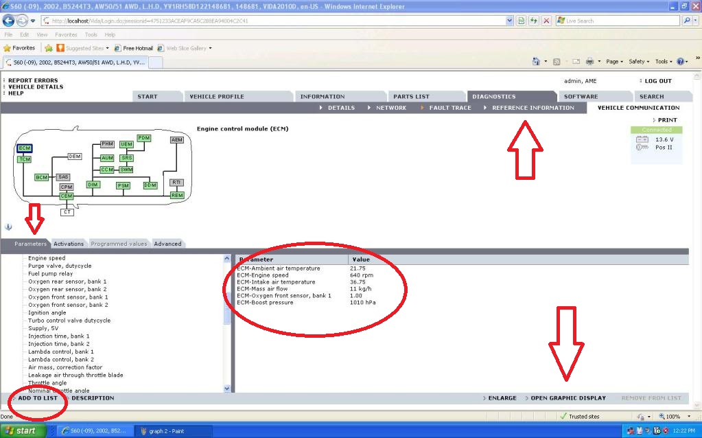

Using the VIDA DIce I got VMware to commincate with my 2007 XC70 yesterday. All I could read were DTCs.
Can anyone please define how to get engine monitoring diagrams operational such as AFR and Mass Air flow rate? Is it under the Diagnostics tab or is it a different VMware tool?

I was able to get the graph working
Another hint is you need to click on the Module in order to view the preferences.
