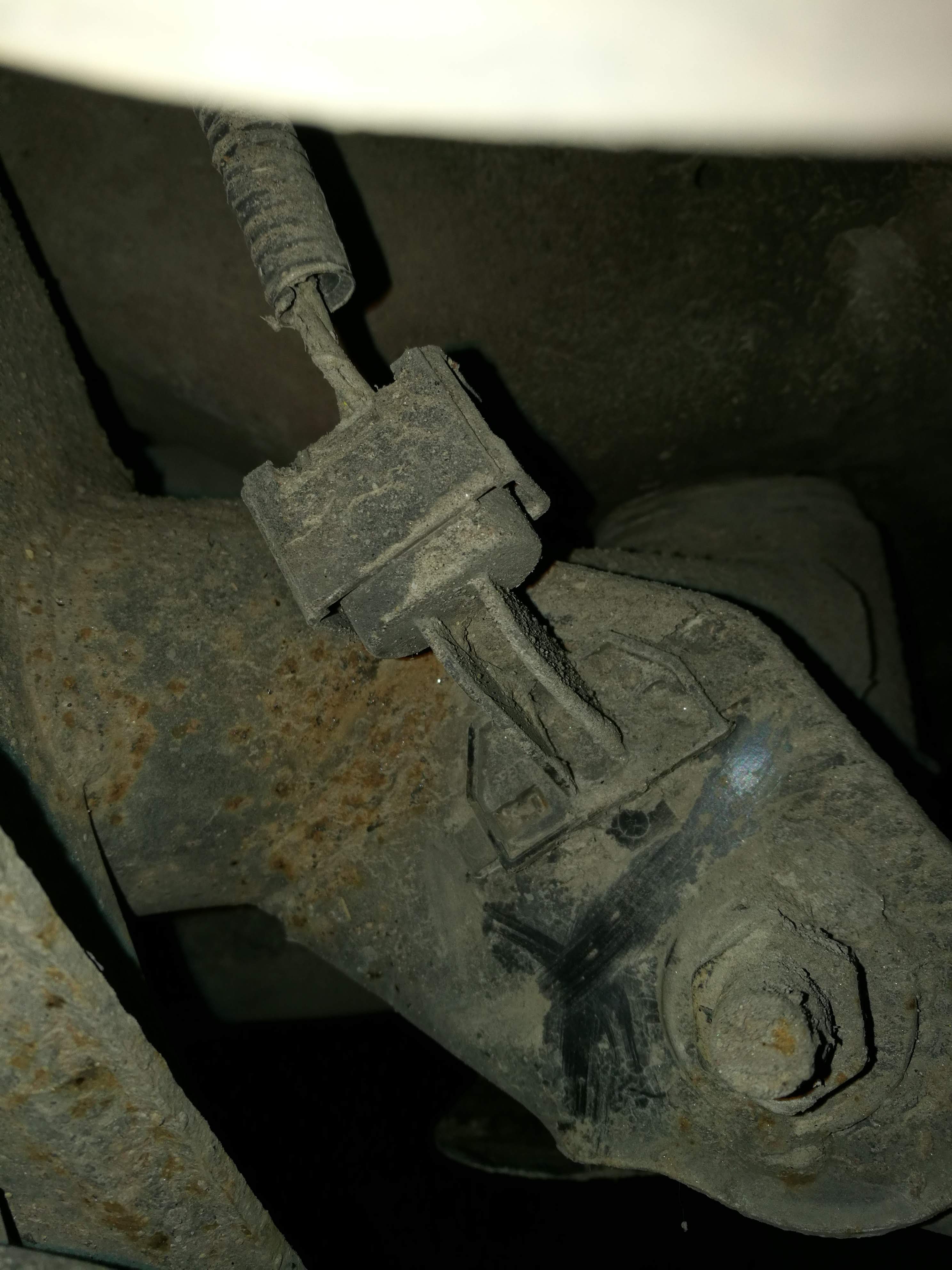

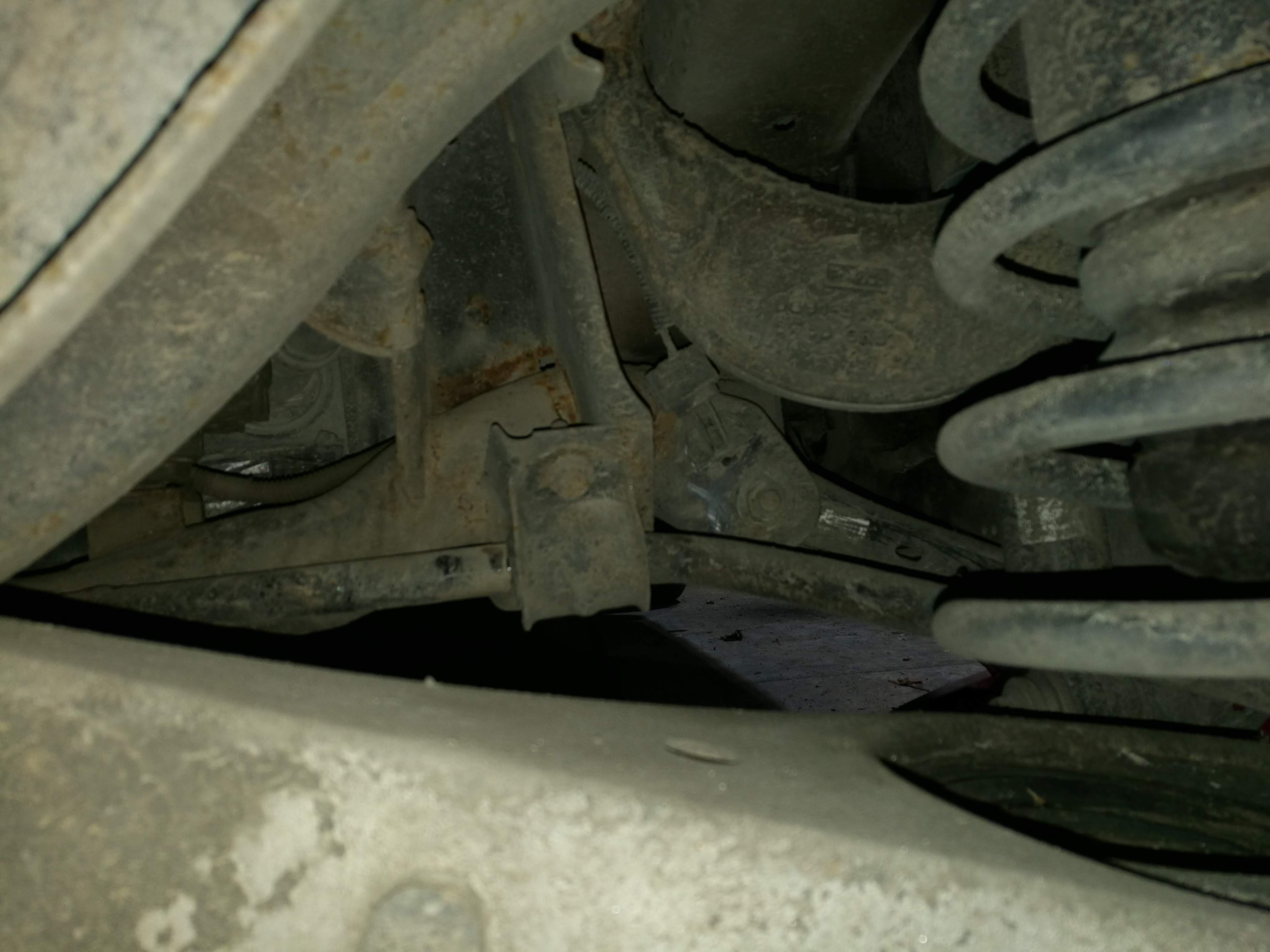

Hi,
I lifted up car and carefully checked if there any cracks or damages. Also checked tires and wheels again, didn't see any problems. No problems...
I were wondering, is my car equipped with some brake pressure sensor for the reason if there load in the trunk, than rear brakes are braking more? Maybe this sensor is faulty? Do anybody knows? Is made the picture of some suspicious item on the axle.
Or anybody have any other ideas?
Thank you!
Thank you!
