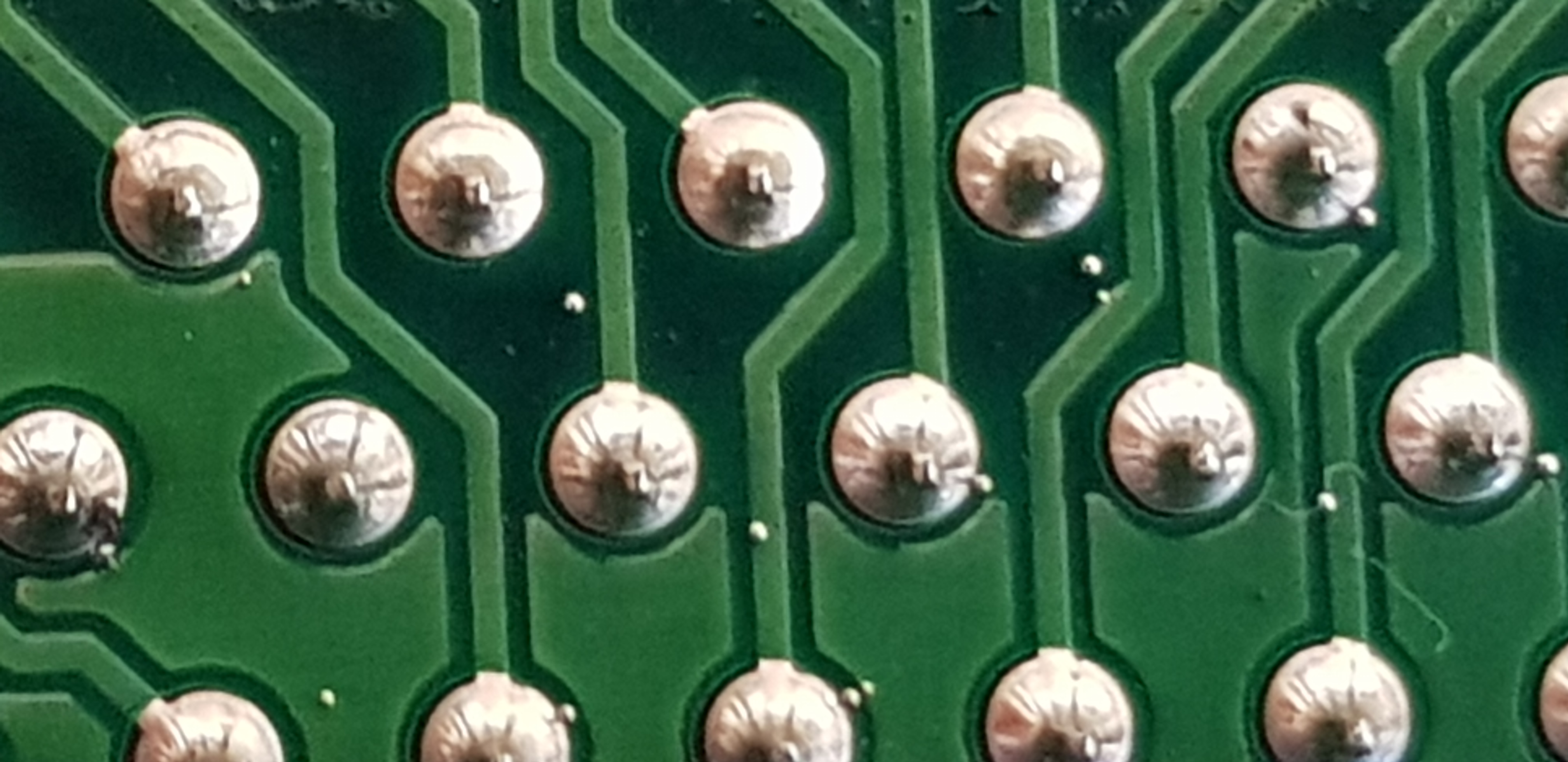

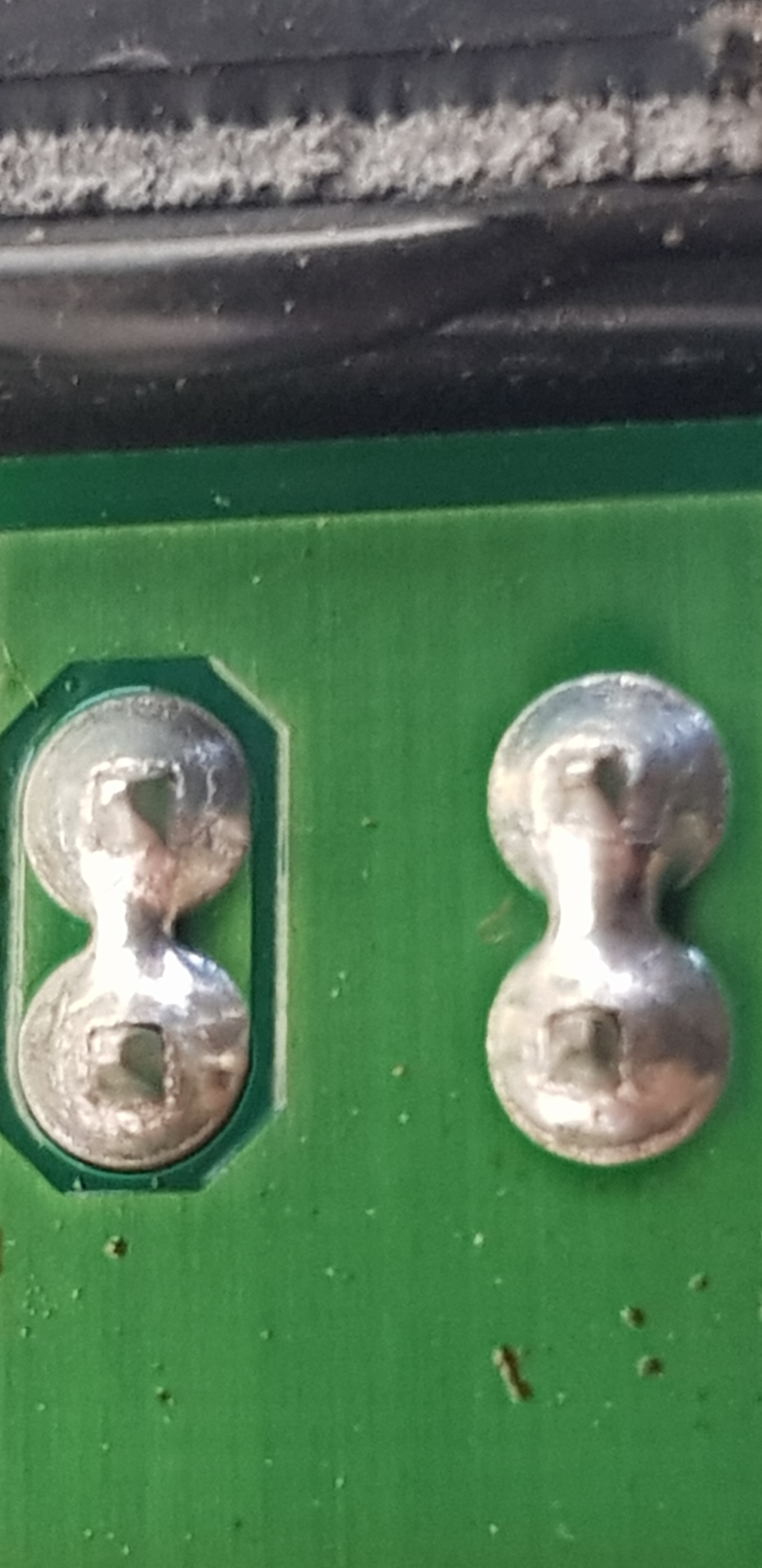

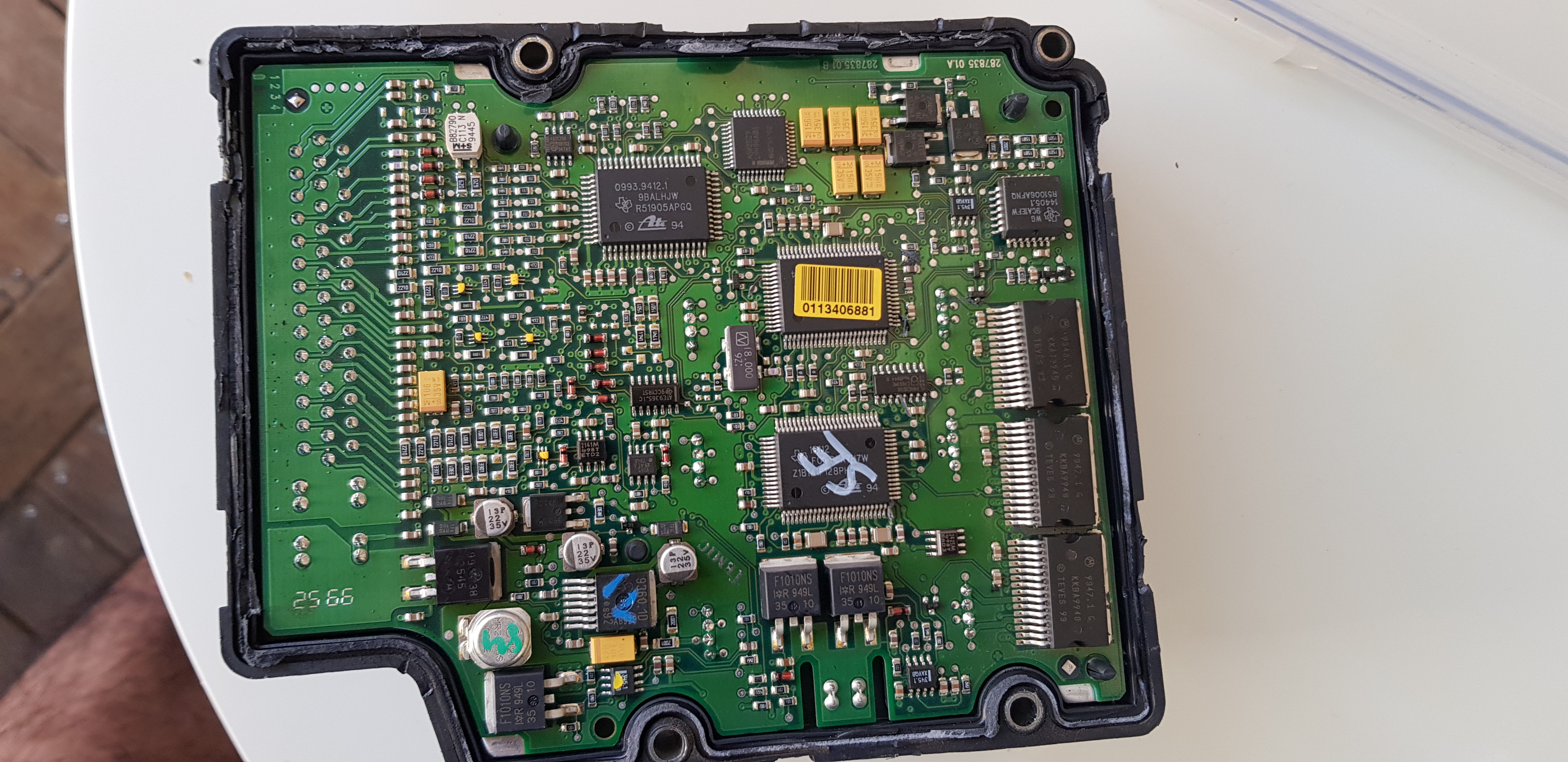

Just removed my 2001 T5 DSTC brake controller (ABS unit) and photographed the connector solder joints and the solder joints leading to the ABS pump.
They definitely need a touch-up.
I'm having DSTC Service Required, ABS brake failure and Brake System Failure especially on warmer days after the engine bay has accumulated some heat.

Here's how most of the joints look after desoldering and retouching them. The rough look is the flux that hasn't all been scraped away. These 2001 DSTC units don't have that rubber coating over the connector pins like the earlier units making it easier to rework them.

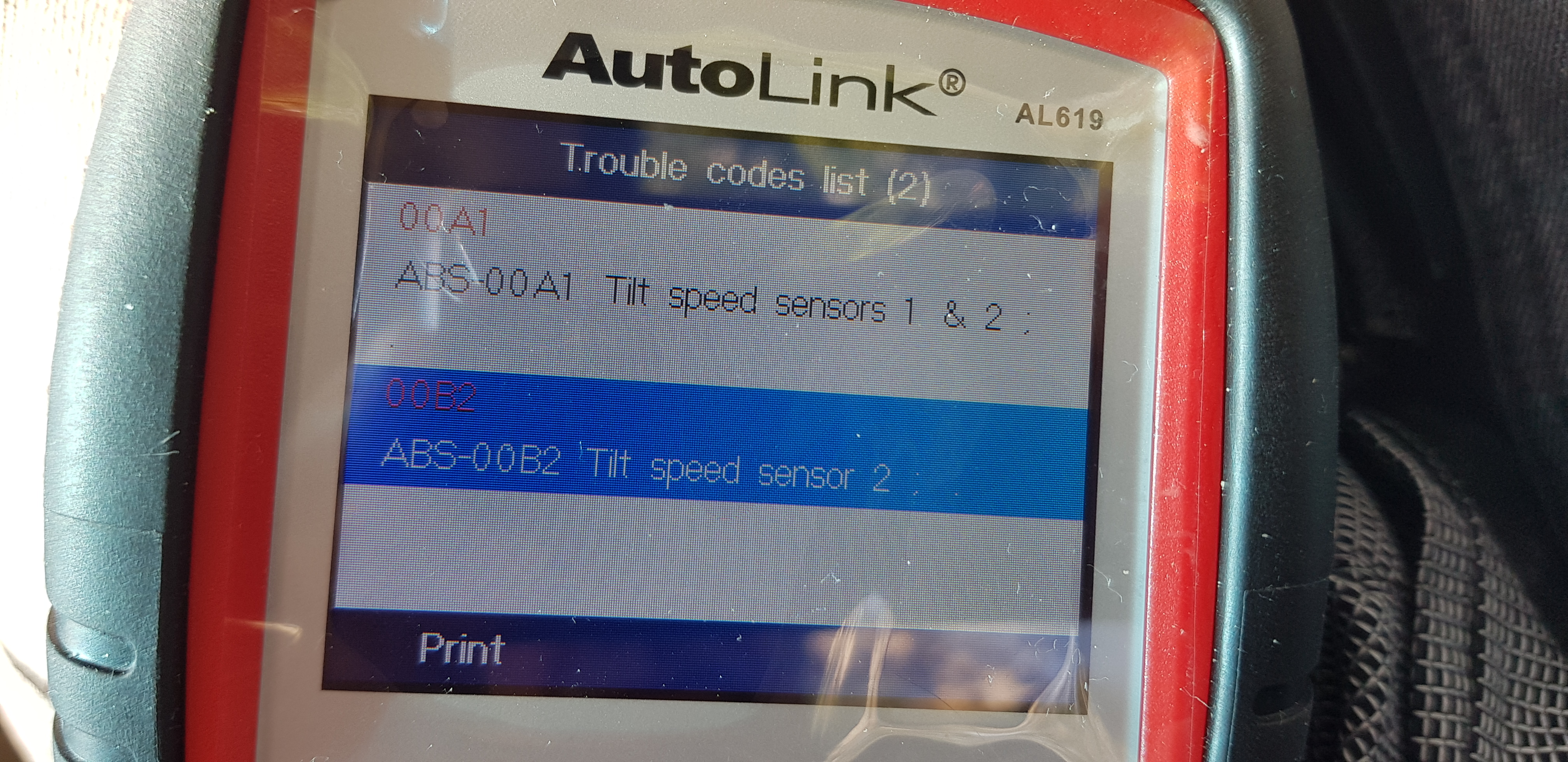

After 1.5hrs behind the wheel today (travelled to Geelong so mostly high speed freeway and tollway) a much better result with DSTC Service Required entertaining me on the dash display. It was quite a warm day though and the ABS Service Required message occurs mostly when stopped in traffic with minimal airflow under the Hoonett (hood and bonnet Anglo Americanised)
No Brake Sytem Failure or ABS Service Required.
A scan showed that the rear wheel sensor, front left wheel sensor and ABS Pump faults are gone for now.
Scanned and produced the following codes so the Yaw sensors in the cabin may have failed or require calibration. Very odd though that it now takes 1.5 hours to get a failure.

Don't know about these modules, but the solder joints may not be the only weak point (we can clearly see them cracked in the zoomed in pic).
I brought my (infamous) 2003 DIM circuit board to a very nice tv shop repair, was asking them to reflow the chips on the board. The guy there was really great and told me he was actually going to check the whole board, not just the motorola chips (and took only $70 for the repair, sweet). Turns out several smd tiny resistors were also giving up after being powered for a while. Basically when these tiny resistors approach the end of life, they start failing after a few minutes/hours of power up, then come back again to life after resting (power off) for a while.

Never heard of a resistor that "powers off" SMD is merely a surface mount pad on the base of the resistor or other device for attachment purposes.
It is more likely a need to reflow the solder pad under the SMD that has repairers confused; thinking that the device has failed, unless it's a CMOS device which is much more complex and will break down when faulty in a heated environment. It's easier in most cases to just replace the device than to clean it off and re-solder.
I'm not a big fan of re-flowing CMOS devices with an iron though as they are not heat tolerant, though a hot air blower under the board approaches similar temperatures as the production process. I wish I could hot air blow the entire board just to rule out breakdown of a CMOS device on this board.
