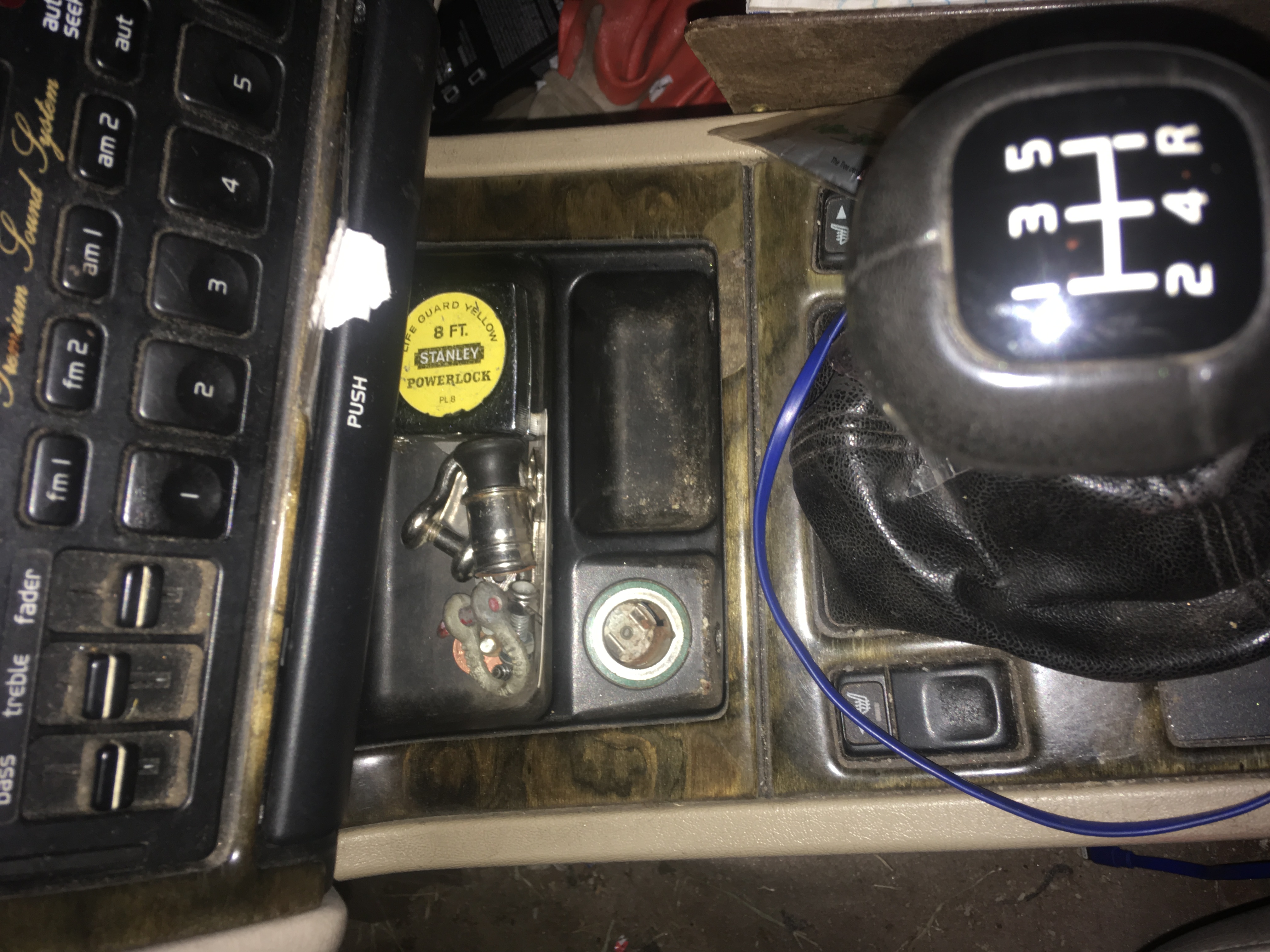

Blackwagon
- Posts: 9
- Joined: 05 Nov 2018, 00:43
- Year and Model: 95 850
- Location: Connecticut
Here ya go...
