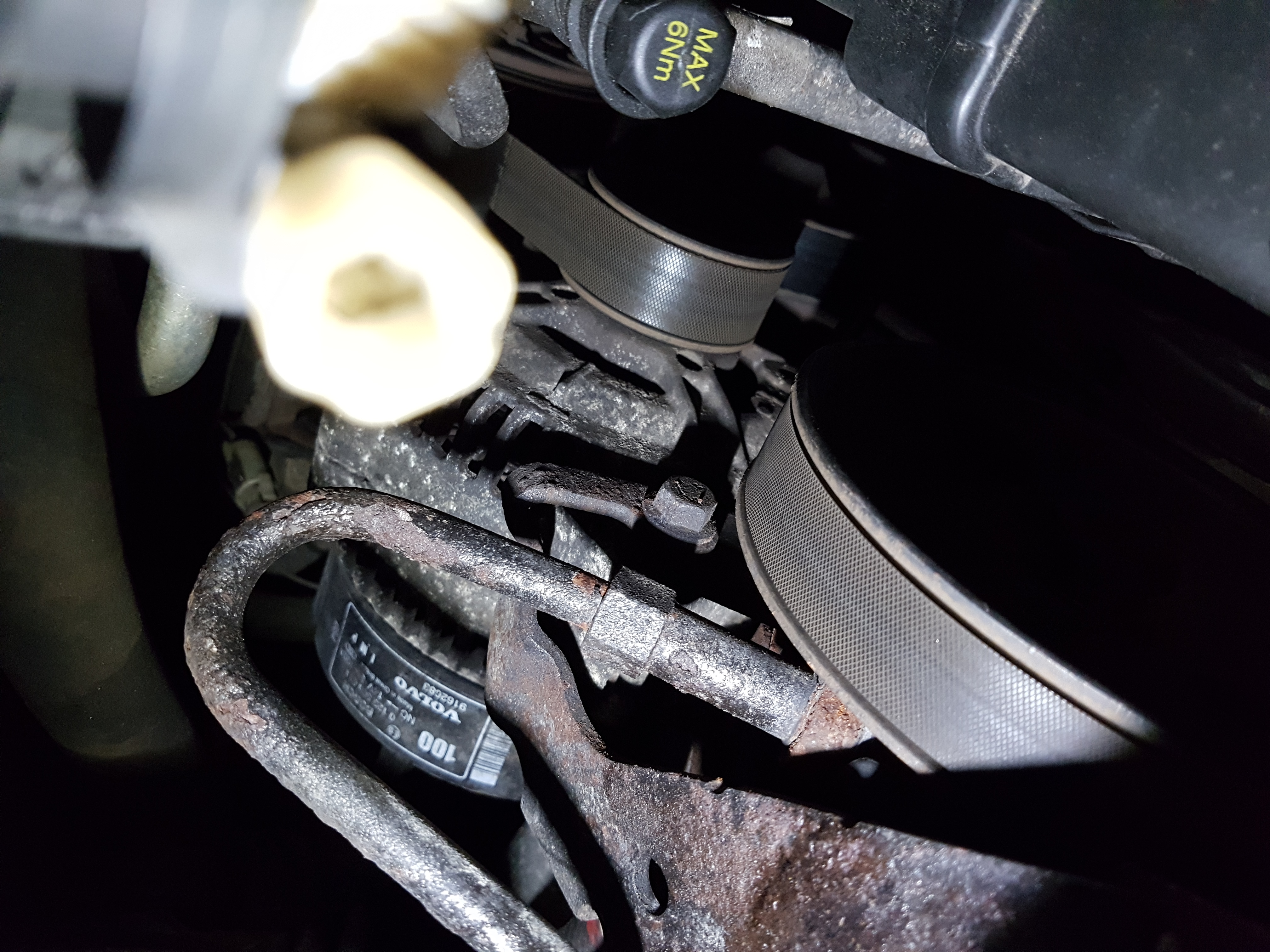

Seems like someone lost the bolt... can you tell me what I need to put in there? (the bracket between the PS pump and the alternator)
(1995 850 T5-R automatic)

Nope, it's the same as the other site I think. Can't see the bolt on the link :|

Well it's no big deal since it worked until now... Just wanted to know what it looks like, probabyl can use any bolt that fits...

Looks quite like a regular bolt to me

VIDA says it's M8x80
