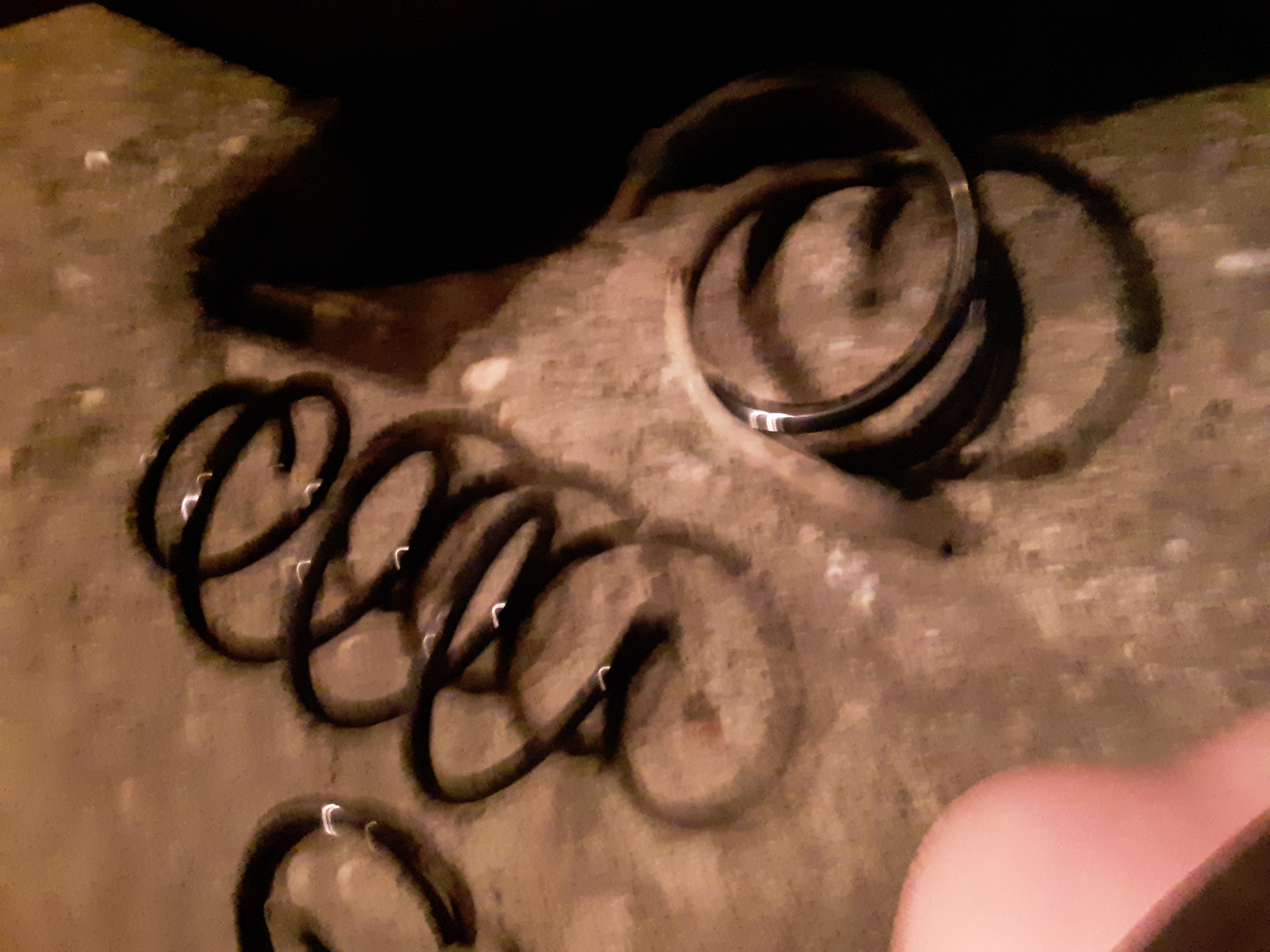

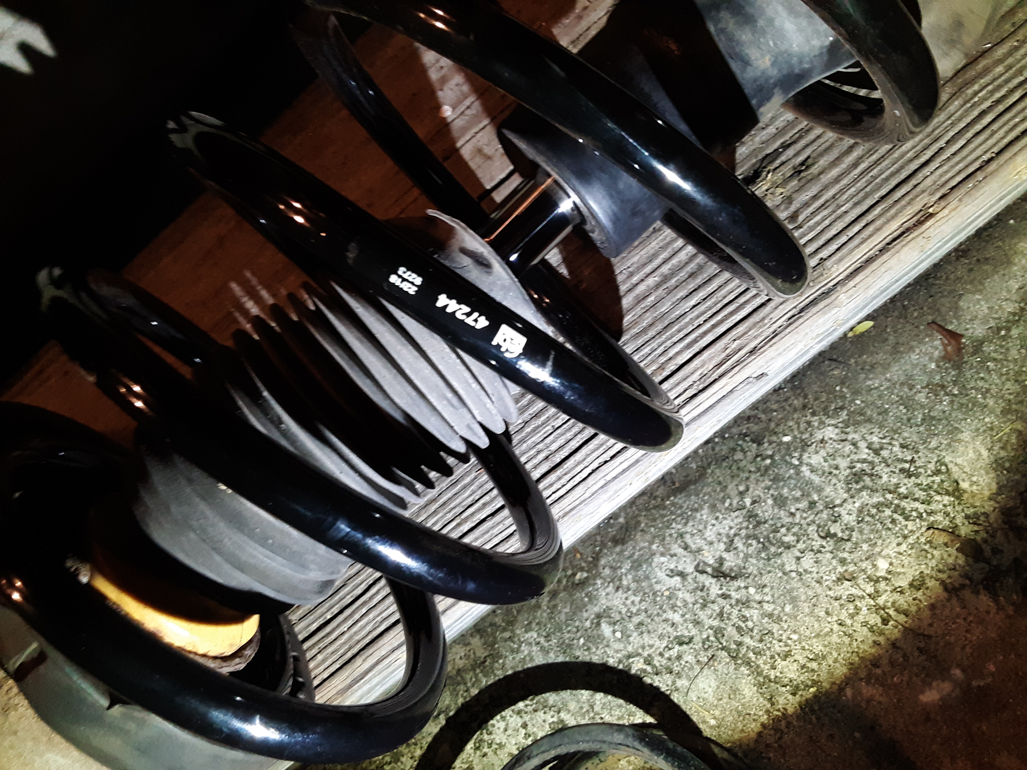

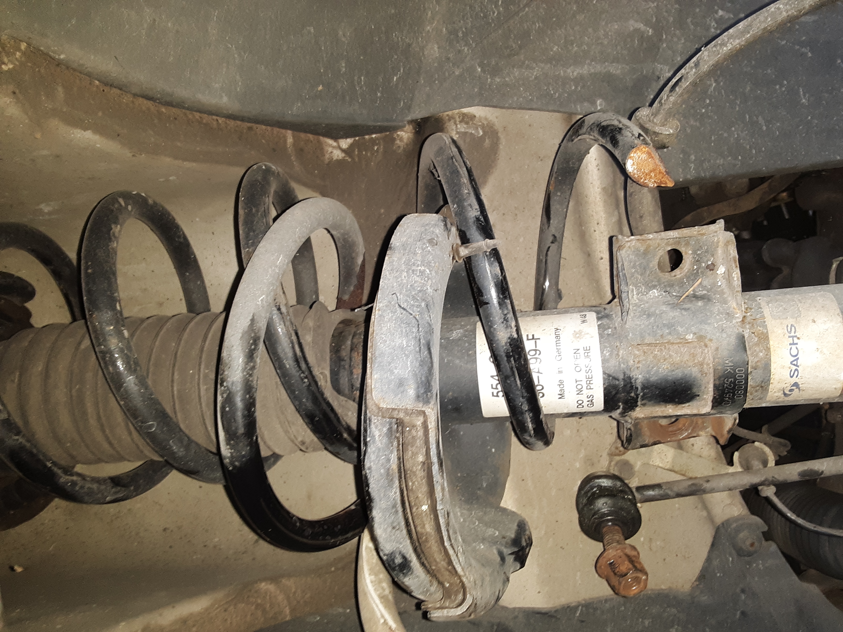

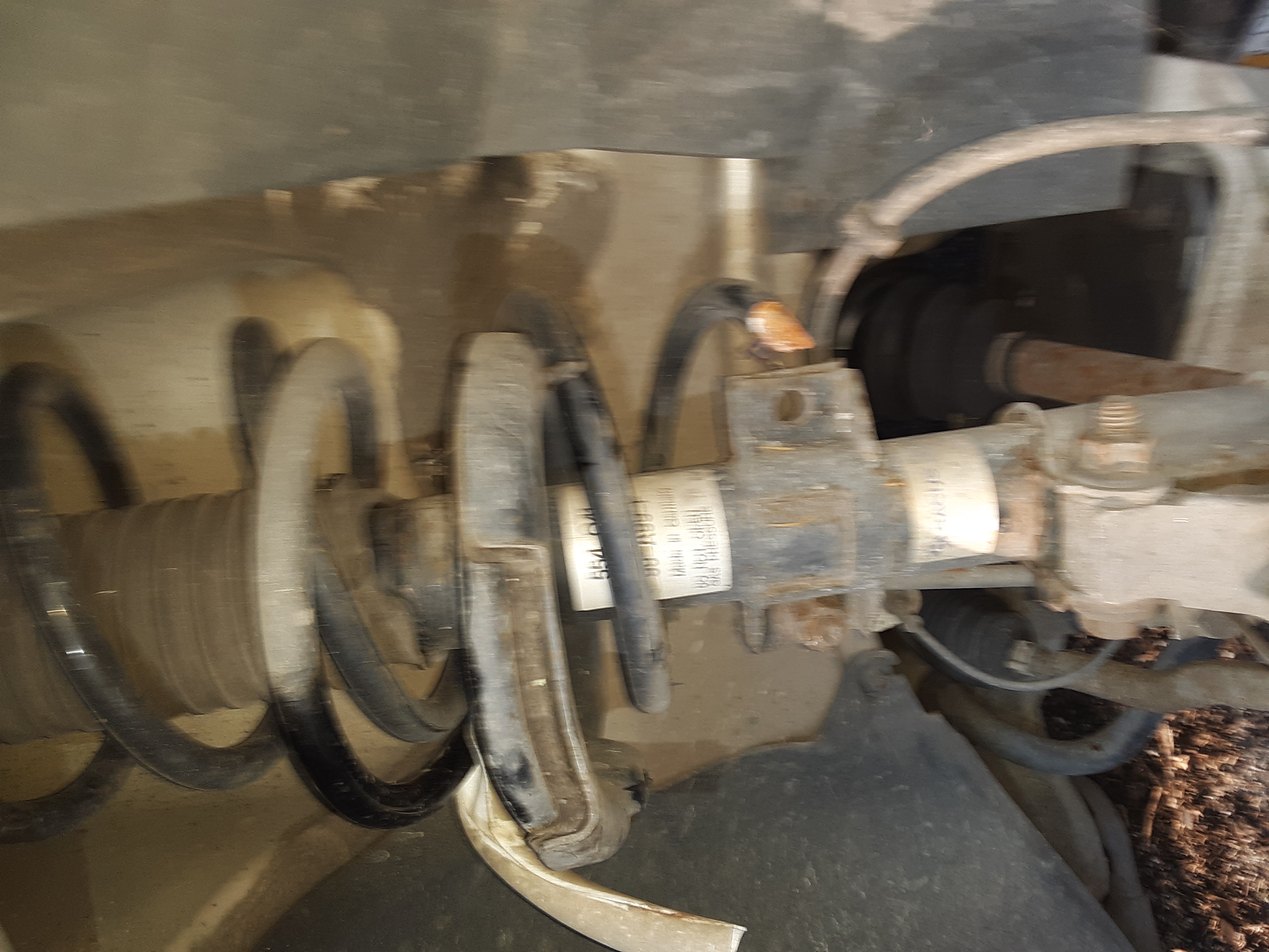

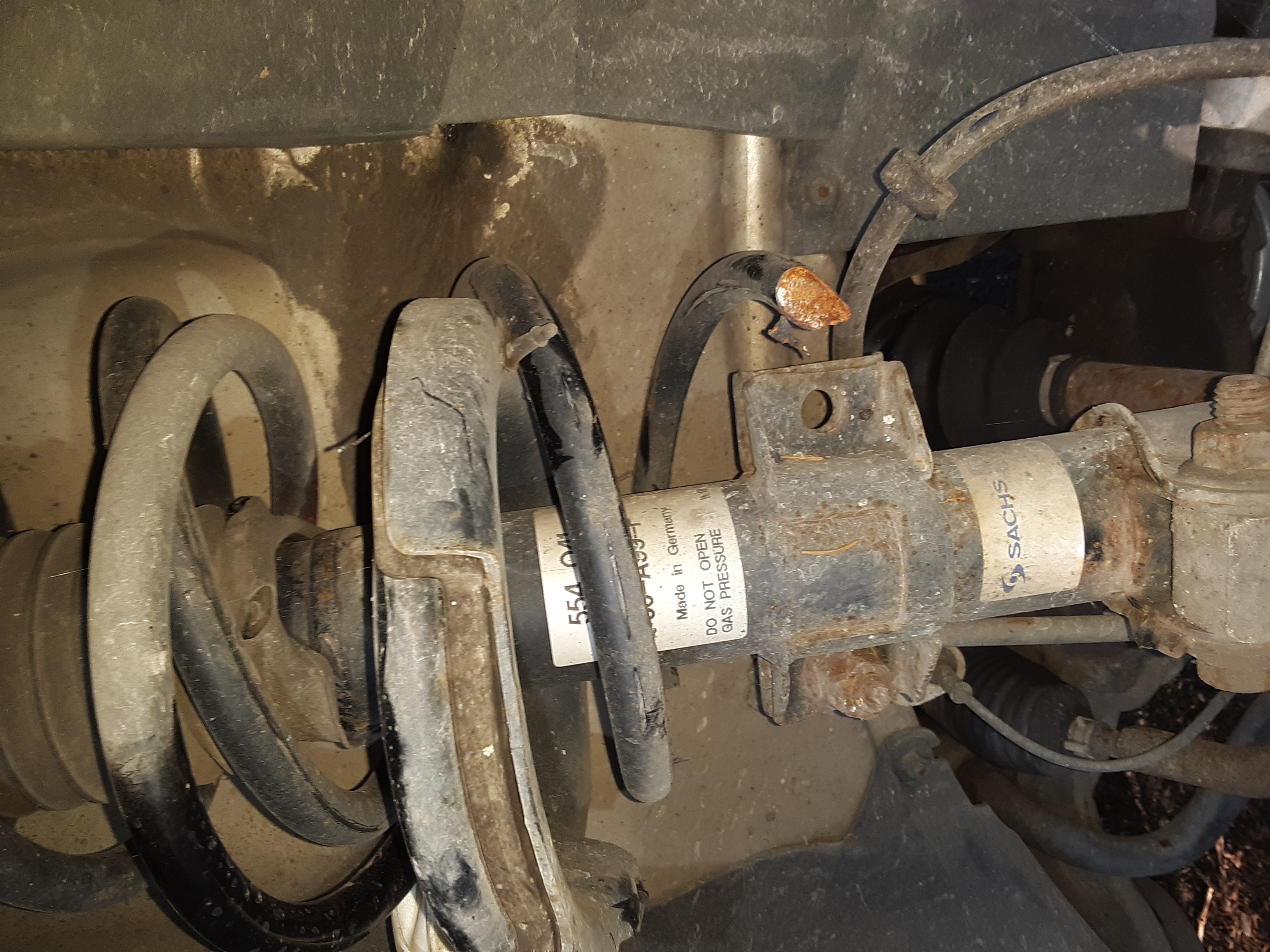

So a month ago a pcv system coolant line split at the clamping location. I had it towed home to repair because it required removal of airbox, MAF to Turbo tube, upper engine torque mount, upper strut brace. Somehow this broke the F/R Macpherson strut spring, dont ask me how and I'd like to add that springs were replaced when I replaced shocks, strut mounts, spring seats and hardware 2 years ago. I purchased from FCPEURO.COM so there warranted for life but damn. I've attached pics...even after removing piston nut and cross nut I couldn't remove spring from strut because the spring somehow wrapped itself around lower portion of strut piston body. I had to cut spring off in pieces.

They were factory springs that I purchased from fcp not even 2 years ago. I bought new Sachs struts, strut mounts and everything else all factory or better. The driver side broke not even a year after replacement. It was towed, not worked on by a shop.
