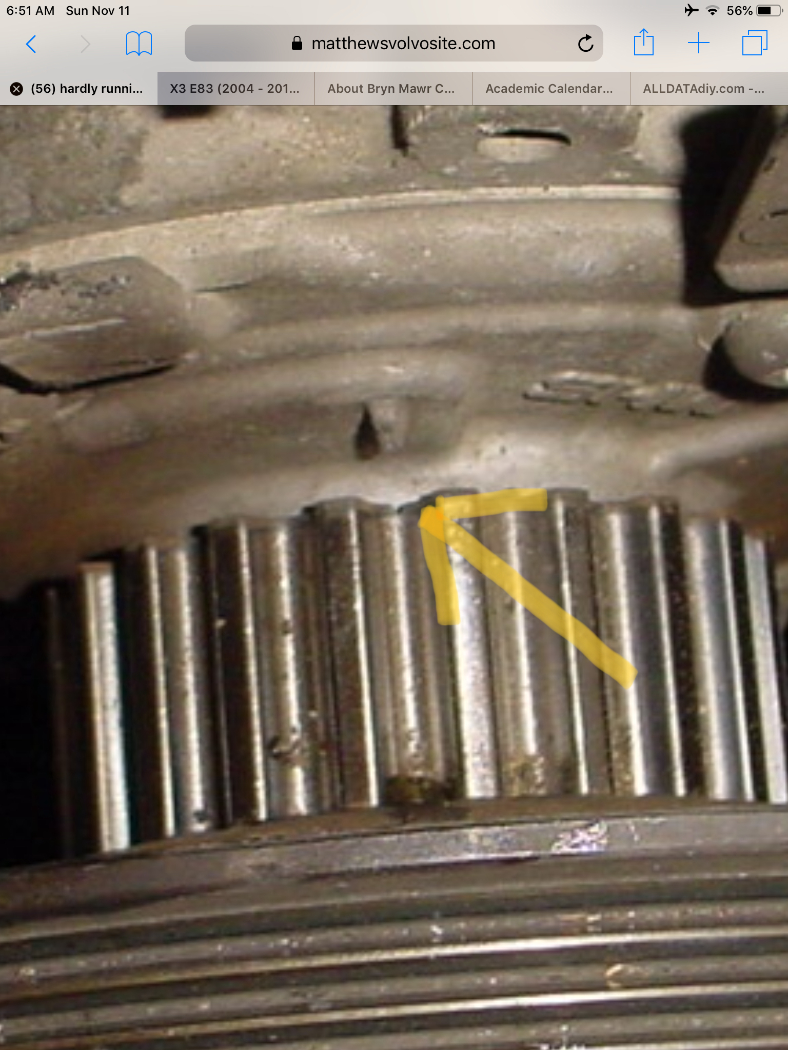

Reminder, these Marks are not Top Dead center ( TDC)
Credit Ozarklee
P80 crankshaft timing mark photos

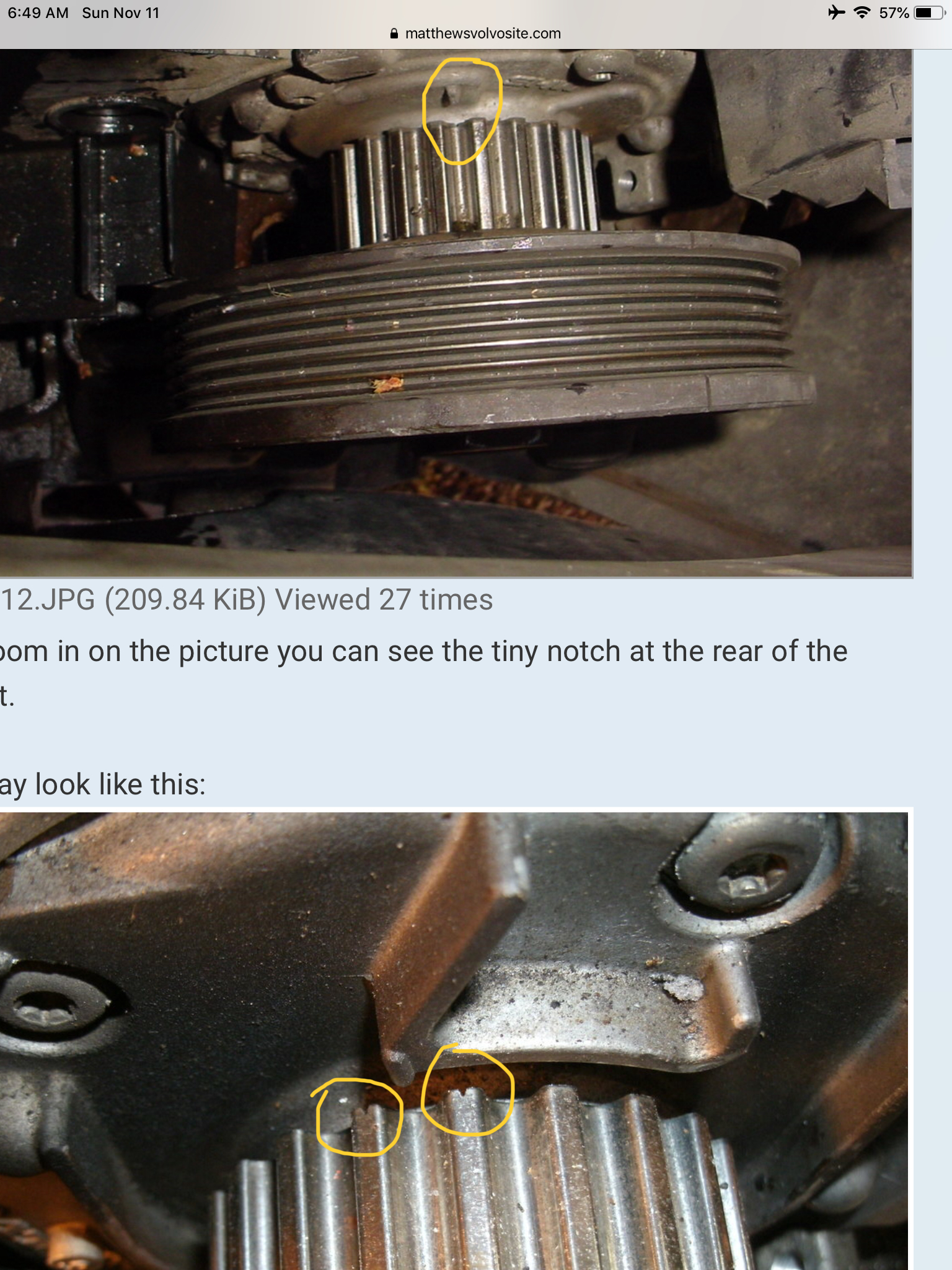

It's a common misconception with these engines that they need to be at TDC. Not how it works on these!
I've never seen the old style with that tiny notch, only the newer, easy-to-see marks.
