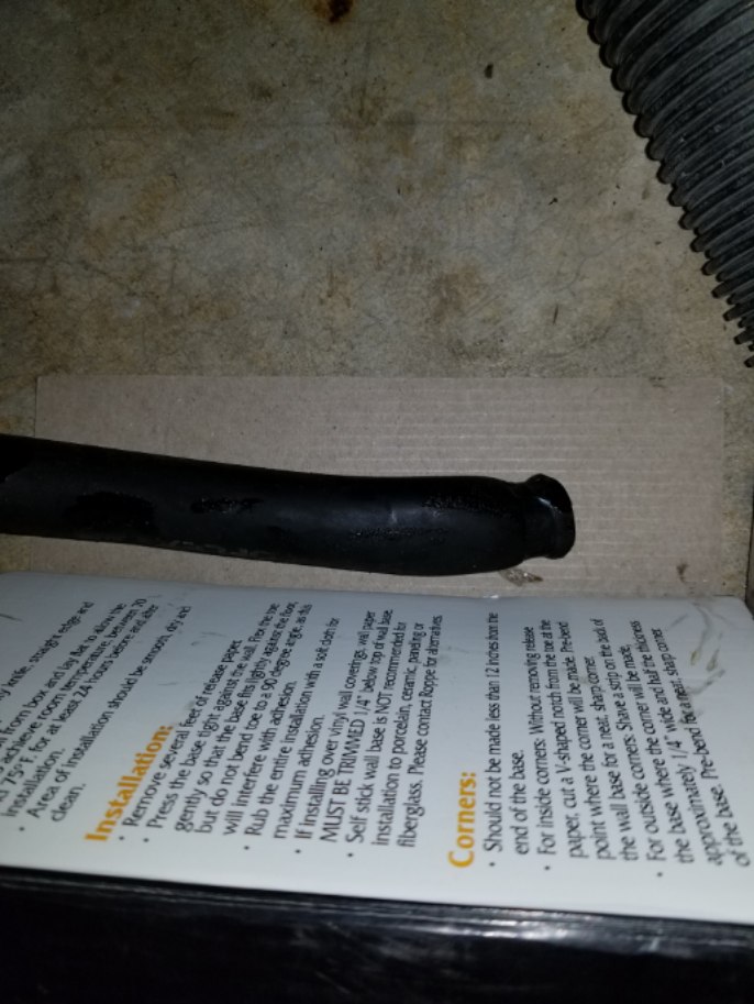

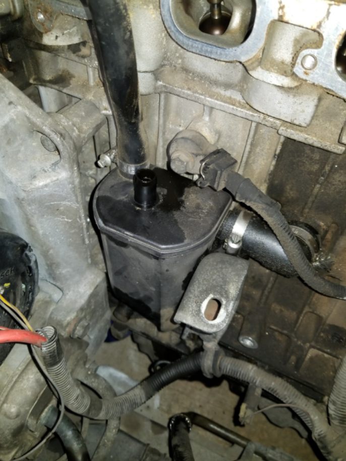

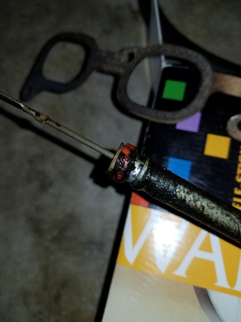

#1 RSPI is 100% correct. Never use that soft hose that IPD sends you. My pcv got clogged again and this hose had swollen up with oil and then actually got clogged shut because of the swelling. This is what caused my dipstick missile! Argh! Well learning costs money right?

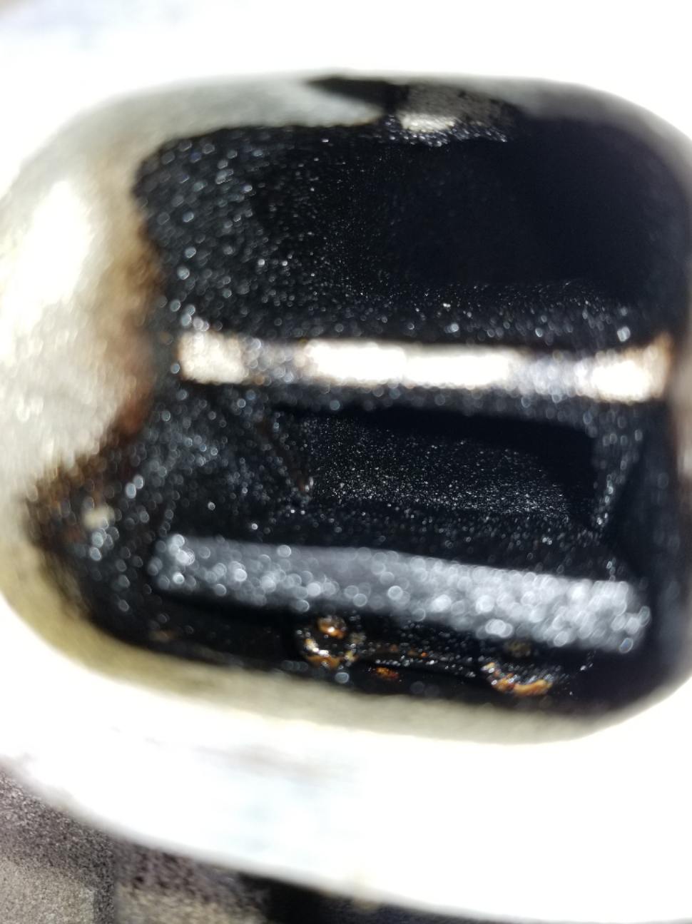

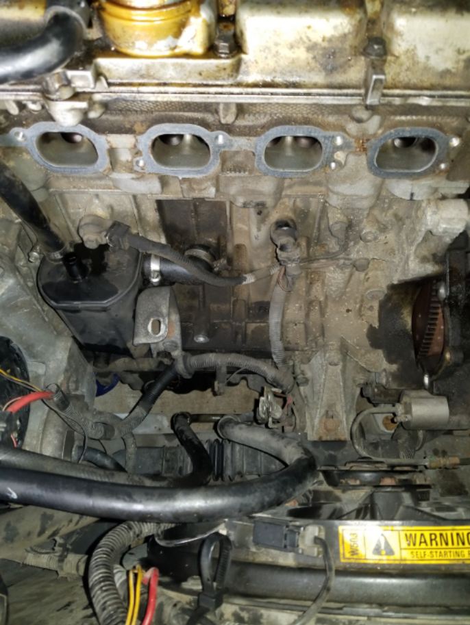

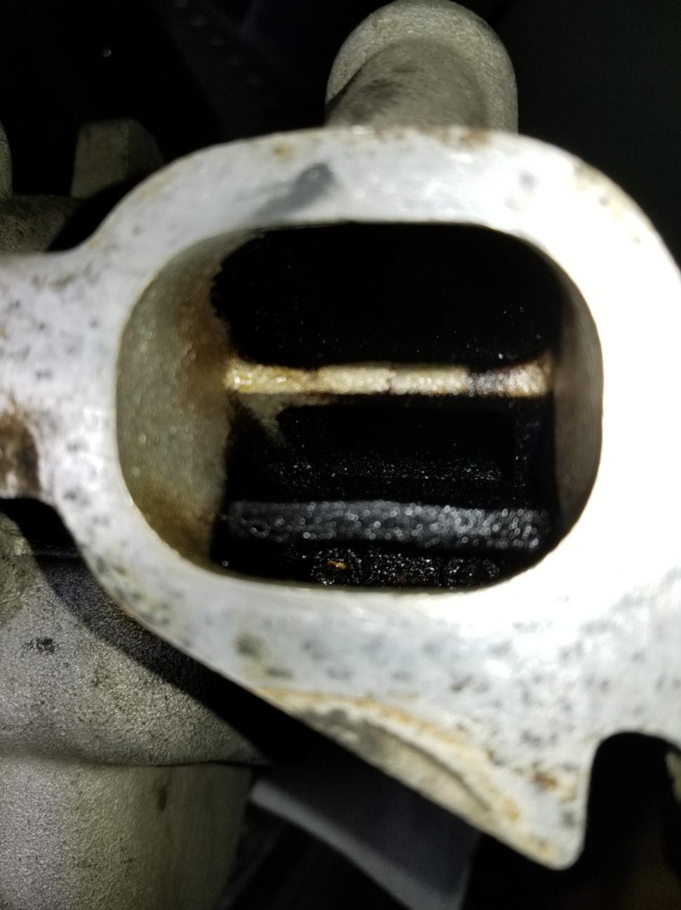

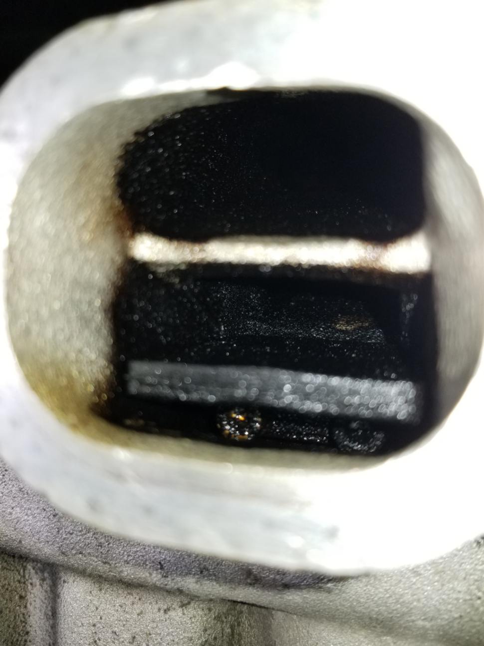

#2 I have attached pictures of my intake manifold, it was never this dirty before my last PCV job. Obviously this is oil lining the manifold. Should I be concerned about this level of oil build up? Maybe 20k miles of driving. Or is this just evidence of the pcv doing its job?

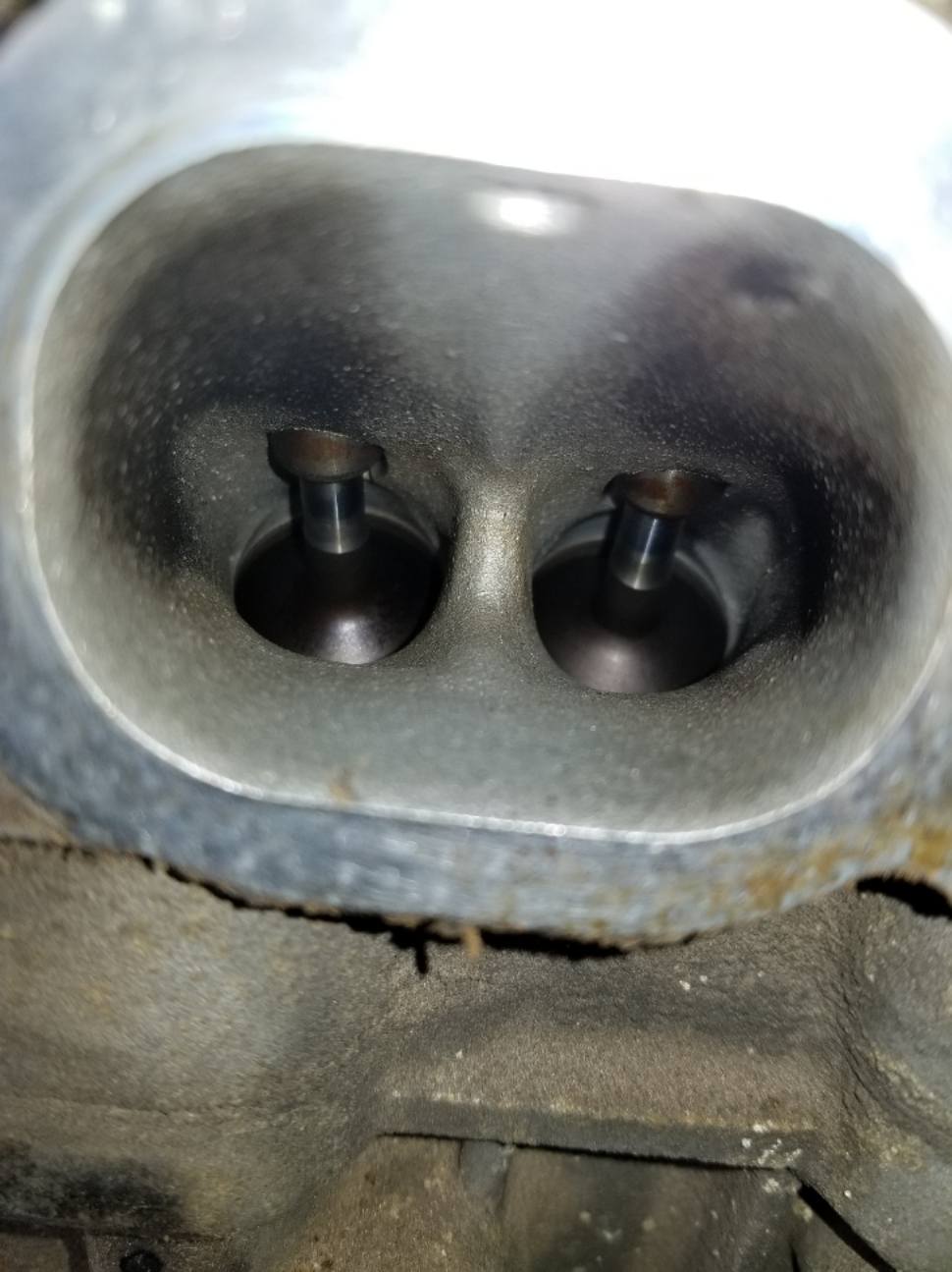

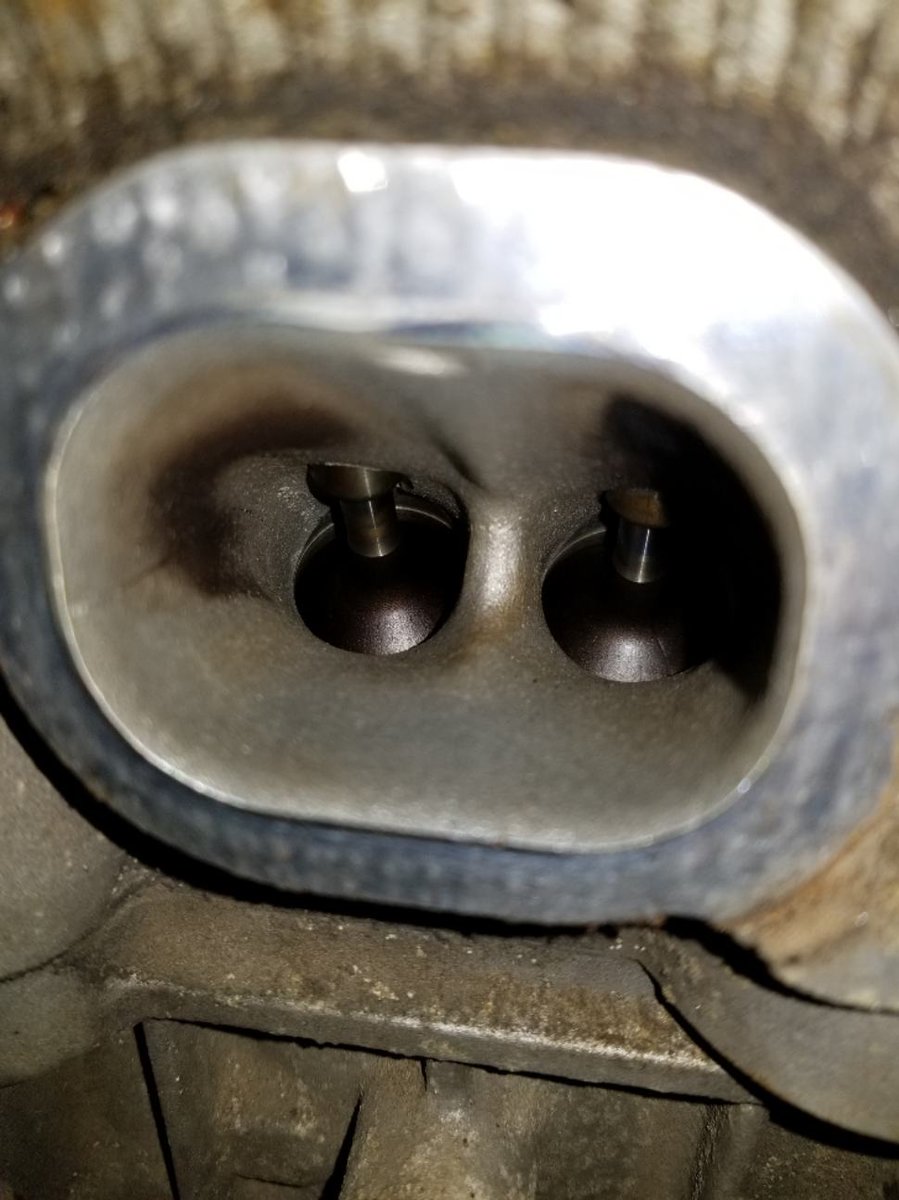

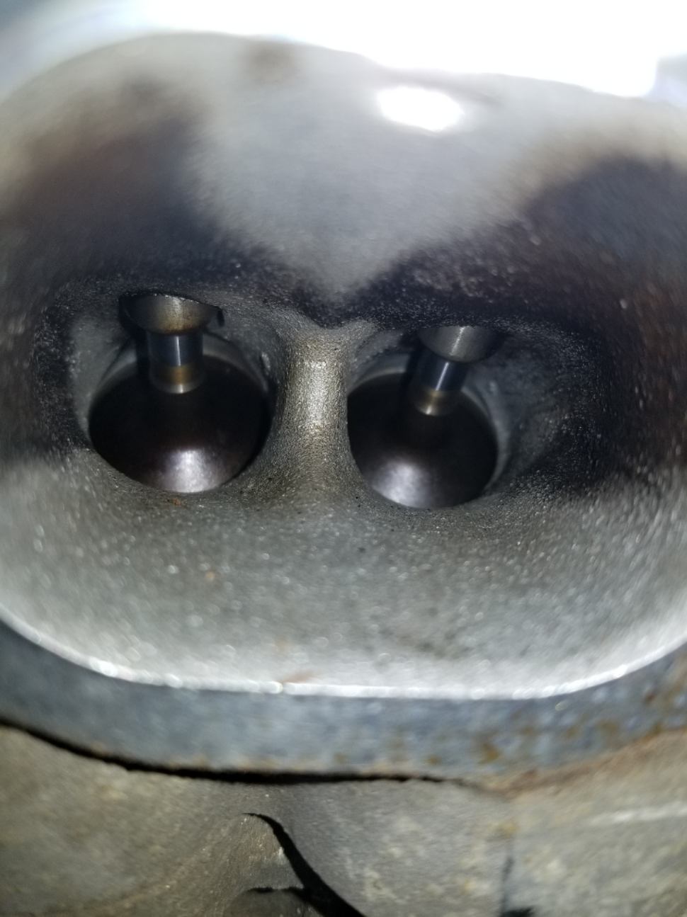

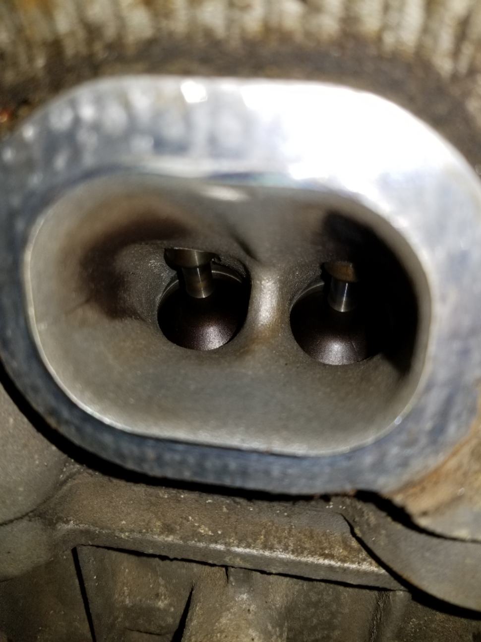

#3 I have also attached photos of my intake valves. Car has been sitting about a week. I don't really see much oil leaking down the intake valves. Pics are of the dirtiest valves/valve seats. Should I plan on rebuilding the valve stem seals still? I was going to preventatively rebuild the head bc of my oil consumption, but I'm not thinking it's probably not the valve stem seals. I'll need to do a compression test next I think.

#2 That level of oil in the intake manifold is common, even in a non-turbo engine.
#3 I'm not sure you will ever see the oil from leaking valve stem seals, unless they have catastrophically failed. A better test is to look for a telltale puff of blue at the tail pipe upon startup, or when you hit the throttle after letting it idle for 5 minutes. Base the need for valve stem seals on these symptoms. Compression test will also not be helpful in this matter, though I agree it is good to do one and know the status of the engine before you attempt time consuming and/or costly engine repairs.

While you're in there, I would just to the "high-mileage" PCV mod.
I just recently did it on my 192K '97 T5 which had started to puff some smoke while idling in traffic. The previous owner had half-assed a "PCV service" at some point just before I bought it. It kind of passed the "glove test" at the time, but it wasn't great.
Made sure the oil separator and ports into the block were clean, used 5/8" hose to the PTC fitting on the turbo inlet, as well as enlarged the hole slightly on the PTC. Ran 4mm hose from the turbo inlet to the fitting on the PS side of the intake.
No more puffing smoke at idle, or from the dipstick. Passes the glove test with ease.

re #3 - a good check for leaking valve stem seals is the spark plugs. Always inspect them when ever removed.

Good to know about the oil in the manifold. I had a moment of panic, and then it subsided.
the info on valve stems is good to know. My 96 puffed smoke. I kept trying to give it a nicotine patch and it wasn't interested (ba-dum-bum haha.)
Chuck: I actually did this this time around, 5/8" heater hose from the oil trap to the intake manifold. It's night and day between a well running pcv and a clogged one.
Herman: Good point on the old sparkies. Mine are covered in black carbon. Either its time for new ones or I'm running a bit too rich. Should have taken pics, but I neglected to due it it being unreasonably cold here in missouri for mid-november!

The classic test , I thought, for valve guide leakage is descending a long hill in overrun, car driving the engine, then tromping on the pedal at the bottom.
I once did this on Route 79 west of ITHACA and I smoked out the entire route from the “ Octopus” intersection to route 13 with oil smoke, almost causing an 18 Volvo car wreck.
