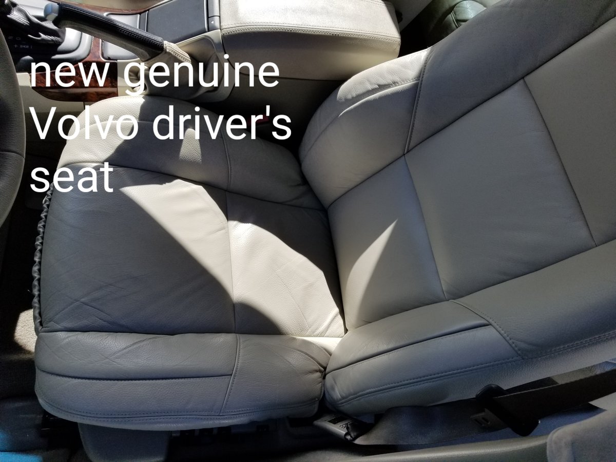

This year my driver side leather seat skins were replaced due to being torn. My leather looked great all these years using Armor All. Well the new genuine Volvo skins are softer than the rest which are 15 years old. Lexol is crap as well as everything sold in stores for leather as far as my hardening seats testified...

So today I have now applied the leather oil for the third time. The leather absorbs it like a dry sponge. The old leather is becoming amazingly supple. While the leather is wet with the product it looks scary with all sorts of dark cracks. Then when I come back later and it has been absorbed the leather looks great with a matte finish. The new leather driver seat is still wet with the first coat interesting enough. June

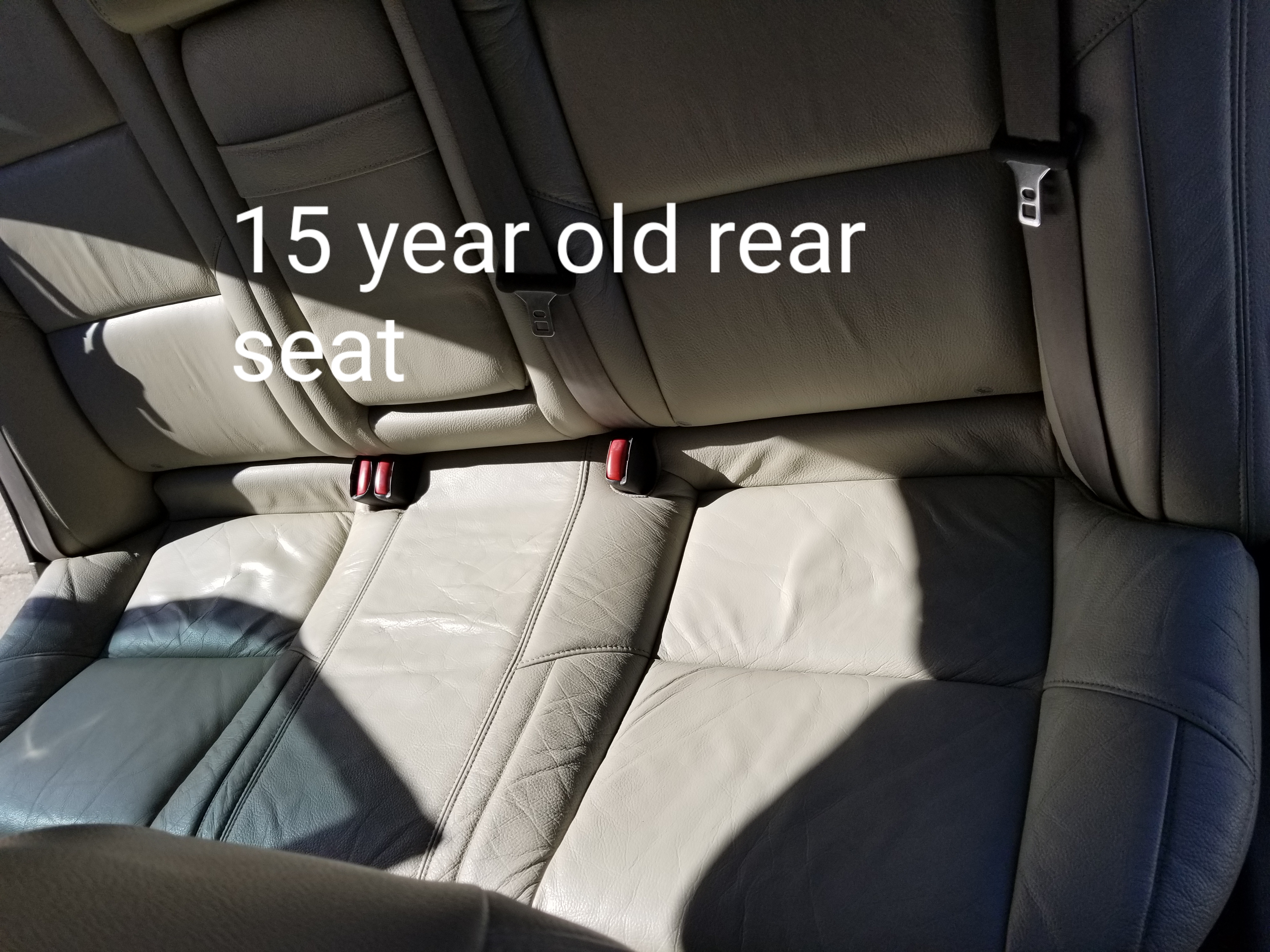

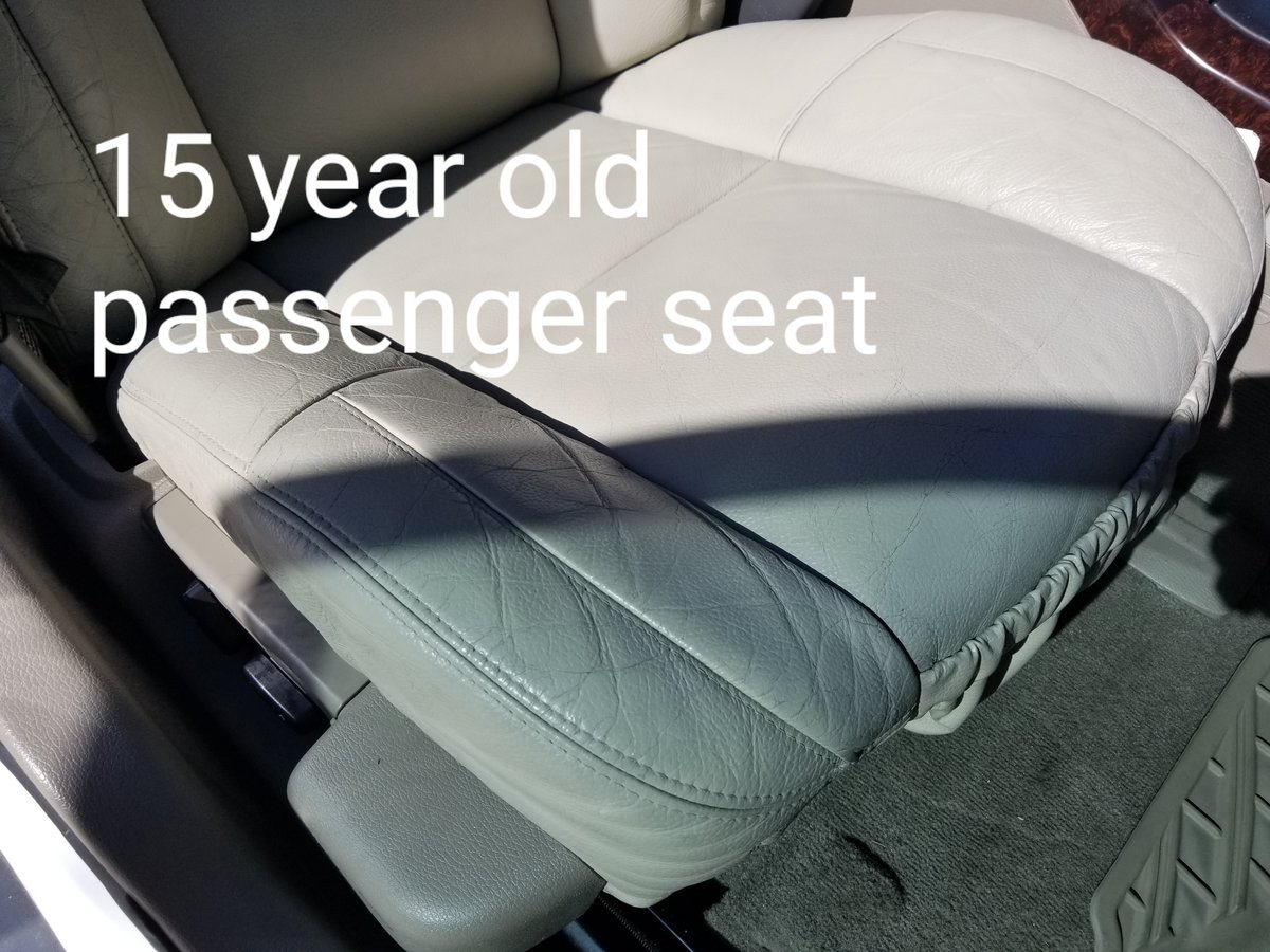

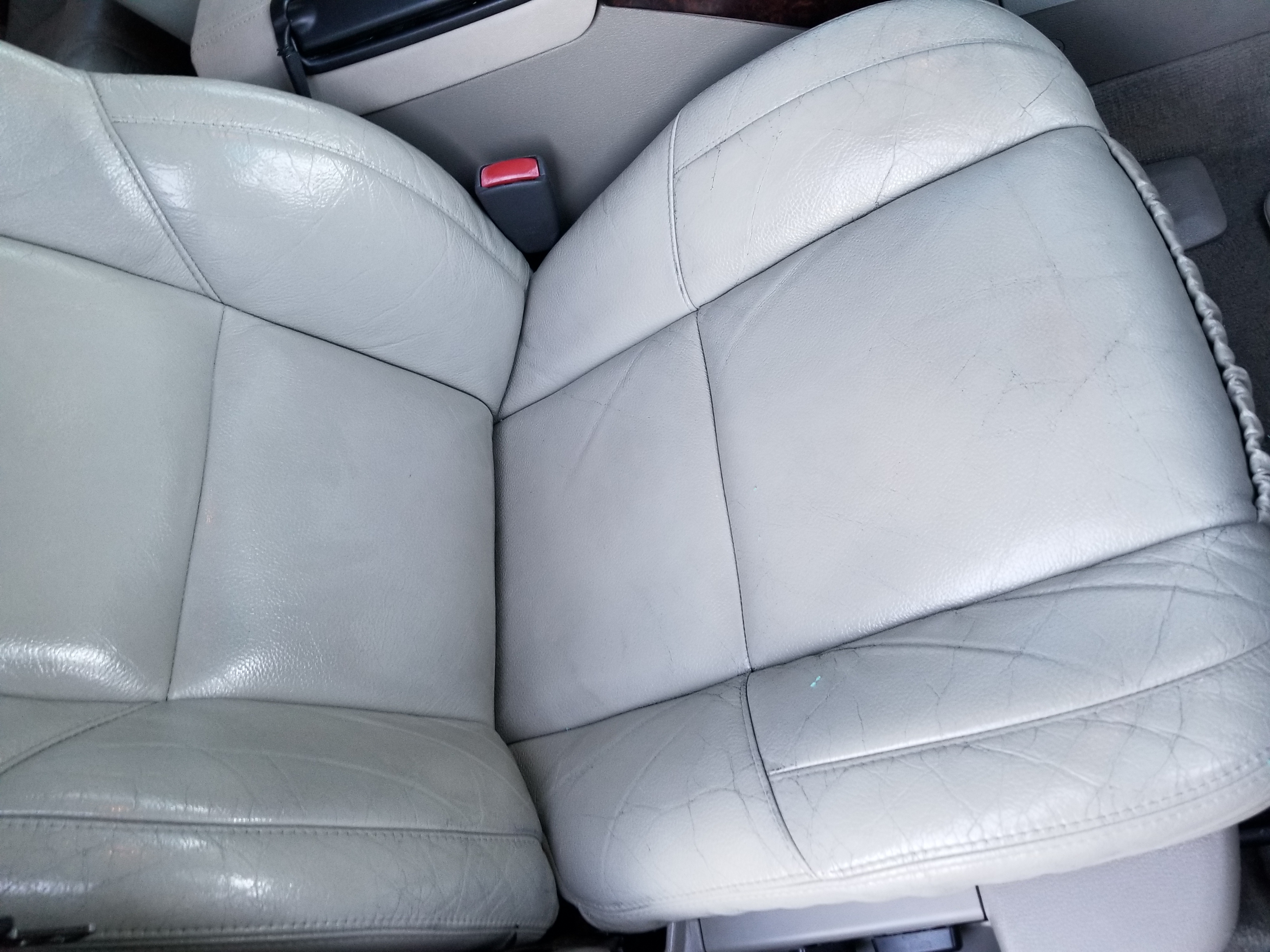

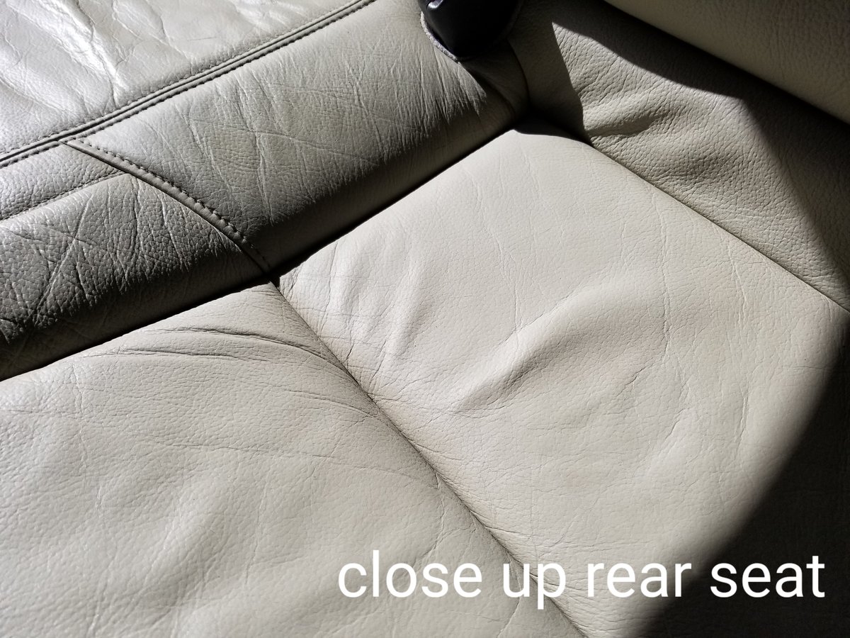

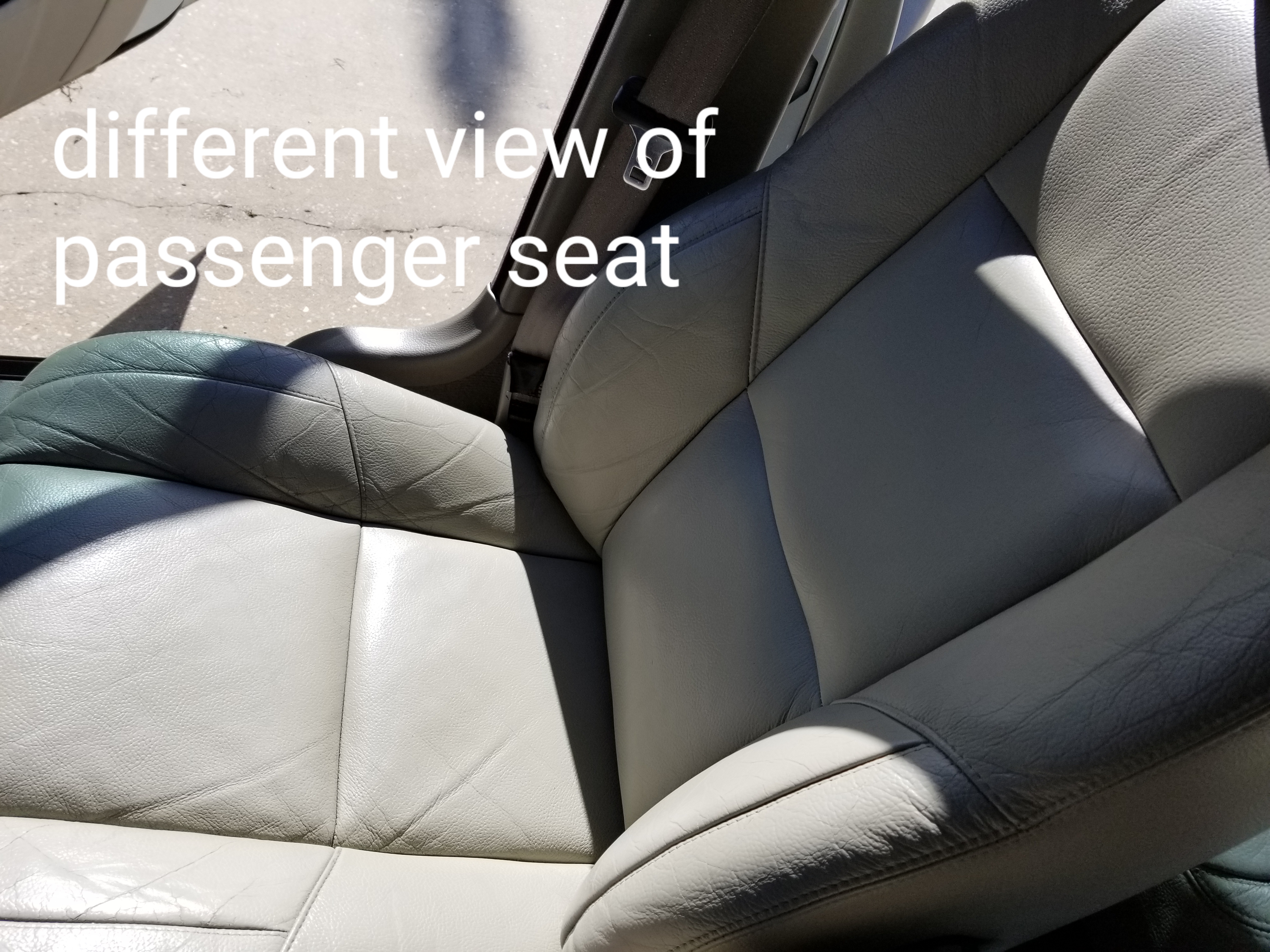

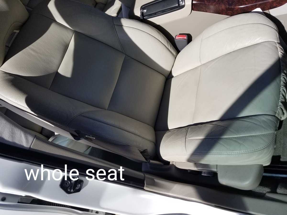

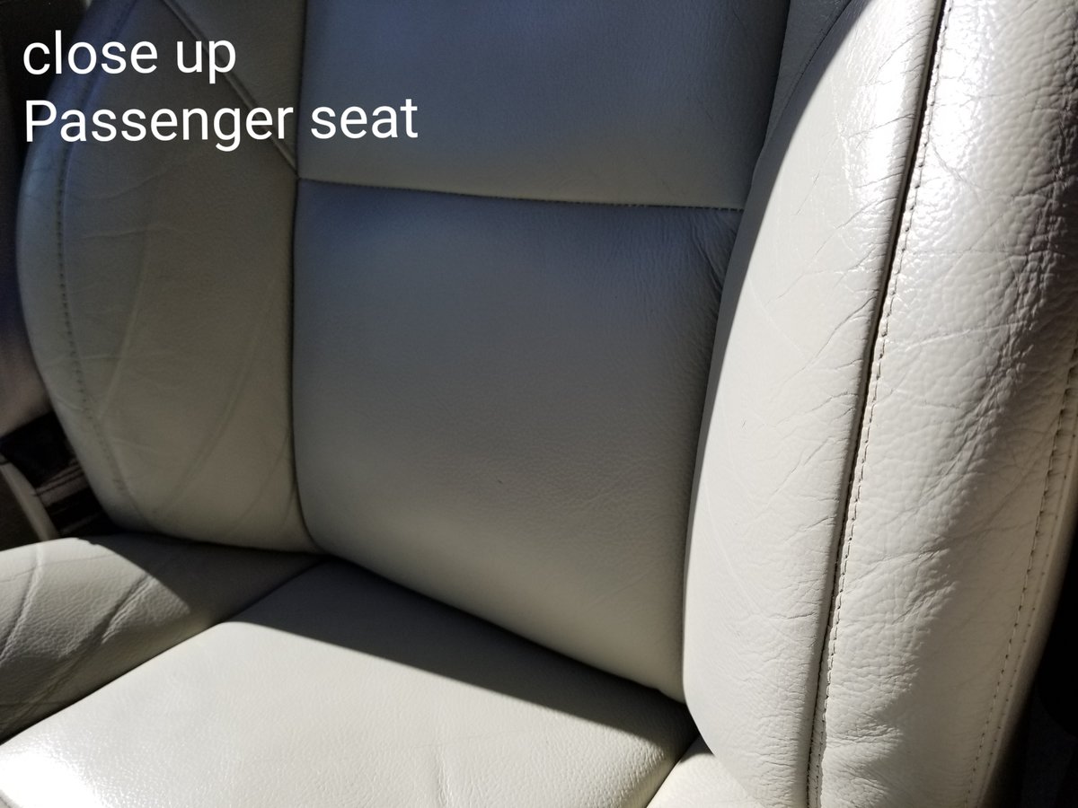

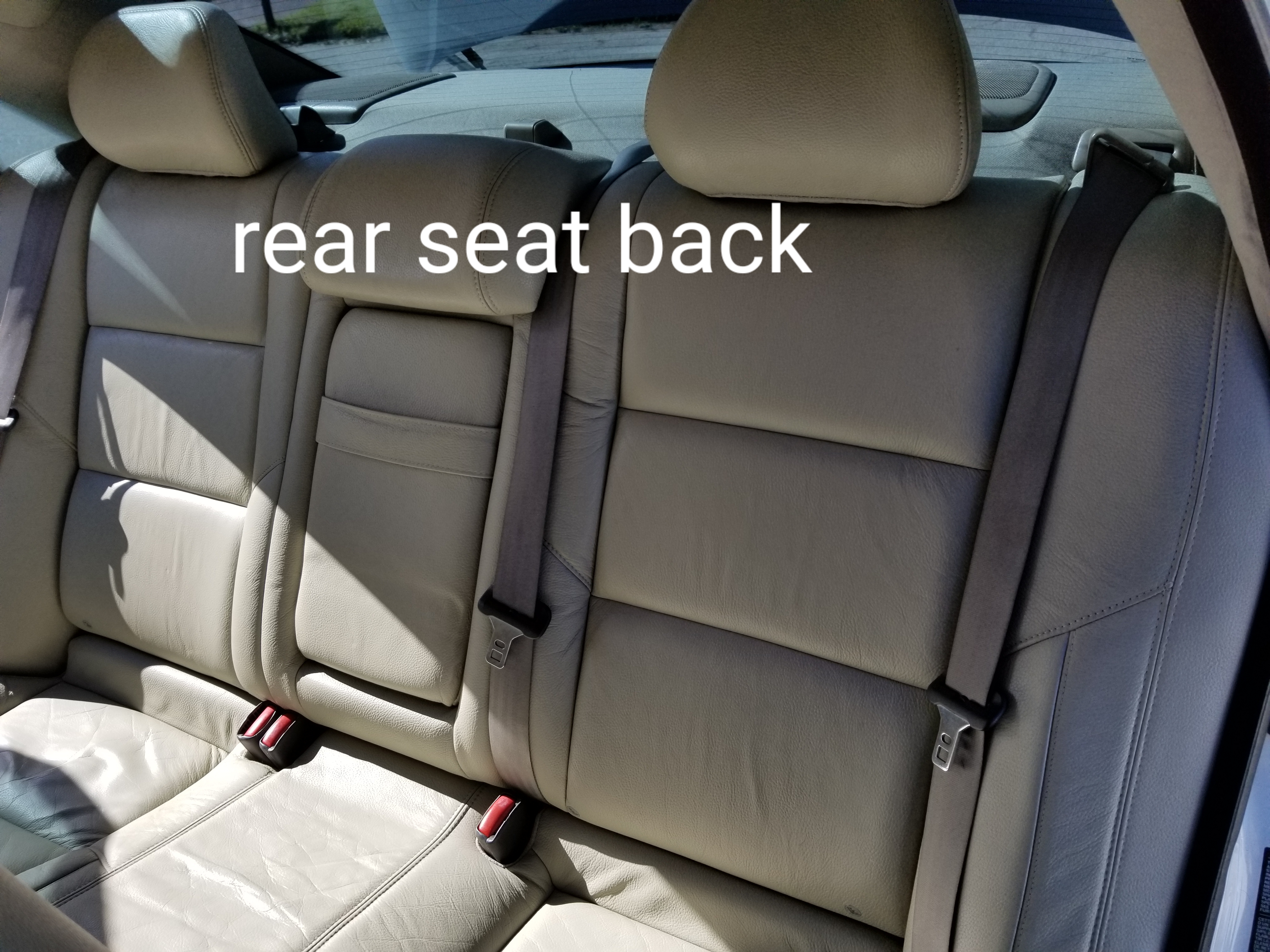

This is Wednesday day four after applying the leather oil. I applied three heavy coats on last Saturday on all the original leather. The seats are amazingly softer and the product gives a light scent of new leather. Seats are long dry as all the oil was absorbed on Sunday. Today the car sat in the morning sun for the first time after applying the oil and heat seems to have made the leather softer. This product is simply amazing! I took some photos of the leather today so see for yourself! June

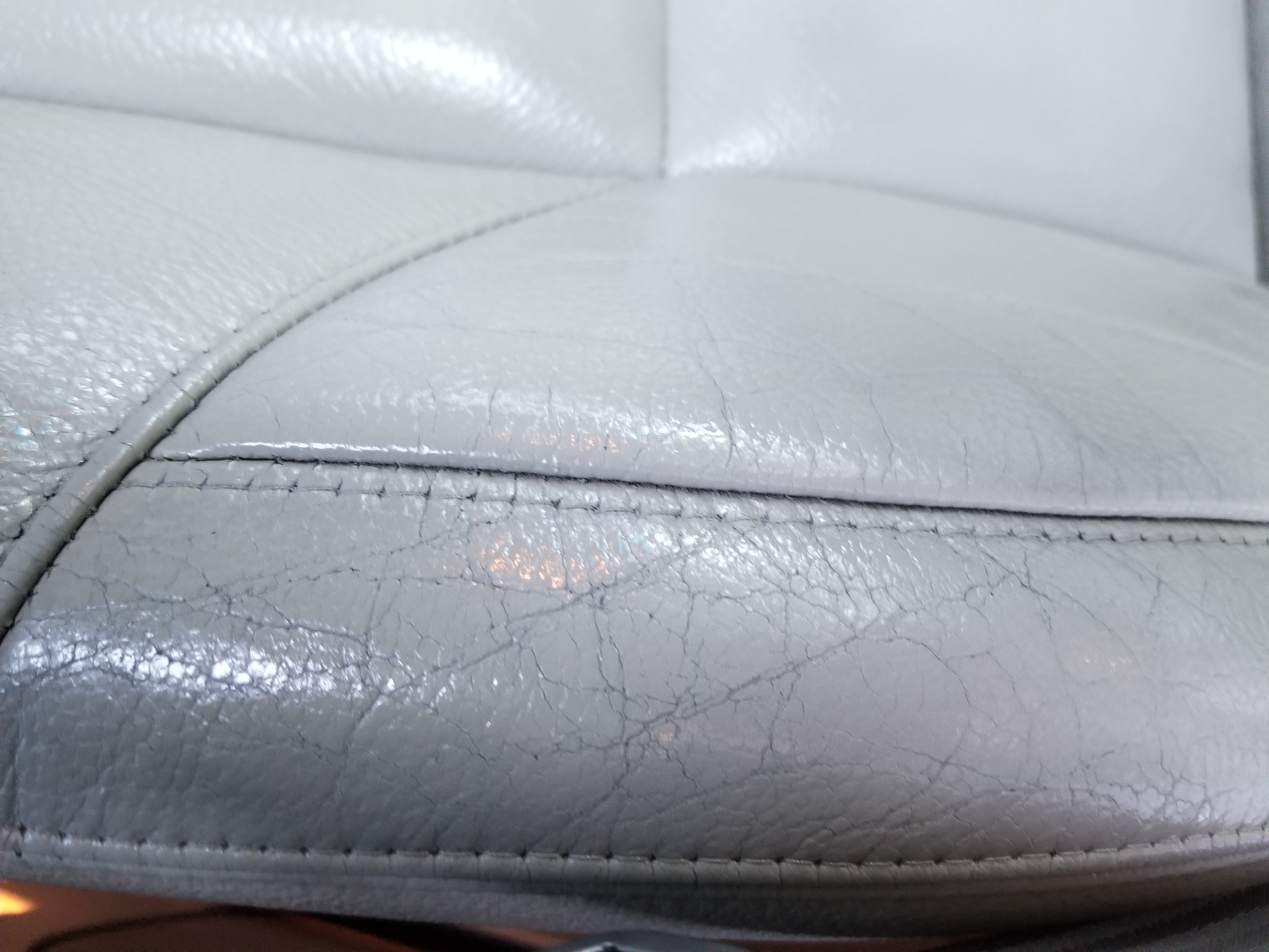

Update: For weeks the oil worked below the surface as the the leather became softer to the touch. I decided to reapply today. So I took a picture of the dark looking cracks that appear while the leather is wet with the product. When absorbed they disappear and the leather looks great. I can't get over how wonderful this product works! I will post pics tomorrow after this is absorbed.
Also I love the long lasting new leather light scent! When I applied weeks ago for the first time there were way more dark cracks. So don't be freaked if lots of dark cracks appear when applying this product. June
