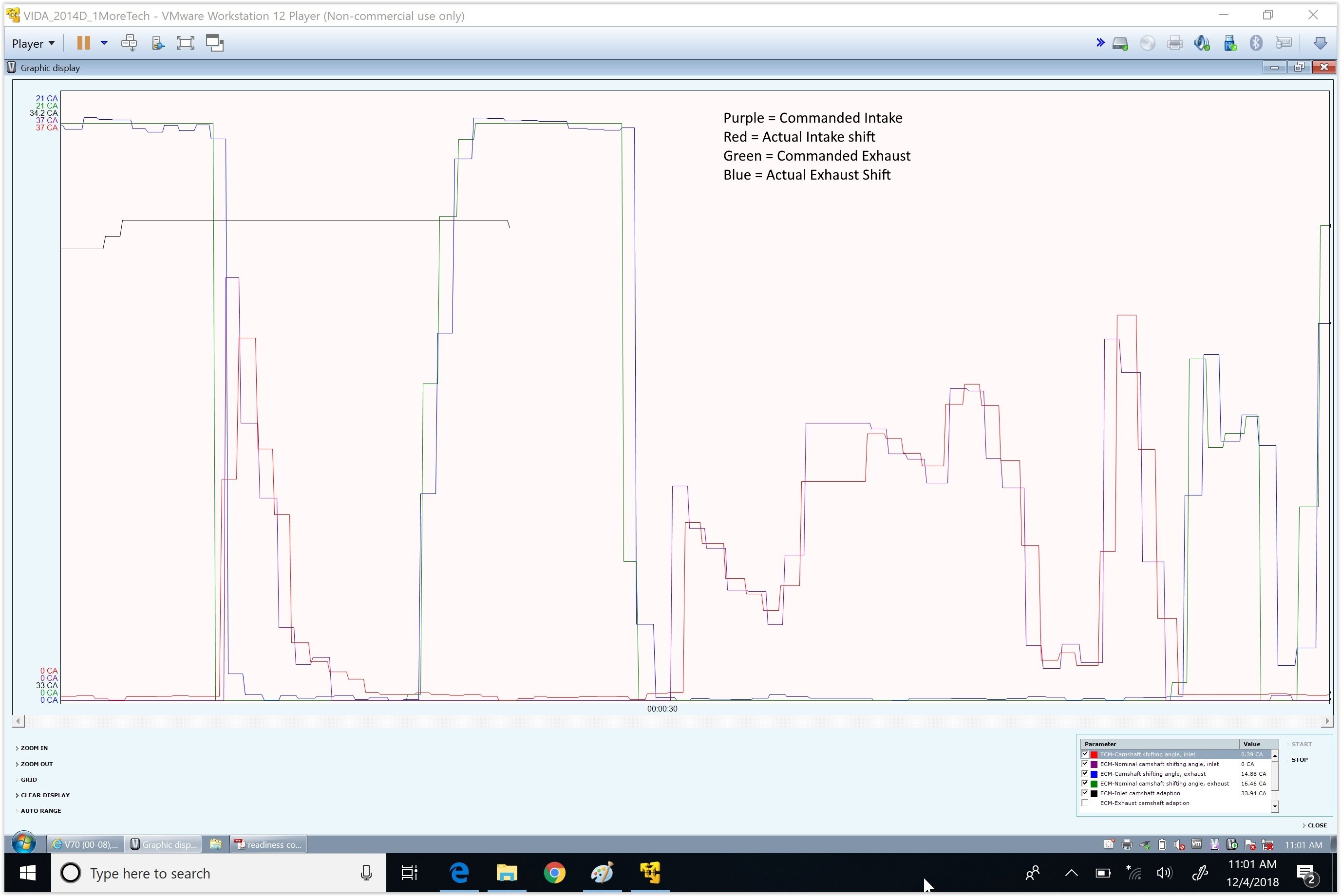

From looking at the VIDA inlet and exhaust cam parameters, the obvious problem is that nominal and actual exhaust cam shifting angles are way off (actual shifting in the ~2CA range, nominal at 25CA). It appears that the exhaust CVVT setup is not working though with that kind of error, it would seem like the exhaust hub was not in its forward-most position, so I will double check the positioning of the exhaust hub.

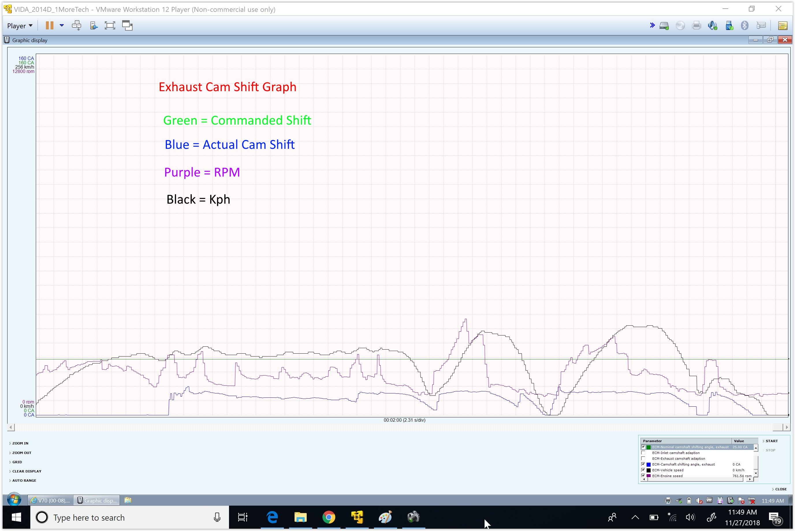

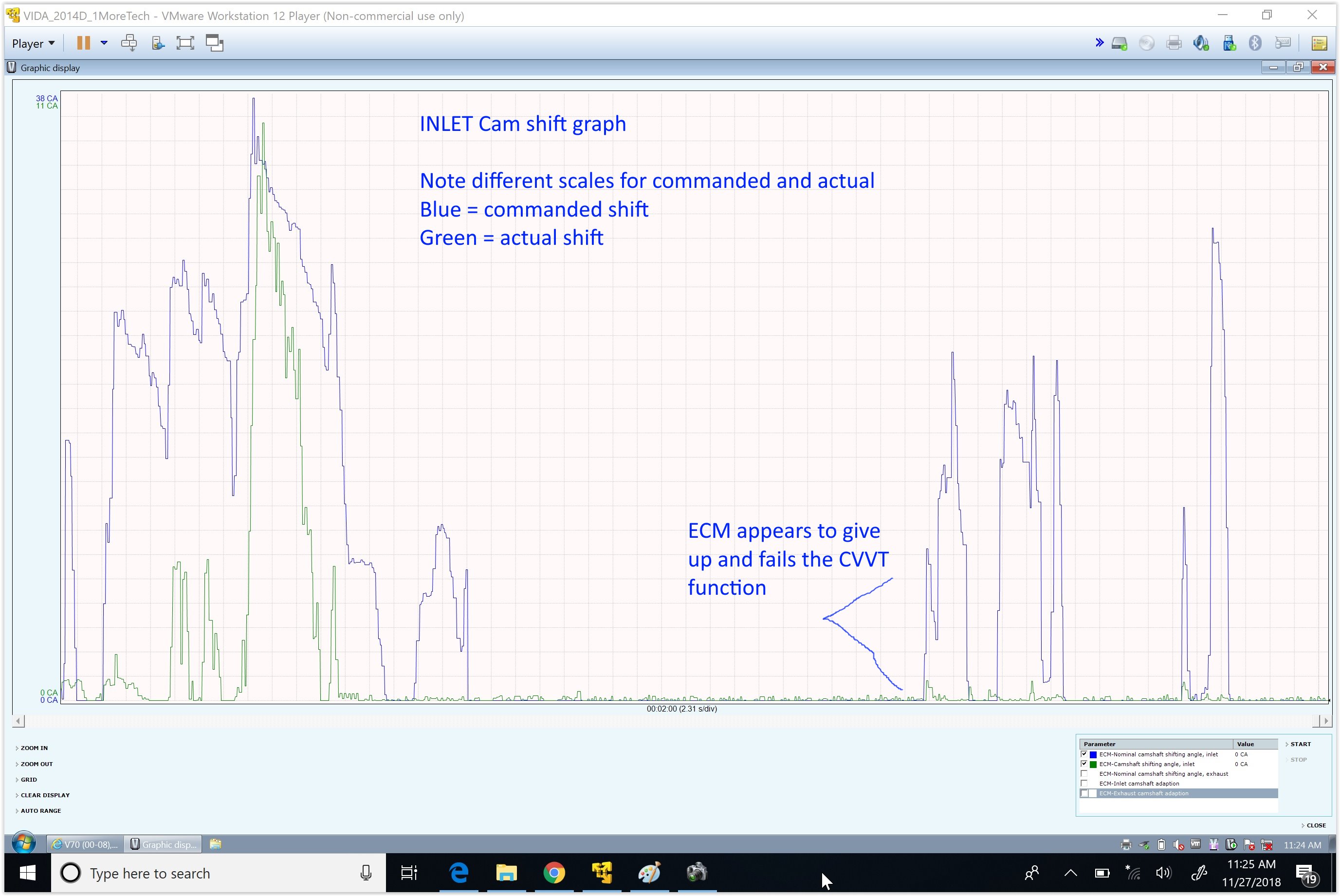

I've also attached some graphs that show the intake and exhaust nominal vs actual values over time and the inlet and exhaust adaptions, in each case with some healthy throttle stabs. As you can see on the graphs, the exhaust hub kind of lazily and randomly shifts around and the intake hub basically ignores the commanded increases on the throttle stabs. None of that seems too encouraging.

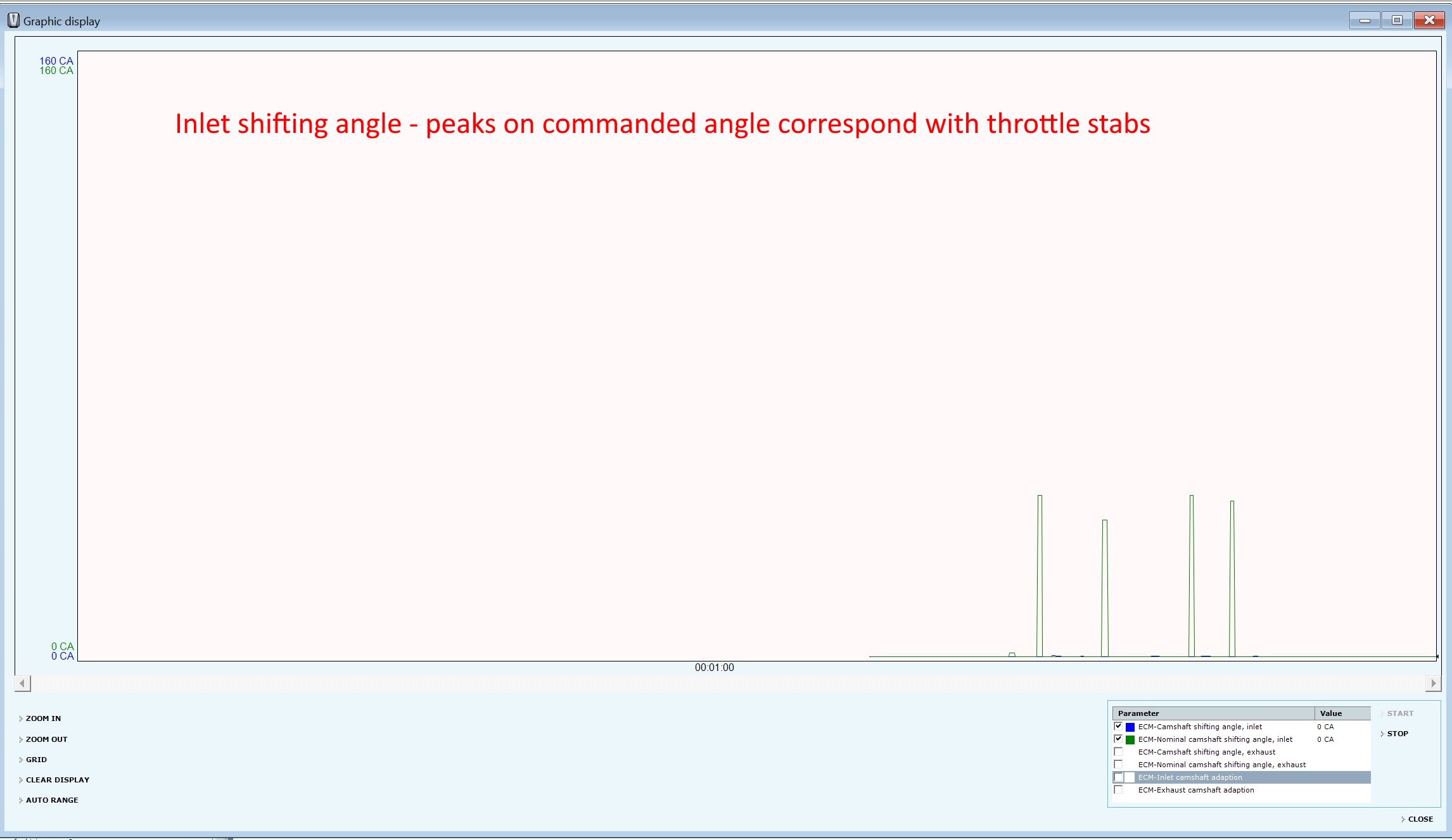

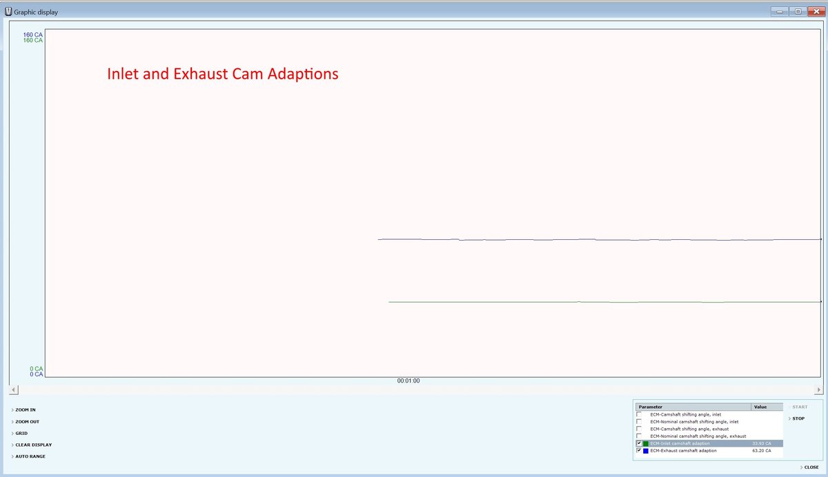

I know you were dying to help and were silently saying "if he only posted some graphs of the cam shift angles while driving after resetting the CEL but before the ECM fails the CVVT system". Well, you are in luck.
It looks like the intake and exhaust sides work to some degree, with intake working better than exhaust, but both cannot get close to what the ECM is commanding. I don't have any prior experience with this system but my SWAG is that that there is weak oil flow to the cam control solenoid and/or the CVVT unit. I'm not sure if this is the result of the Pro Parts Sweden cam control solenoids or if there could be some other reason (like a blockage of some sort - would love to hear how to diagnose and fix that, if it is a real possibility).
One question I have is: what problems can be ruled out given that the adaption angles on both the intake and exhaust are within spec?

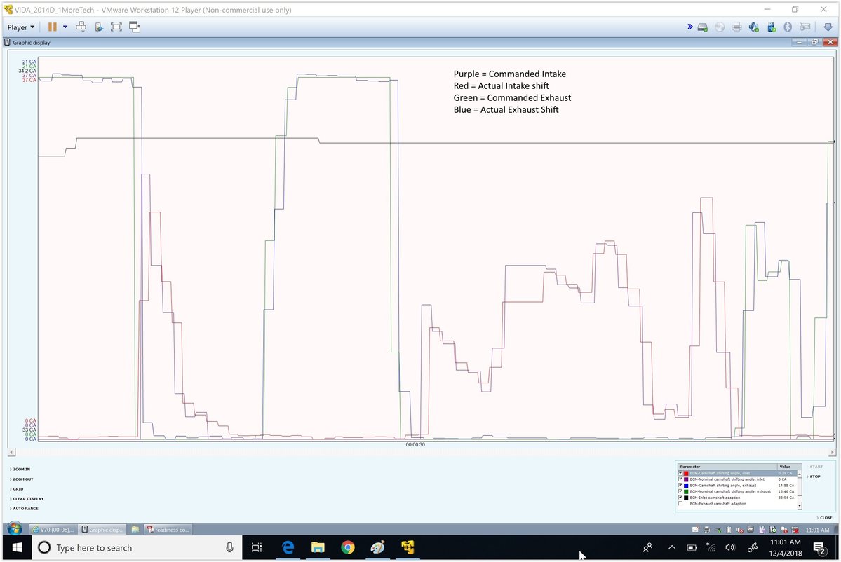

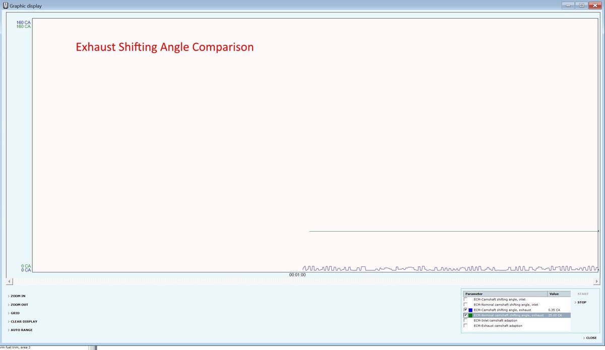

The thrilling conclusion to this is that used, cleaned OEM intake and exhaust cam solenoids worked perfectly and after a bit of driving, the CEL is gone. I replaced them one solenoid at a time due to one getting delayed. I put on the replacement exhaust solenoid first and it worked way way better than the Pro Parts Sweden unit but the exhaust solenoid didn't start working perfectly (i.e., no pending or thrown codes) until I replaced the Pro Parts Sweden intake solenoid. Once both were replaced, it took a little while (idled for 5min) and then they both worked properly.
Here are some graphs of the properly functioning CVVT systems.
