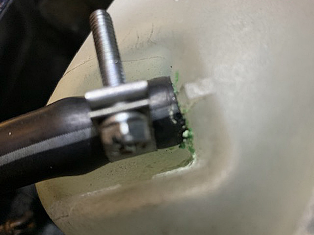

The coolant escapes at the reservoir overflow nipple. Every few weeks the level drops to min. Blue/Green residue collect at the reservoir seam. Is the hose failing?
Found wetness and crystalized residue at the connection, the clamp is at max. Is the hose failing or the reservoir cracked?

Probably cracked reservoir. I remove it and inspect under bright light

This is original hose -- maybe dried and hardened. A good weekend for this maintenance.reverend wrote: 10 Oct 2019, 19:34 You can cut off the 'molded' end of the hose that connects to the overflow jar, then push it back on and snug it back up.

Cut off 1" from the bleeder hose at the reservoir and reconnected. The wetness was visible at the either end of the bleeder hose, reservoir and radiator respectively.

This thread is reverted to UNSOLVED since the slow escape of coolant continues.
What's best type of hose to purchase from the auto parts store to replace the bleeder hose -- ID, material, etc?
