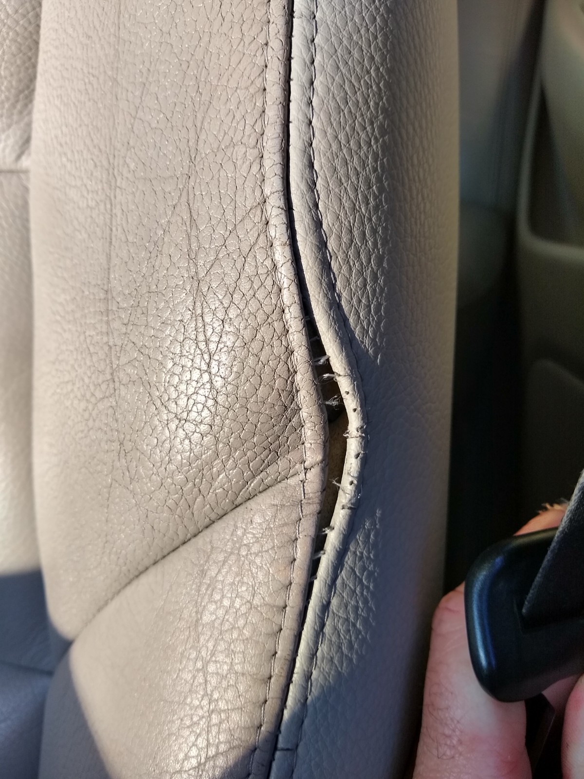

It's pretty common on these cars to have the side bolster tear. I've been on the look out for decent seats from the Pick-Your-Parts in the area but haven't had much luck. So today before the situation gets out of hand I decided to attempt to stitch up the tear before it grows to large.
JoAnn Fabrics has curved upholstery needles and heavy duty yarn. So for about $6 in supplies I decided I couldn't make the situation any worse.
https://www.joann.com/dritzhome-curved- ... gKY3_D_BwE
Before Repair

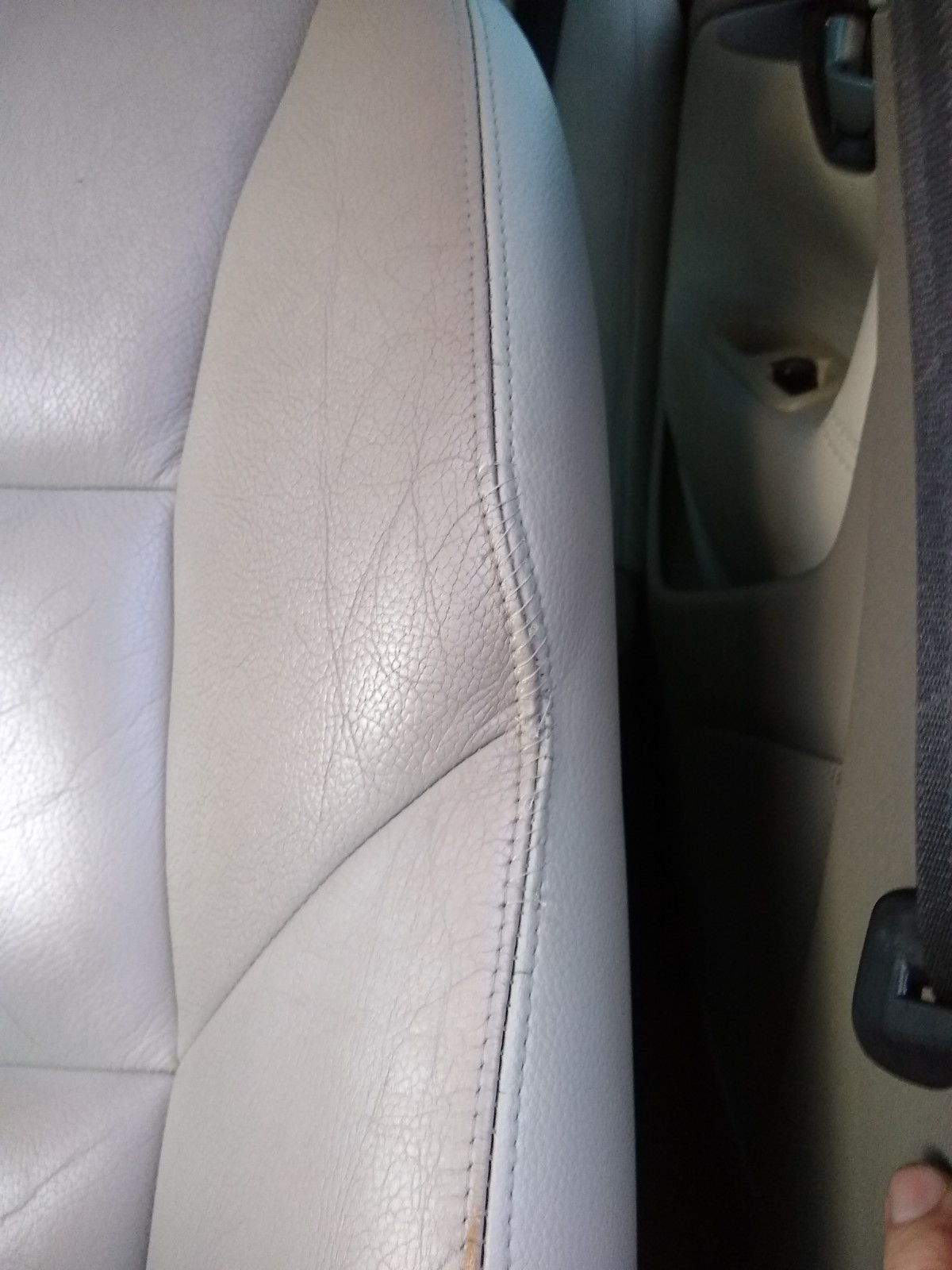

After Repair

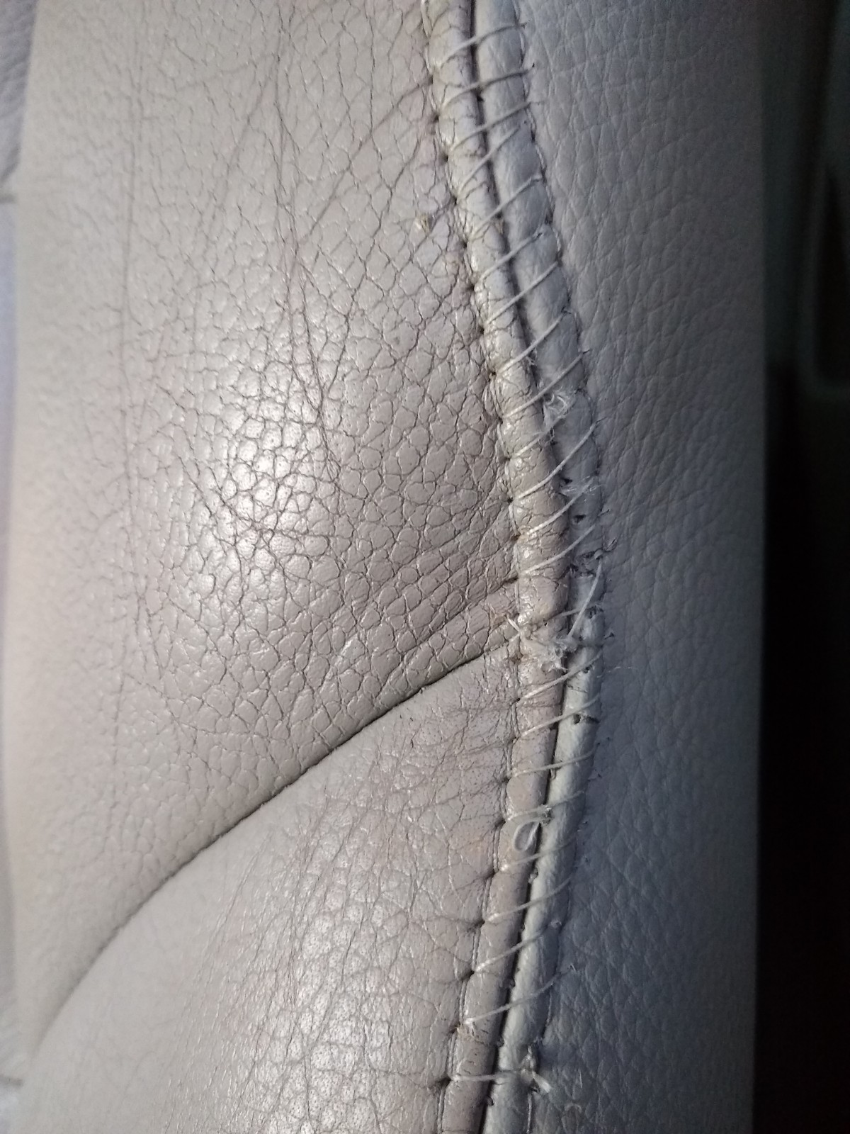

Close Up Of Repair
Some pointers if you attempt this:
* Pushing the needle through the leather is very difficult, you'll need the help of needle nose pliers.
* Push the needle into the seat so the needle exits toward the door, this gives a clean line from the most visible portion of the seat.
* It's take practice getting the needle to exit near the old stitches for a clean finish
* I placed a little glue on the knots on both ends to help prevent the knot from undoing
* You don't want to much thread tension otherwise the seat bulges
* [STEREO TYPE WARNING] Unless your mom, girlfriend, wife can teach you how to tie the knot to end/start you stitch search youtube.
* You can't reproduce the invisible factory stitch without removing the seat covers, so the your stuck with the Frankenstein'ed surgical stitches.
* Start well past where the tear starts and stitch into the tear and well past.
Good luck, I think it looks great compared to the seat tearing.

What thread did you use? I tried this with standard thread and broke it

I picked it up at Joann's Fabric. I couldn't break it with my hands while the other stuff I could.abscate wrote: 03 Dec 2018, 03:50
https://www.joann.com/gutermann-extra-s ... 02323.html
