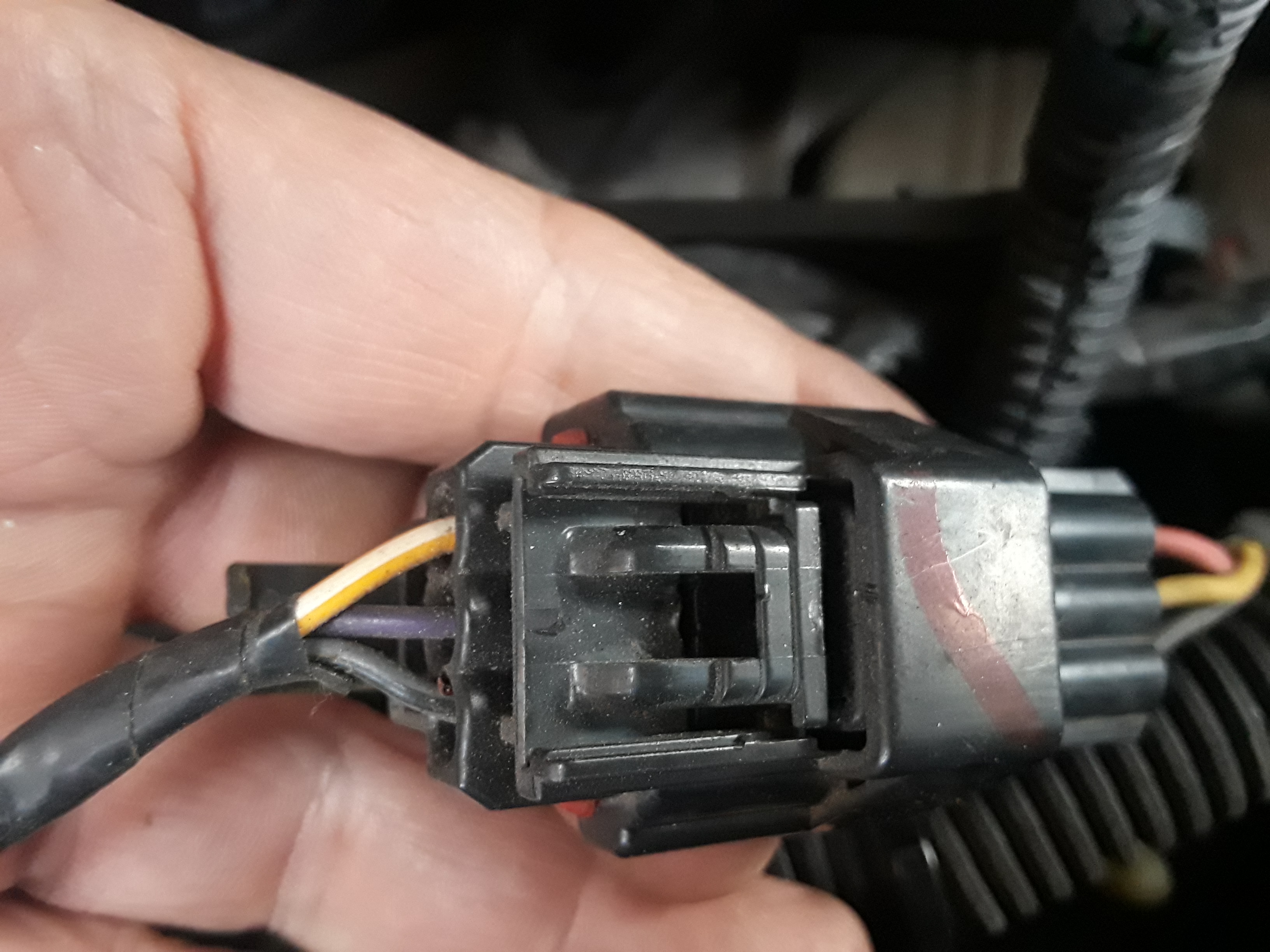

not the unhandiest guy around but too often stumped on electrical connectors since on different cars I see different ones and often an exercise in futility figuring out how they separate.
Wanting to so a simple replacement of oxygen sensor on 01 S60 and I could piddle with this connector forever and still not have a clue how to separate--------so frustrating when something that should be simple becomes the hardest most time consuming part of a simple job.
The attached pic is not the connector for the sensor just one that looks like it that I could get a decent pic of. Can someone pleeeeeze tell me how this separates, totally stumped by it all

As mentioned, depress in the midle of the bottom of the U, depress with a screw driver while pulling on the connector. Even better ask someone to pull 9n it. It may be a bit stuck.

Try pushing it together when you depress the lock tang (above) then pull it apart.

Depress the jail cell and pull on the rocket boosters!!
