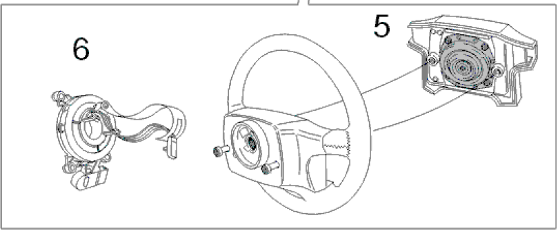

Smar1991 wrote: 03 Dec 2018, 17:082-1-2
I've never pulled steering wheel off, but from photo I suppose they use something that contacts a rotating surface.
There is a right and wrong way when trouble shooting, in terms of dis-arming it.
"For driver's and passenger airbags manufactured between 1993 and 1996, the service life can be extended to 15 years"
2-1-2 Steering wheel module, break in wiring
