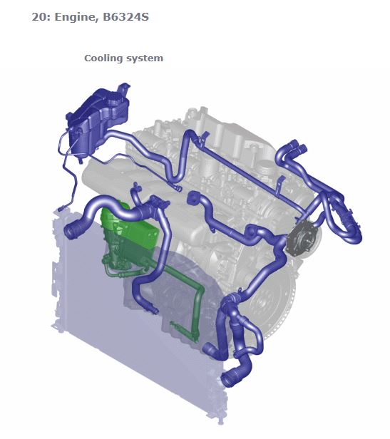

Rear is AC, refrigerant only. Coolant path does not extend past the heater core in the console, at least that I can see.
Not sure what engine this car has, can see a diagram of the coolant paths with the 3.2 I6 and the V8 (heater core is #4 in the diagram)
edit 121218- add V8 diagram

Legend for the V8:
1-Cylinder block
2-Right cylinder head
3-Electric coolant pump
4-Heat exchanger (passenger compartment)
5-Preheating crankcase ventilation
6-Throttle body
7-Upper cooling hose
8-Bypass pipe
9-To cylinder head
10-Radiator
11-Oil cooler
12-Lower cooling hose
13-Thermostat housing
14-Coolant pump
15-Left cylinder head
16-Expansion tank with level sensor
17-Air bleed circuit
1-Cylinder block
6-Throttle body
8-Bypass pipe
9-To cylinder head
10-Radiator
11-Oil cooler
14-Coolant pump

Good info on coolant routing. Based on this info the coolant is traveling internally or externally before landing on the floor in middle of the car. If internal I still think you have a grommet missing as it shouldn't be draining. It sounds internal b/c of the other symptoms you point out.
Hose it all down well if you can and then put the dye in. The leak source is most likely near the fire wall. ggleavitt's post of sources brings up many other causes, but based on your internal observations I would stick with the heater core related items to start. Either way the dye and said check list makes finding the leak fairly straight forward (only a few tricky ones).
