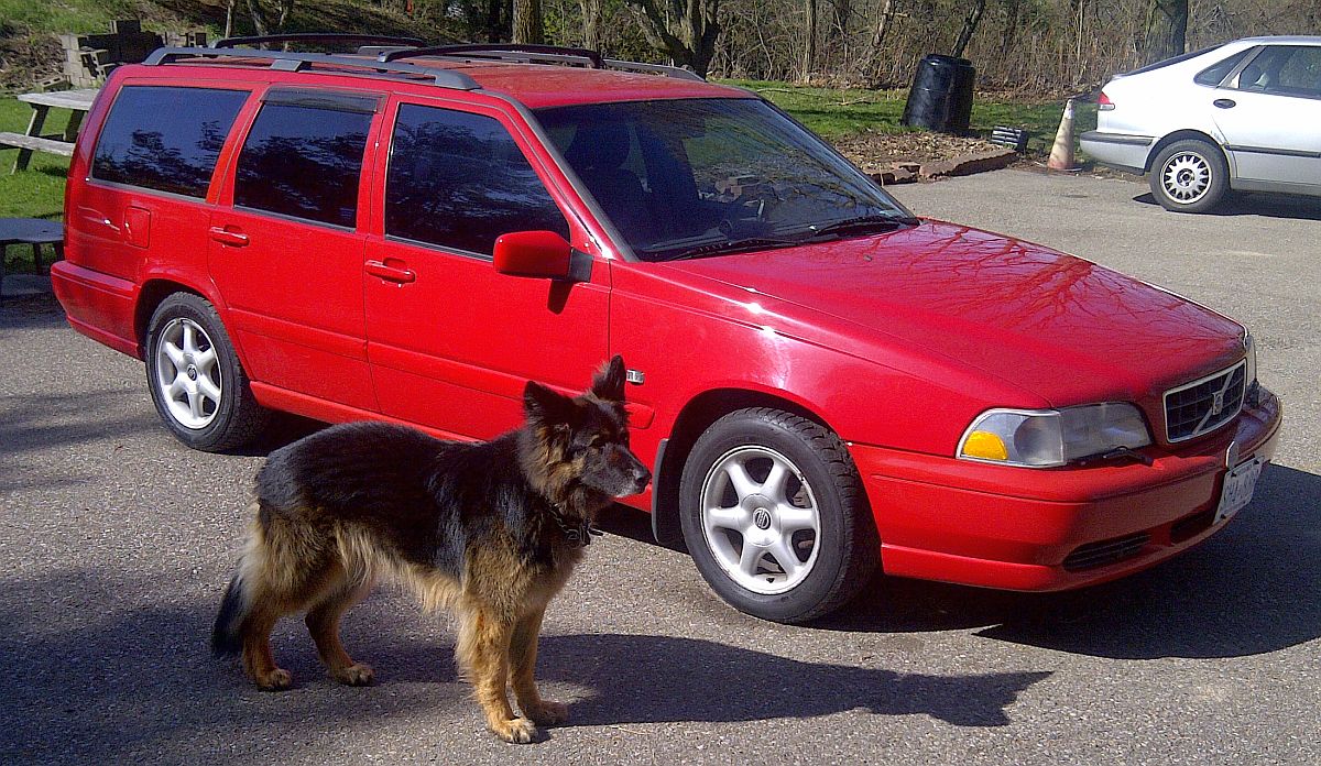

Here's my V70 and its favorite passenger ..
