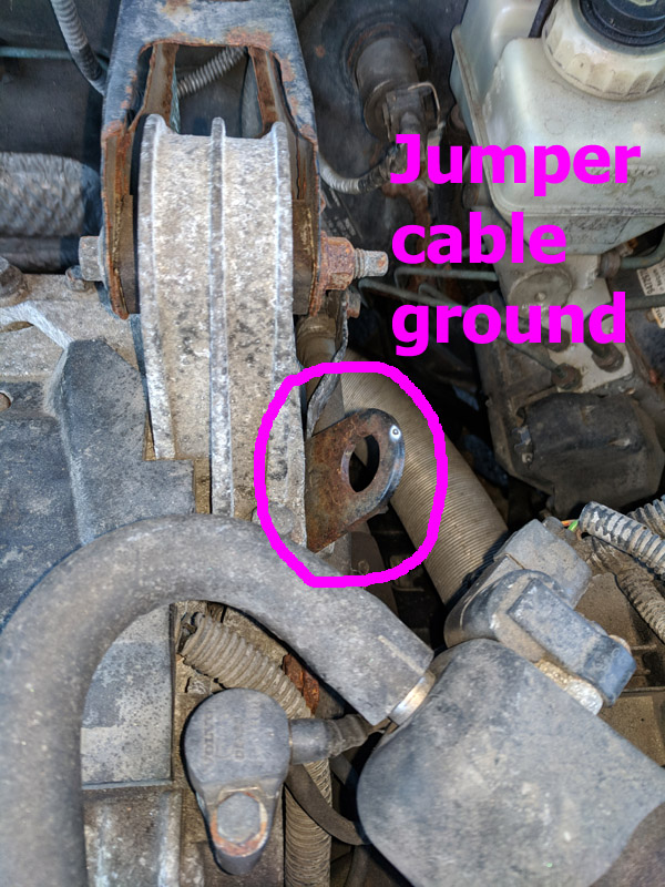

After searching the forum, I found a post which recommended using jumper cables to connect the battery negative post to a ground point on the engine. I connected the cable to the rear driver's side of the engine, what appears to be a lifting point near the upper motor mount. With that in place, the car started right up. Without it, nothing. When I connected the cable, I heard some familiar clicks from the engine.

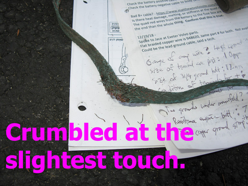

The grounding straps at the back of the engine are my problem. When I removed my center strap for measurement, it crumbled in my hands. Replacing these grounding straps is good preventative maintenance on these 20 year old cars.
The braided copper ground straps at the back of the engine are part # 948620 (thanks to my local Volvo dealership for finding this). They are no longer available from Volvo or on any parts websites. I plan to make my own replacements.
They are 12" long and 3/8" (10mm) wide and made of tinned flat braided copper. Their ends have terminals with 6mm holes for the 6mm x 12mm flange bolt in the engine and the 6mm post on the engine bay walls. This tinned braided copper wire is readily available online and (hopefully) at local electrical supply stores. I will use crimp terminals, then supplement them with solder and heat shrink tubing.

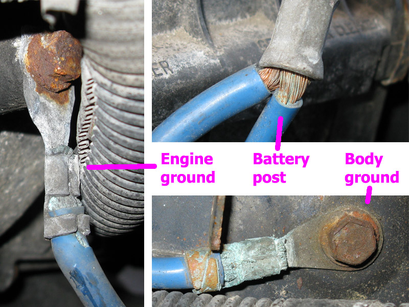

What do you all think about the ends of my negative battery terminal? They have some corrosion in the wires and rust where they connect. But they feel solid when I press on them. Are these bad enough for me to proactively replace the cable?

- Posts: 36145
Remove bolt, make everything shiny metal, replace bolt
Dremel is my tool of choice for this

But are the cable ends too corroded, thus needing replacement?
