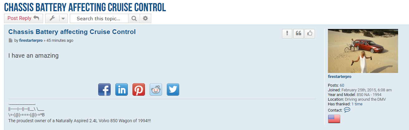

Chassis Battery affecting Cruise Control

I have an amazing

Go on...?
I'm not missing something right?

I'm invested now

"Despite the negative press cruzcntrl..."

FAcebook has decided to censor your posts

Lol.... Put my phone in my pocket mid-message and forgot about it.
