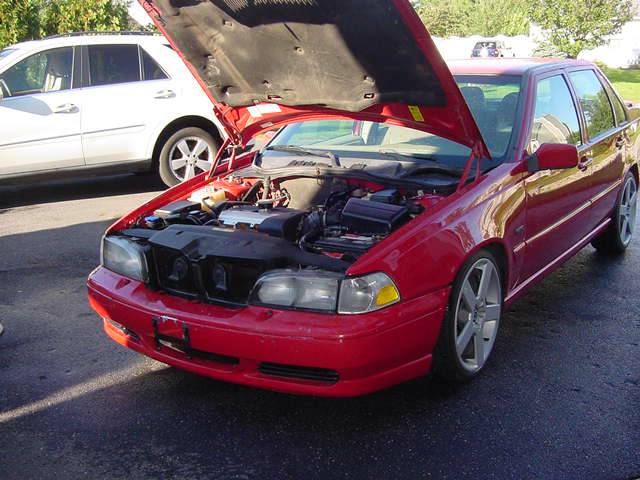

if theres a method please chime in. im looking to diy them to match my diy blk housing headlights
ive tried using my heatgun and no luck.
has anyone on here opened up there front signal lights?
