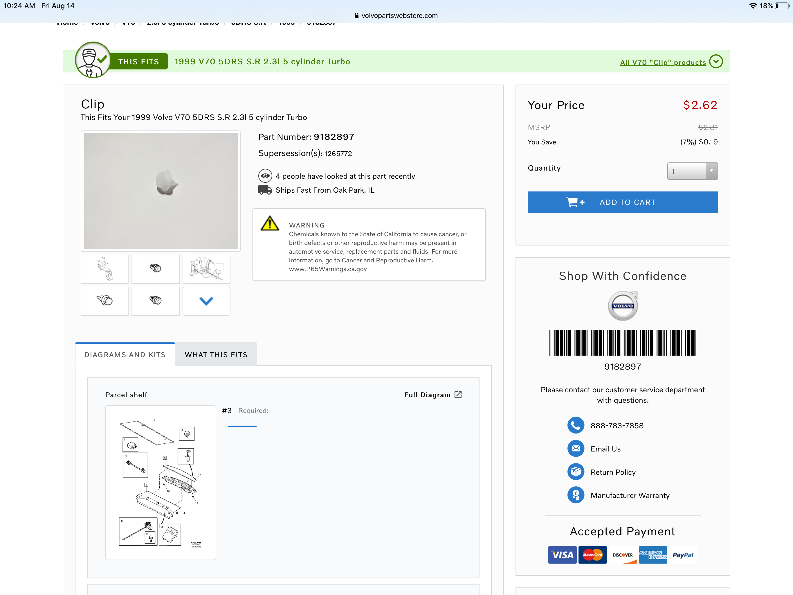

abscate wrote: 28 Dec 2018, 04:45 I think the switch is buried in the driver door lock mechanism so it might be a door panel off operation. Not a big deal, you can still buy the plastic clips in case some break from age and get a clean reinstall.
FCP IPD EEURO LISLE and others...
Here’s theVolvo call off part 9182897 Or 9451812
