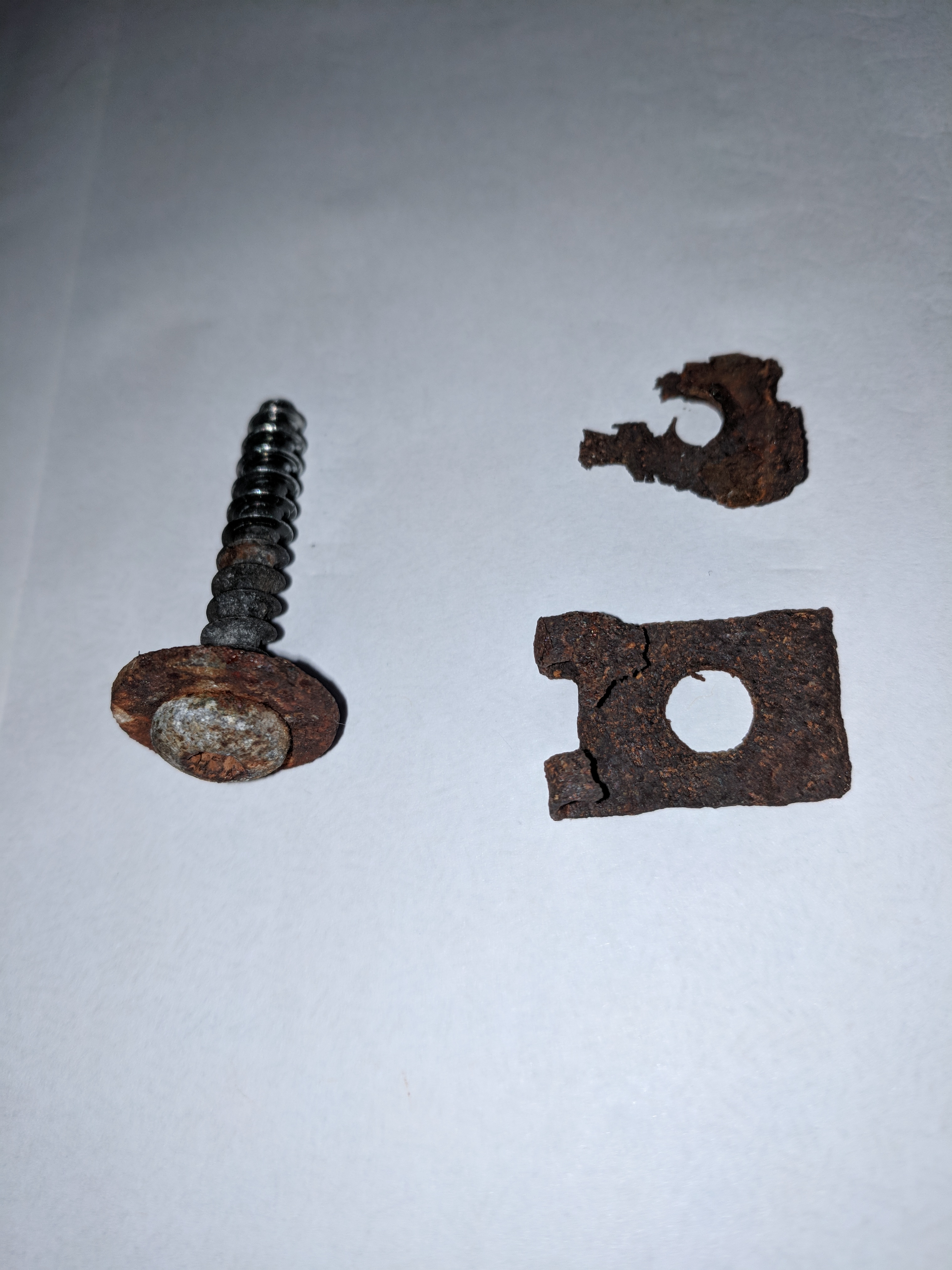

Hello, each time I work on my 2000 V70, I have to remove rusty clips, bolts, and other tiny parts. I'd love to buy replacements, but they aren't available at even the most comprehensive online parts store - Volvo Parts Web Store. I can try a dealership, but that's tedious.
Which website has parts diagrams for and sells all the clips, bolts, and other tiny parts which are rusting and breaking on our 20 year old cars?
Which website sells Volvo clips, bolts, and other tiny parts?

In this instance, I'm trying to replace the U nuts and screws which hold the cooling fan to the radiator. My local hardware stores have large inventories from Midwest Fasteners. These easily help me find most parts, but not these. So I tried the very comprehensive McMaster-Carr. I think I found the parts that I need, but I have to buy in quantities of 50.
The U nut I need is part 1268957, $1.74 at Volvo Parts Web Store or $5.50 at my local dealership. Since I need two, I should just pay $10 for the pack of 50 from McMaster.
Upon closer inspection, I did find them at Volvo Parts Web Store, under the electric cooling fan section. They're expensive, but I'd rather pay more than have 48 unused parts lying around my house.
