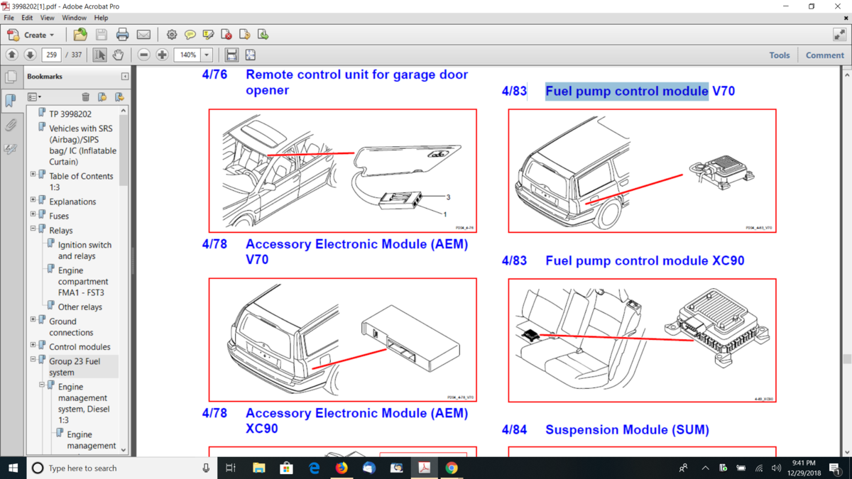

No fuel pump relay. There is a Fuel pump control module ( FPCM, FPM or PEM depending on the model) in the rear quarter panel.

In our Aussie market we may not have PEM due to emission laws and other variations. If you have a fuel pressure sensor fitted to the fuel rail then you have a PEM otherwise the relay is on the CEM above the steering column

The relay on 2005 and later is board mounted in CEM. It may be replaceable via desolder but you will have to locate it by tracing fuse track on PCB. Or someone may have done that and save that step. The relays are available from different sources. I have found a few of the solder to board relays on Ebay and Amazon.
