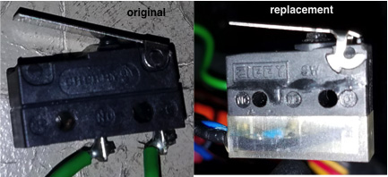

Well, I replaced the microswitch and the solenoid mechanism works. I can shift out of park without using the shift lock override button. However, I can't make the new microswitch fit the available space. But no problem - now instead of using the override button I simply reach into the exposed center console and squeeze the microswitch. Works every time. It's pretty hilarious.
It doesn't fit because the wires are enclosed within a plastic barrier. See photo. I noticed this when the switch arrived but assumed it was OK. It's not. I'm considering removing the barrier (crushing it) and hoping the wires fit when exposed (just like the original). Could be removable protection but it's stuck on there pretty tightly. Returning doesn't seem worthwhile or likely even possible after installing.
Am I missing something here? Am I missing how to make it fit? Does this switch fit other Volvos and/or is it the wrong part? Purchased here: https://www.ebay.com/itm/122986088414. What's the point of a barrier given the original microswitch on this car lasted over 20 years without one?

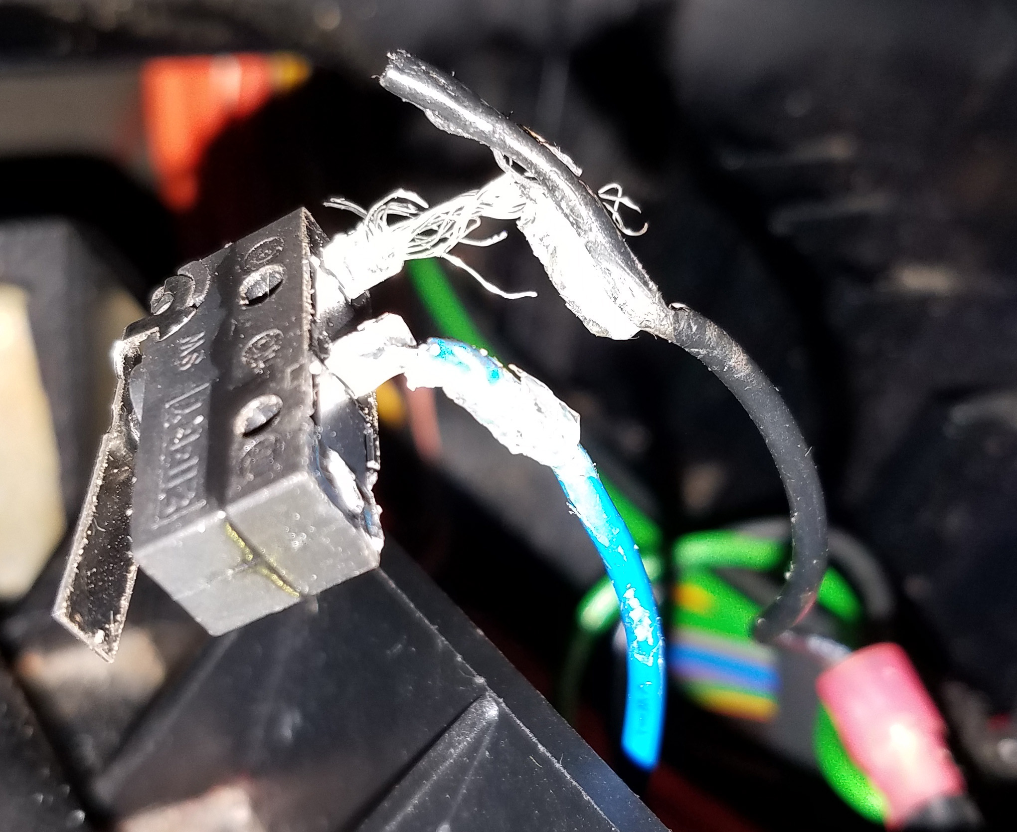

After removing the plastic barrier (another use for Vice-Grips crush) and wrapping the exposed electrical elements with electrical tape (see image below, before and after Vice-Grips and before wrapping) the switch installed and works fine - just to close this thread. May not be "permanent" (nothing is) but short-term success became a goal in itself. Presumably this protective plastic works in some vehicles. It did not in mine.

Hope you re-soldered that black wire.

I intentionally did not re-solder. It's more secure than it appears in the photo and an awkward position in the garage is a no soldering zone, at least for me, at 2 am. If it fails I now know what to do. Exposing the area only takes a few moments.
