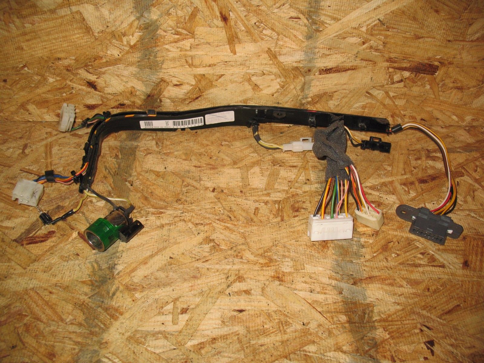

Tried to change the wire in the tunnelbox. Did not help.
Could it be a groundcable ?
