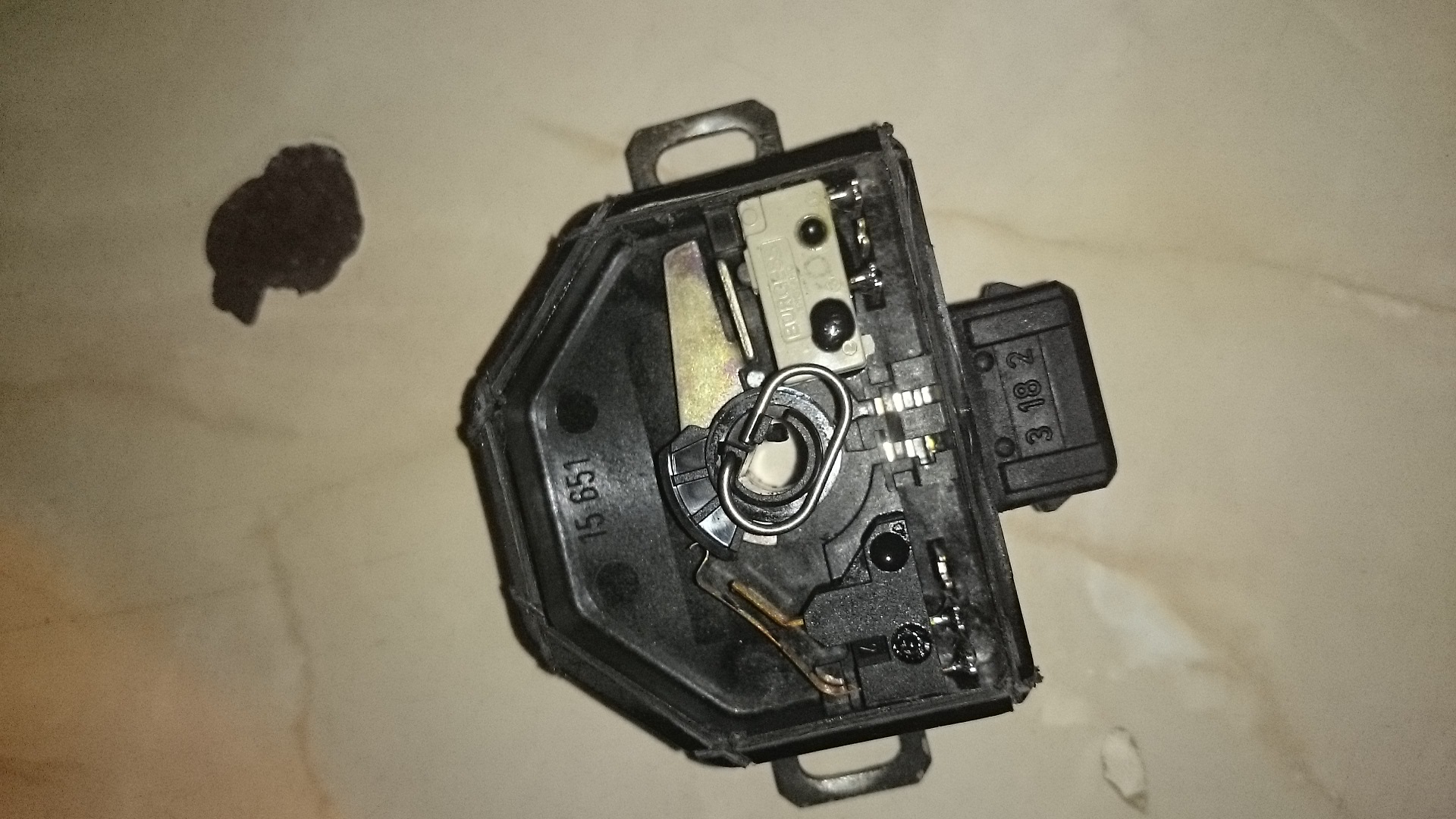

The car is misbehaving. At start from cold it revs straight up to 2000 revs and then drops too 800.
When I put my foot down on accelerator while driving, there's a major split second hesitation (only from accelerator pedal fully up position) and then it moves off fine but only when cold. When it's warm it doesn't seem to do it but it's a little bit jerky it's a manual box) and sometimes accelerates slightly on its own.
I've tested the air valve on workbench, it works, I've cleaned out flame arrestor/ crank breather, I've put new temp sensor in, and a second hand tps.
If I unplug the tpi, the revs don't drop from 2200 revs so I think the connector is making contact.
I opened up the old tps (in the pic) and seen theres nothing too it and both switches work on both tps's.

Same as 80's BMW's. I don't think a bad TPS is going to cause the loads of extra fuel. Unless WOT (wide open throttle is stuck on. They're easy to check with a meter. Hold a probe to the center pin and then to each outside pin to check idle and WOT. The variable resistance TPS didn't come along till the 960.

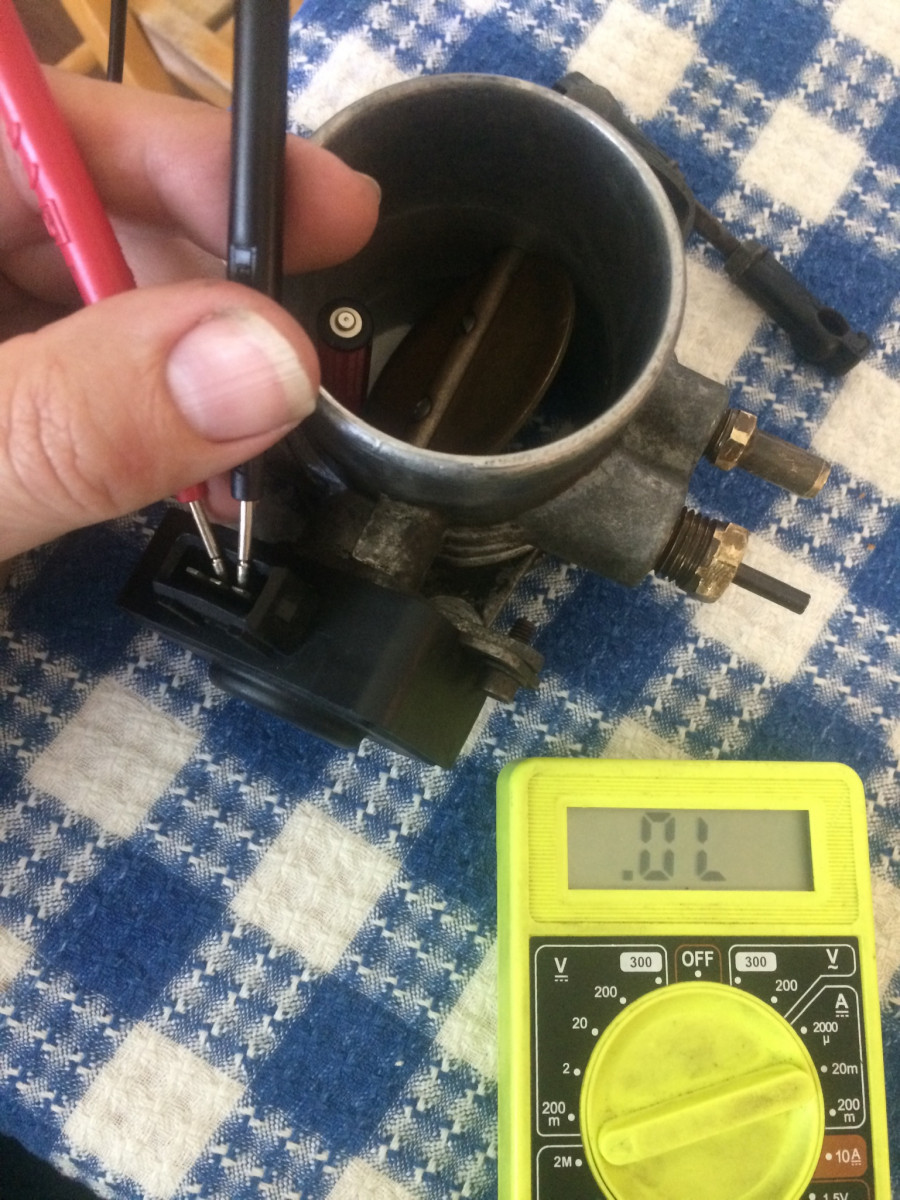

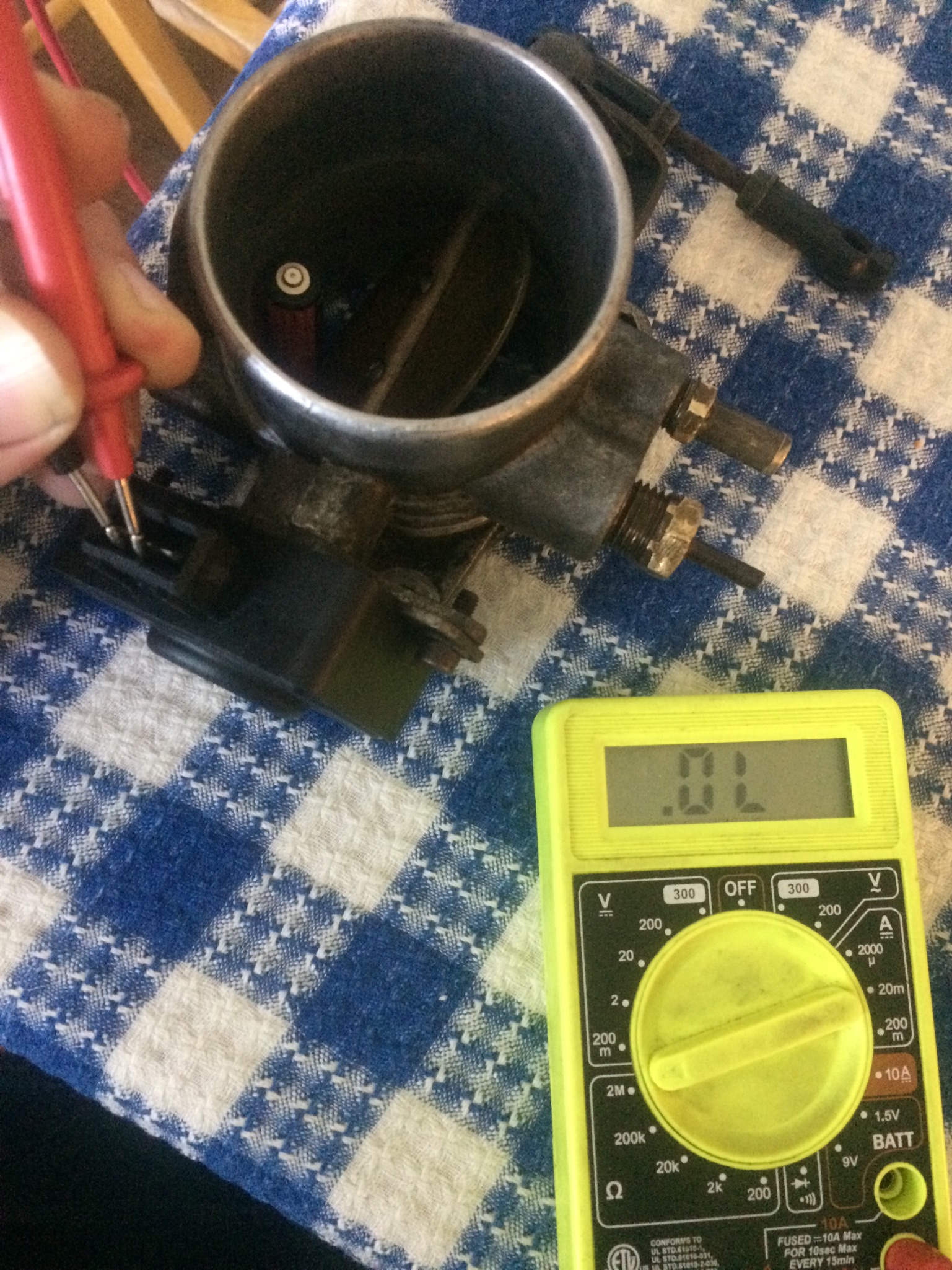

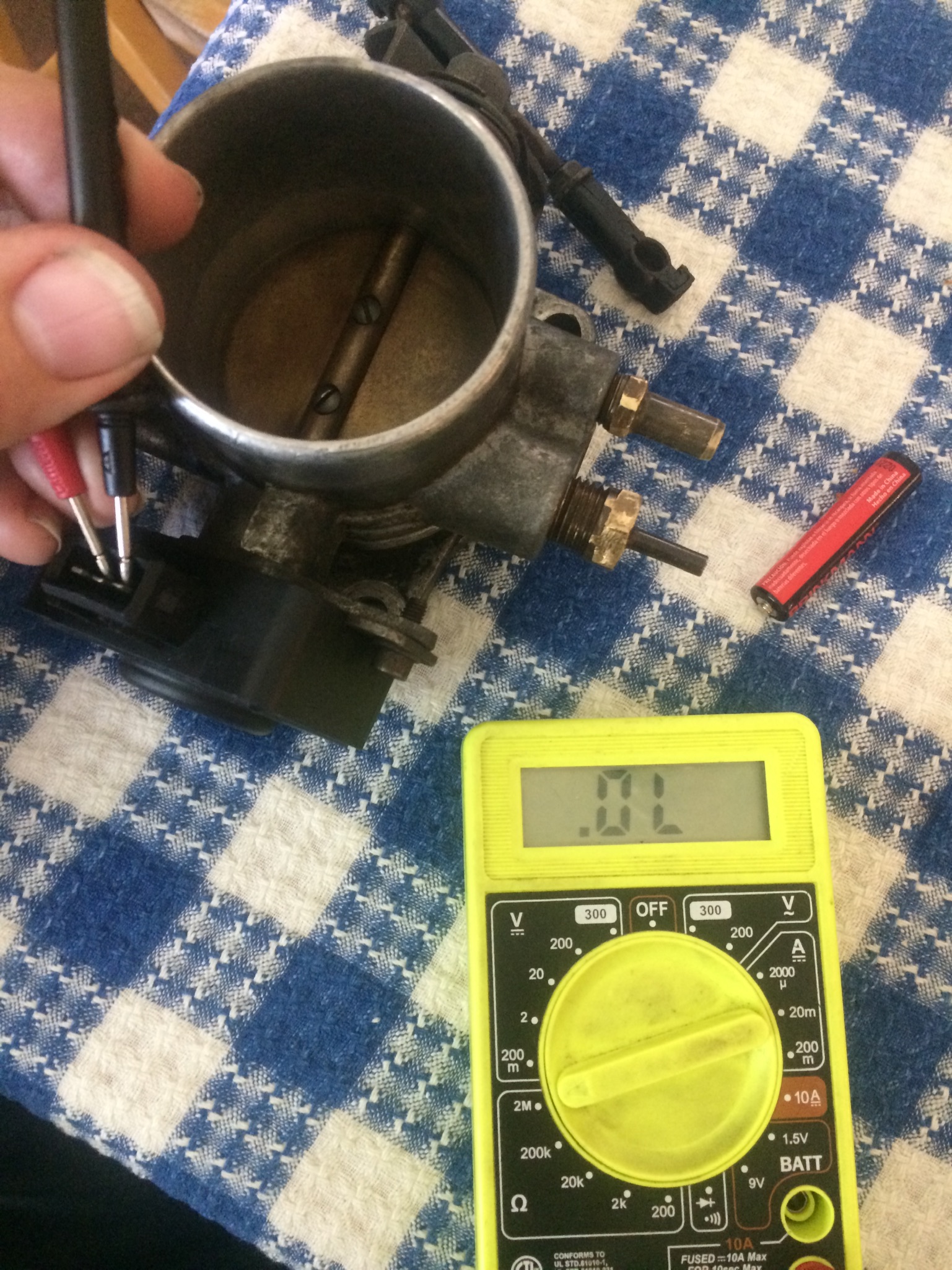

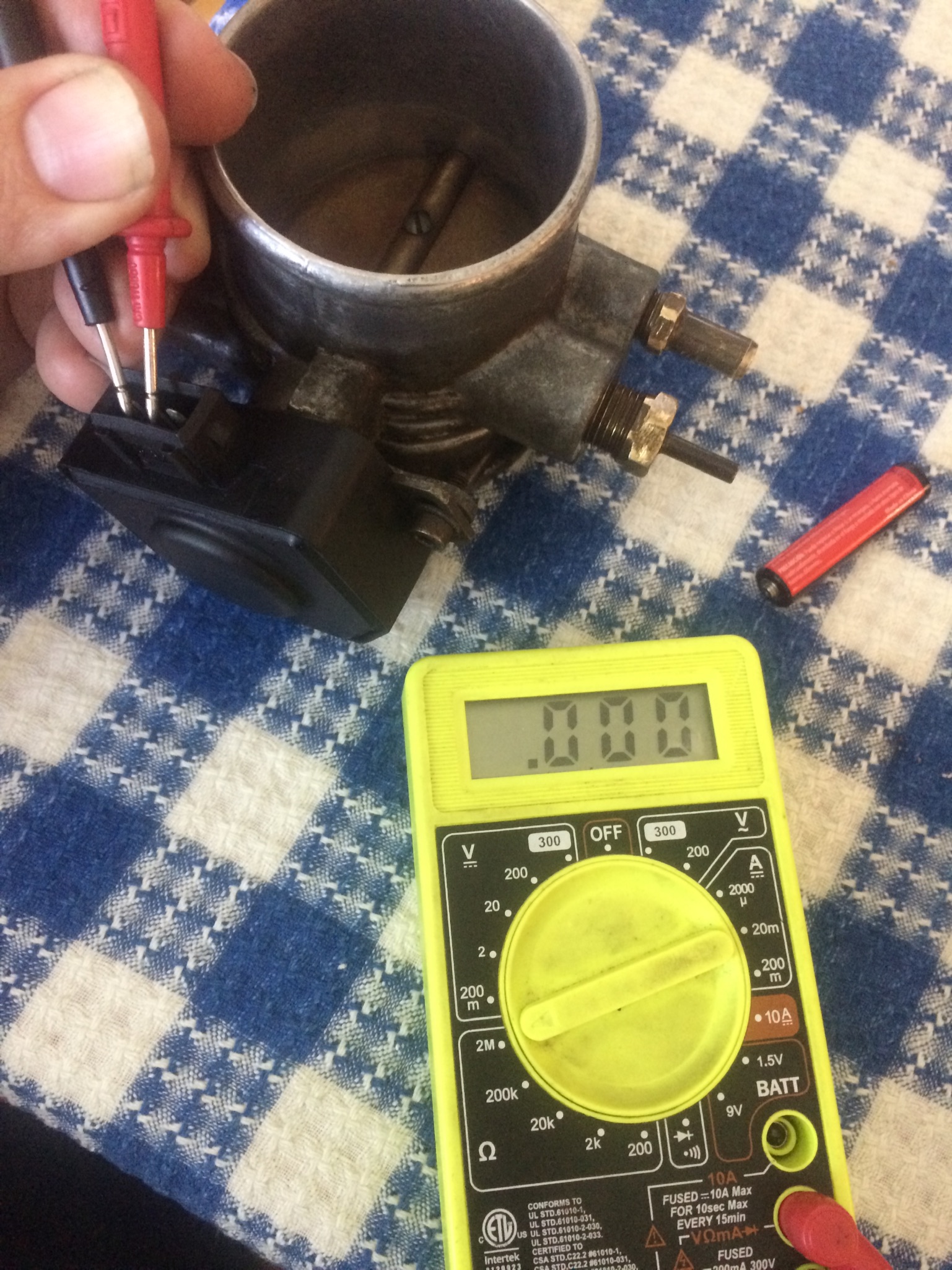

Could you say more about this test? I am placing red probe on center pin and black probe on left-hand outside pin facing outward (pics 1&2) and getting a reading of .000 ohms when valve is closed and a reading of OL when valve is open at all, but when I place the black probe on the right-hand outside pin facing outward (pics 3&4) I get OL when valve is closed and when valve is open at all? Is the sensor bad? Thanks.dm635 wrote: 23 Jan 2019, 09:23Same as 80's BMW's. I don't think a bad TPS is going to cause the loads of extra fuel. Unless WOT (wide open throttle is stuck on. They're easy to check with a meter. Hold a probe to the center pin and then to each outside pin to check idle and WOT. The variable resistance TPS didn't come along till the 960.
