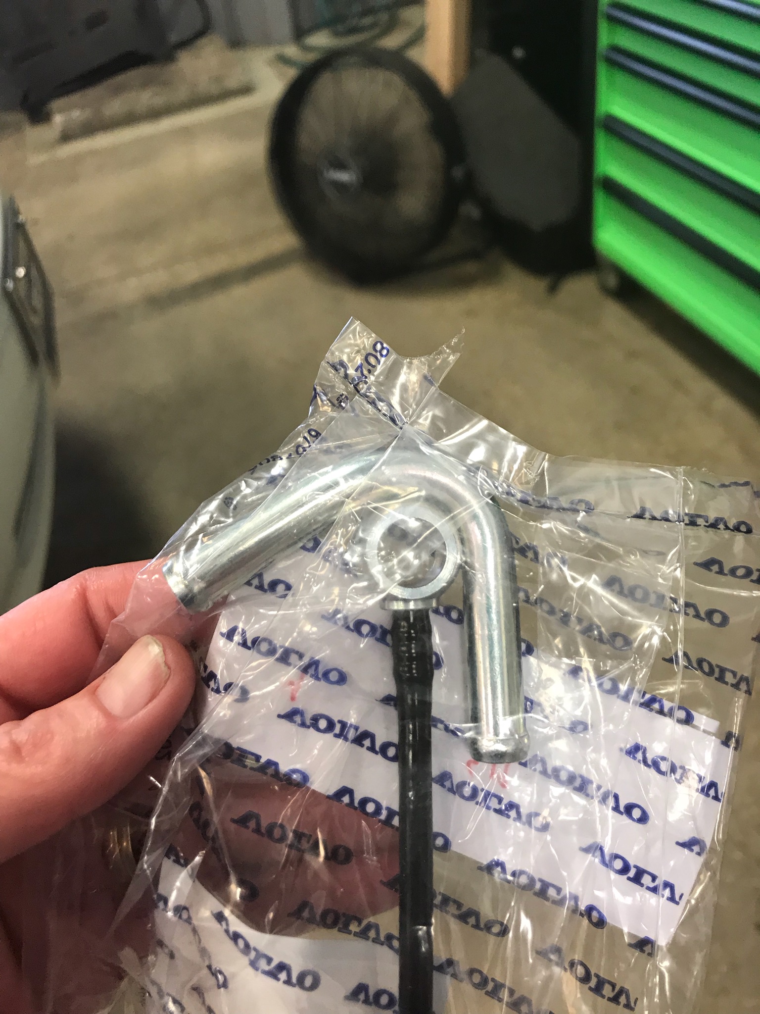

As long as the pcv system is working there is a scheduled maintenance on the banjo bolt at like 120K and like every 60K thereafter. It is in your maintenance booklet. Currently my car is in for service and I have their service loaner or I would photograph the correct page for you.
What the service is; 1 clean or replace the banjo bolt.
2 replace the tubes that go to the
banjo bolt.
Here is a photo of the part Volvo replaces in this service. Photo courtesy of my service advisor when they replaced mine on my 2004 S80 2.9 T6. This is the the tubing that connects to the main vacuum source for the PCV system from what I understand. That black tubing on that part had cracked on my original so I am glad I had the service preformed. June
banjo bolt.

"What does the banjo bolt do?"
Look at June's picture of the aluminum tube and plastic pipe. The aluminum tube which is "V" shaped has coolant flowing through it if I recall correctly. It is totally sealed from the rest of the assembly. This has a warming and cooling function the engineers thought would be helpful. The plastic pipe off the middle carries exhaust gases (don't recall if positive or negative pressure) which the engine management system needs. I don't have my car right now so I cannot give better details - but what I describe should be enough.
The "banjo bolt" - being partially hollow, and having a hole in it, allows the gases to enter the plastic tube. When properly tightened an airtight joint is created and at the same time allows the air in the intake to pass through the plastic hose. The aluminum round circle also includes a nipple. It is one aluminum piece and is welded to the V. It has a hole in the nipple for air flow.
The main concern is the nipple gets clogged and needs to be cleared. A piece of wire shoved in there and a spraying of cleaner usually is sufficient to get it operational. In older vehicles the plastic pipe gets brittle and cracks, while the aluminum "V" remains usable. Some people replace the plastic hose with a suitable substitute. Usually the service is to just clean out the small hole in the "V" that allows the air to flow through the plastic hose. Others buy the part and just use the plastic pipe so they don't have to disturb any of the other hoses.
Looking from the front of the car at the engine, near the oil dipstick, under the front passenger side of the manifold you will find the banjo bolt and the rest of the fittings. Look at the picture so you know what you are looking for and feel around. Usually one can service the banjo bolt by loosening the oil dipstick and then attacking the banjo bolt. It can be an extreme pain to re-thread the bolt - beware of cross threading. Tighten by finger until you are near the end so you know it is going in true.
