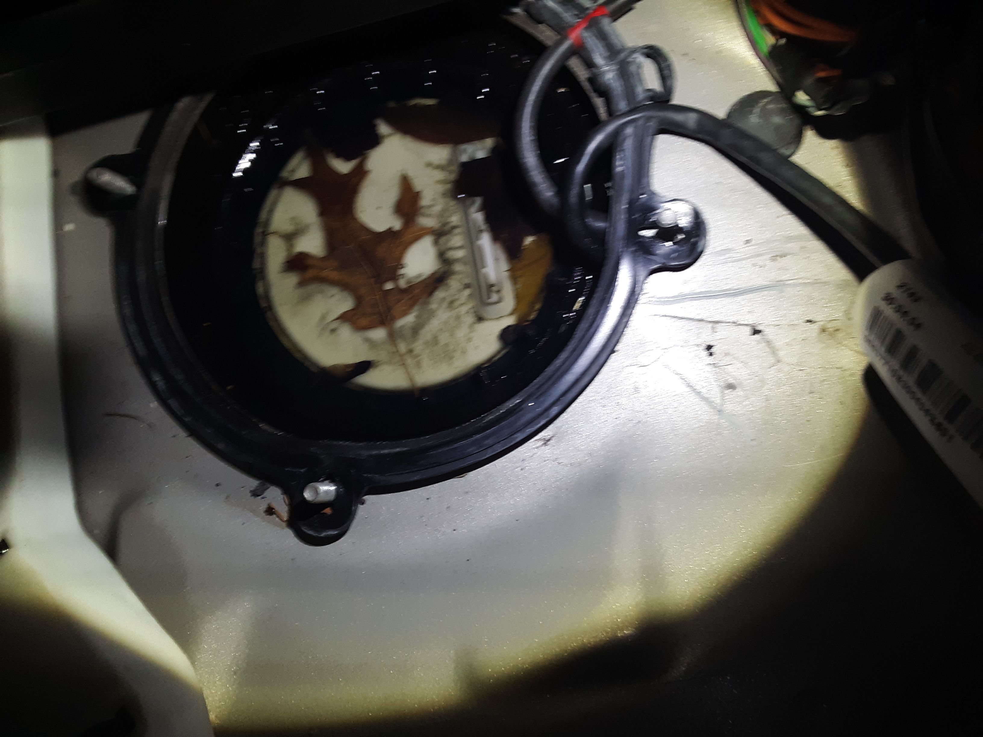

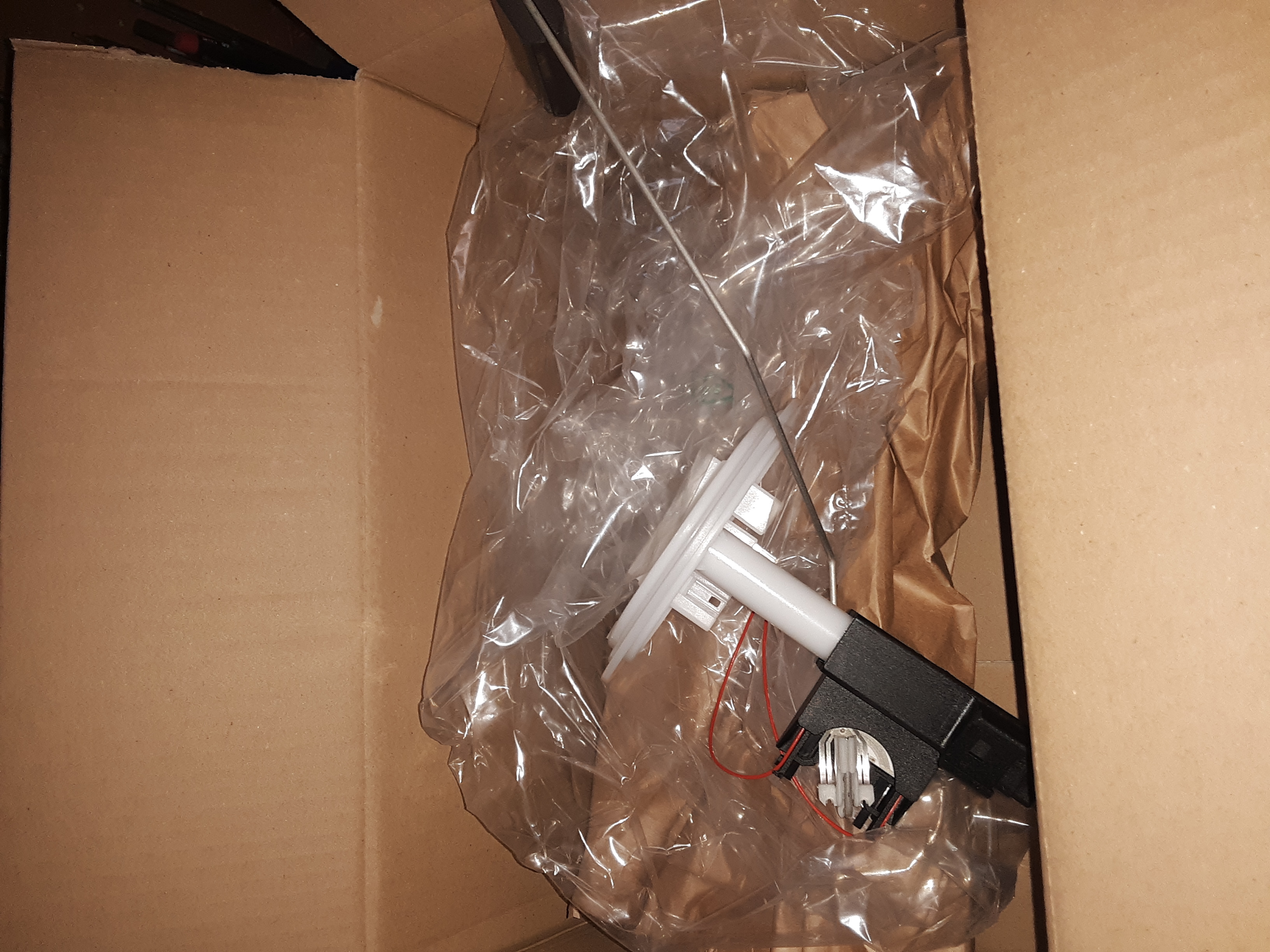

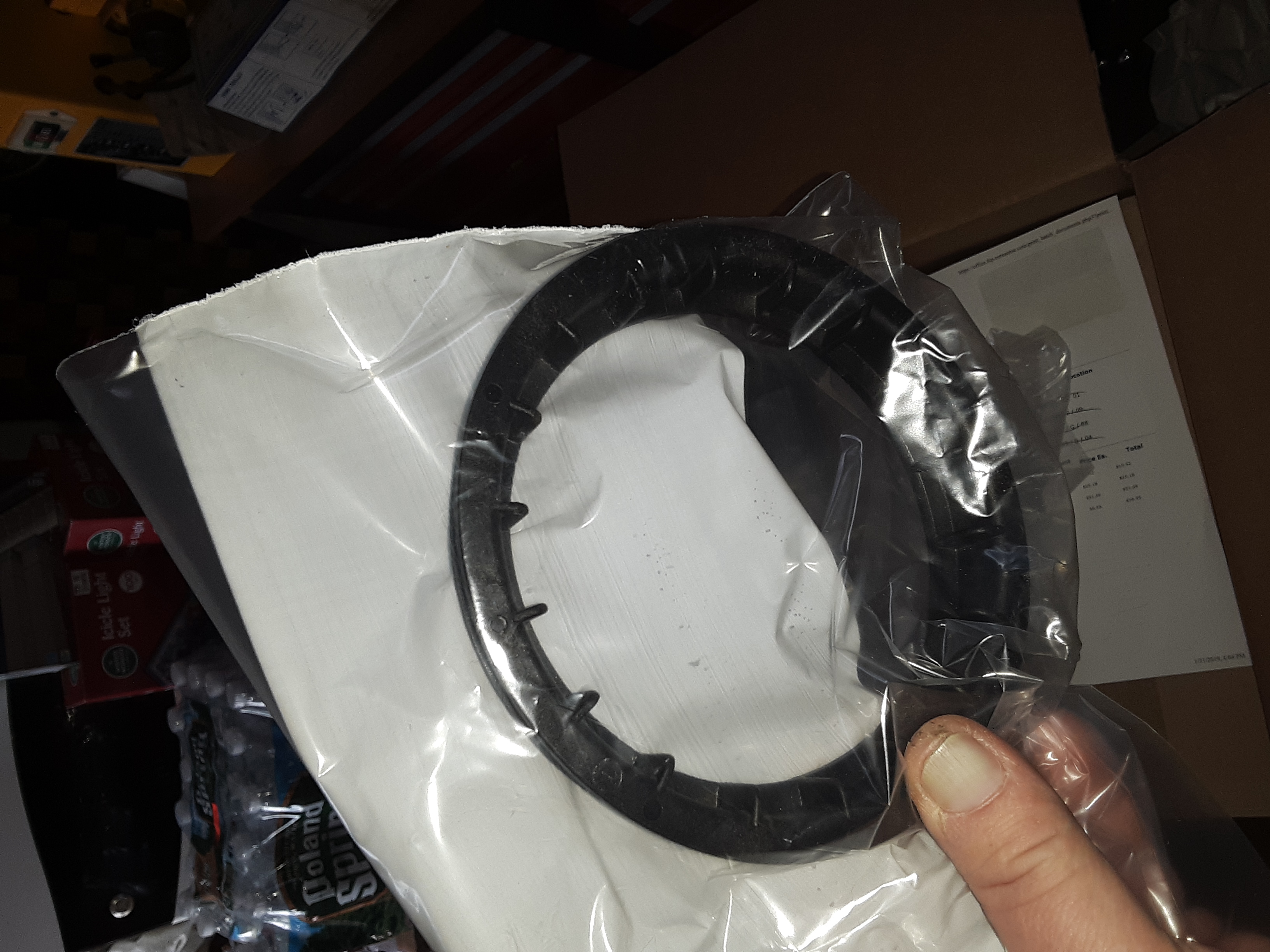

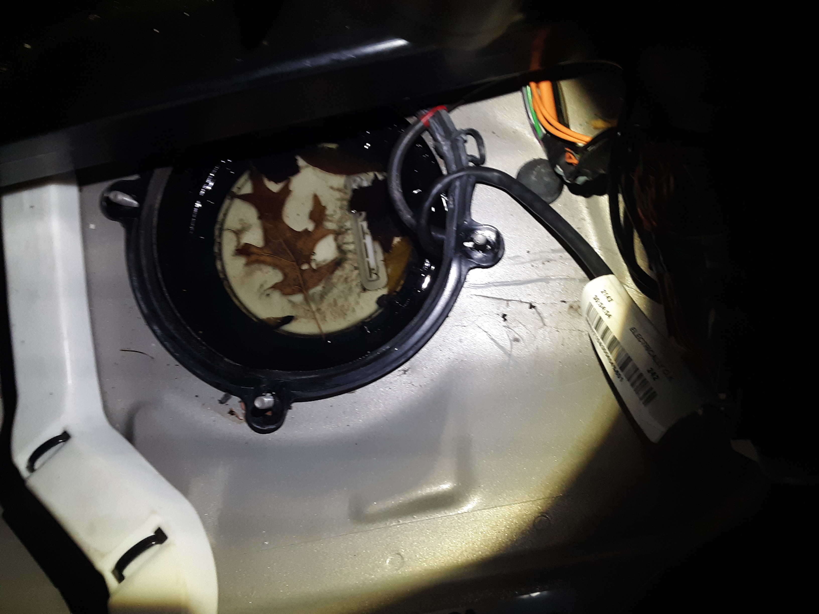

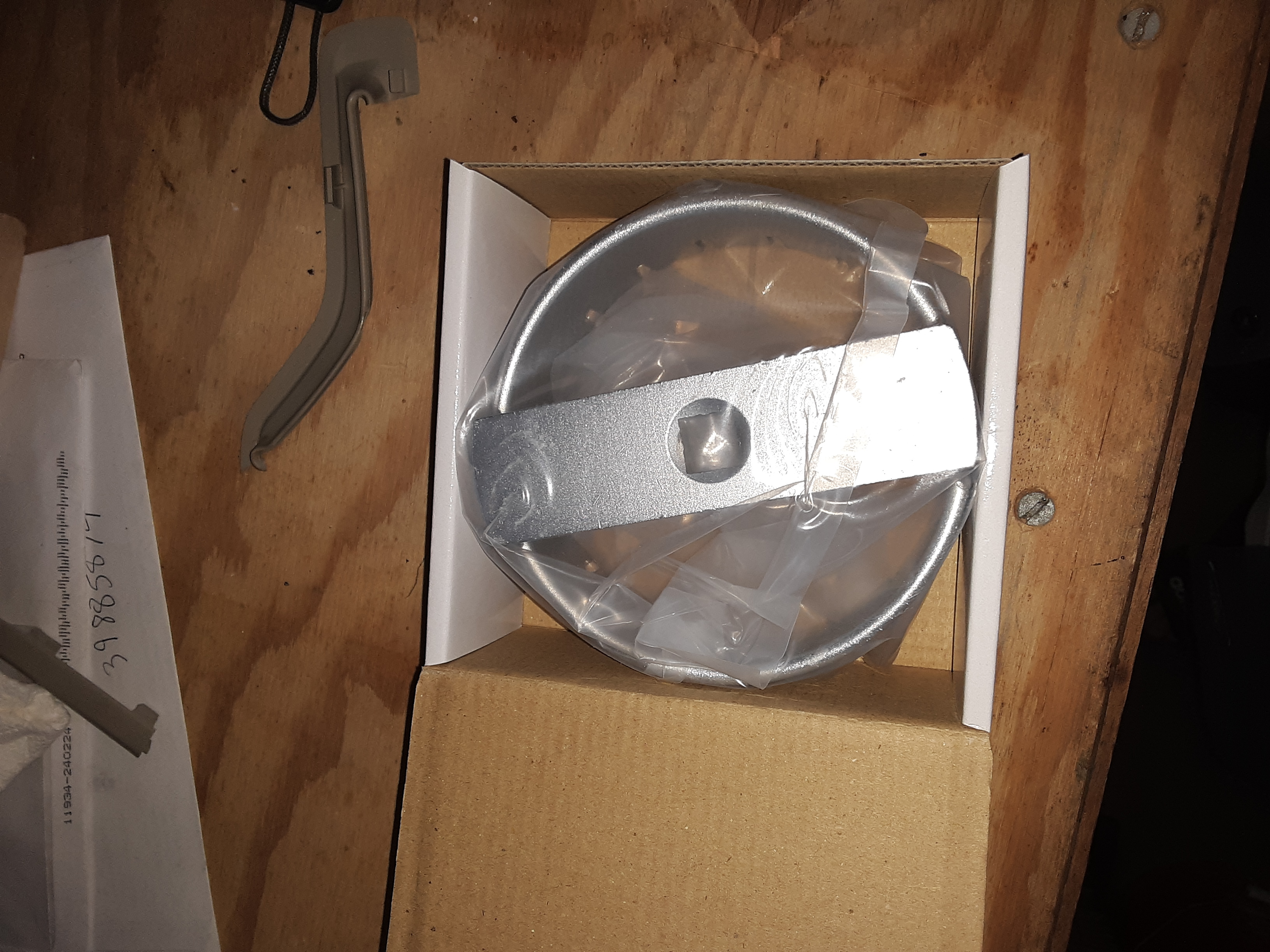

I found fuel pooled up on top of sending unit.
So I ordered new seal, lock ring and sending unit.

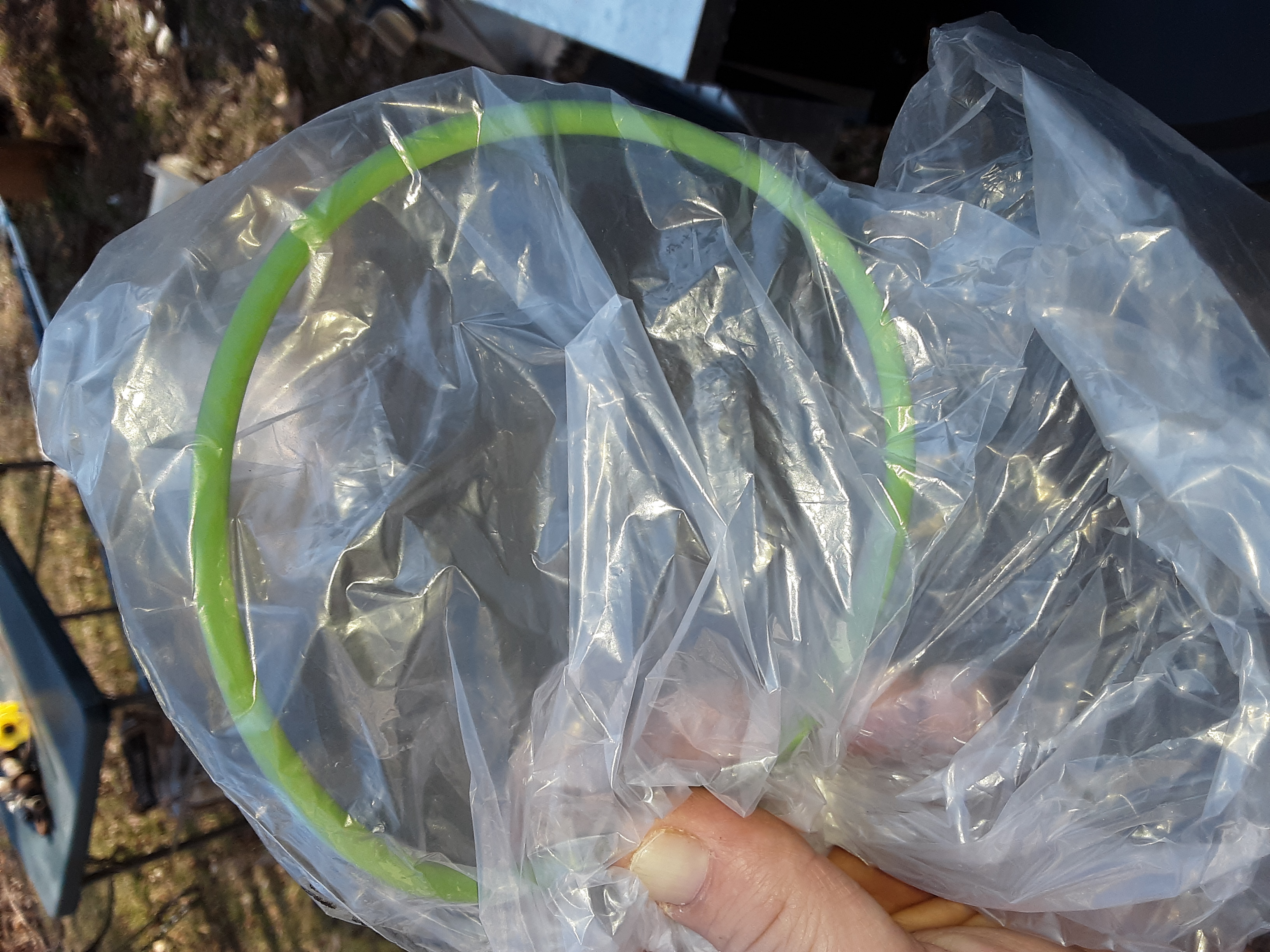

It wouldn't make sense to go through all this trouble removing the middle row of seats and skip replacing the o-ring. The plastic tank uses a green o-ring and the metal tank uses a black o-ring. I used my VIN # to order mine directly from Volvo because I wanted it ASAP but you can easily check underneath your XC90 to see what you have.
I found some useful information using Google, turns there was a recall on some earlier years of the XC90 concerning the fuel pump. From 2003-2005 some XC90's were affected, it was about 130k that were eligible for this recall...I think it worth looking into.
