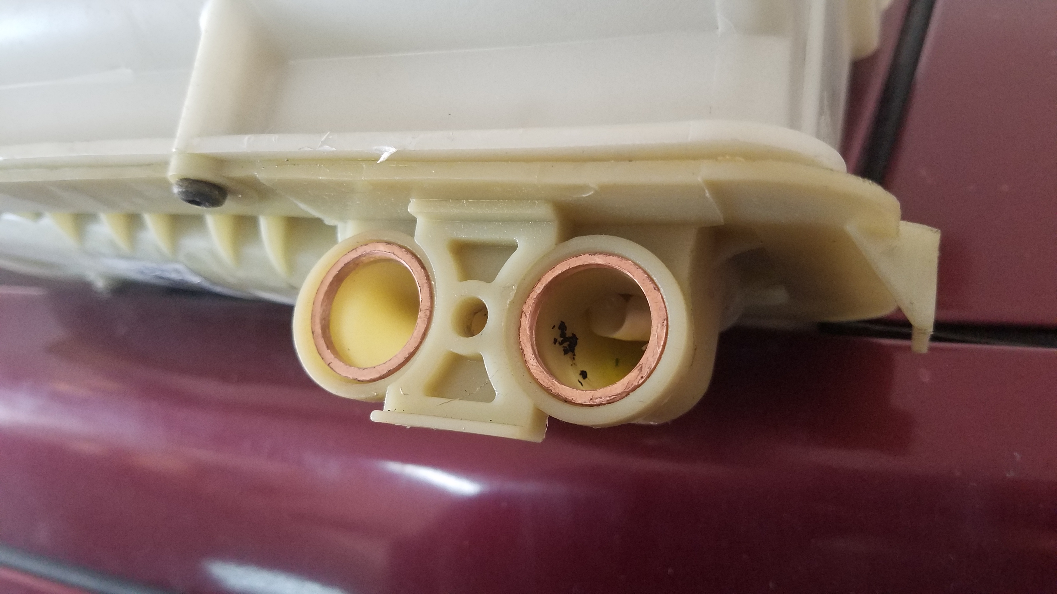

That's interesting. I assumed I would need some sort of valve to ensure only air was getting out, but a t seems like an easy solution. I don't think the heater core is blocked because when I took it out I ran water through it and there was no resistance. I did notice that the inlet hole of the heater core was about the size of my pinky, but the outlet hole was closed by plastic leaving only a 2mm hole drilled. I assumed this was on purpose to force coolant to fill up the heater core. Can anyone verify that this is correct?

Bingo. Not normal at all, both holes should be completely open.ryanmcgrim wrote: 03 Feb 2019, 08:37 ... I did notice that the inlet hole of the heater core was about the size of my pinky, but the outlet hole was closed by plastic leaving only a 2mm hole drilled. I assumed this was on purpose to force coolant to fill up the heater core. Can anyone verify that this is correct?

+1 to above. The orifice size there should be much larger. Both orifices should be penetrable with a finger.

That's crazy, it's definitely manufactured this way. It's smooth with a cleanly drilled hole. Is this just a pilot hole and they never came back over it? Man I've been screwing with the heating system for 3 years and it's all because of this. Not happy with sweedish car parts. I guess I figured out why the new and improved heater core isn't so improved. Did I get a bunk one or are they producing all of them like this? Surprised I'm not having over heating issues.

Ignore the copper washers but as you can see both ports should be equal diameter.

I just got a heater core from SCP a couple days ago. Both ports are the same size.
Sounds like you got a defective one. Get in touch with them and get a replacement.

Should be an easy fix. Drill out the port, flush out the plastic debris and enjoy the heat.
