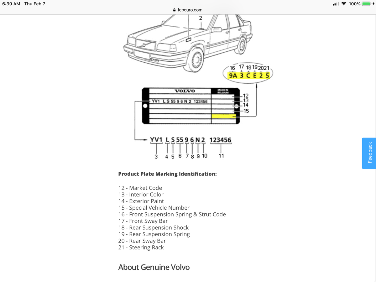

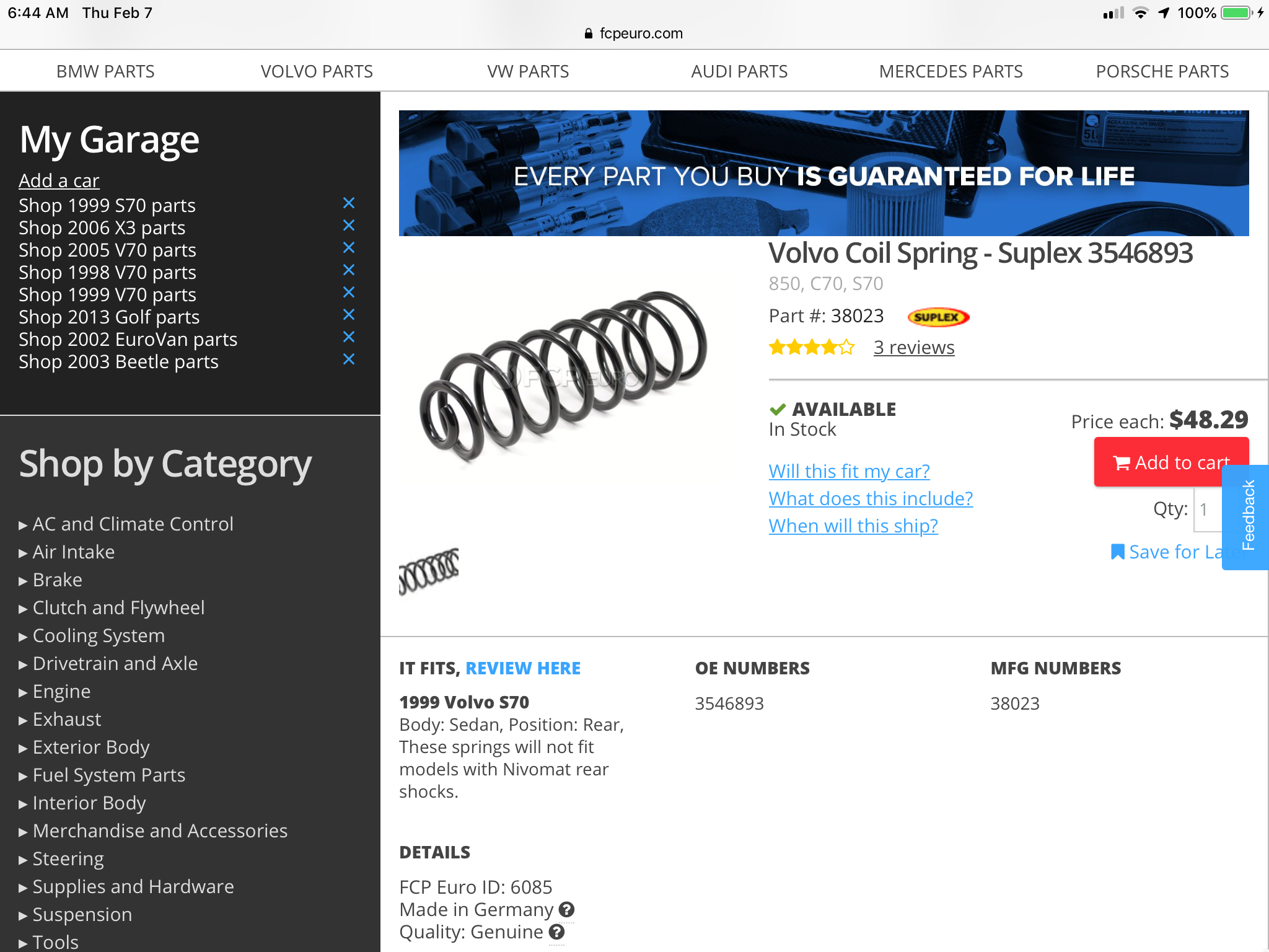

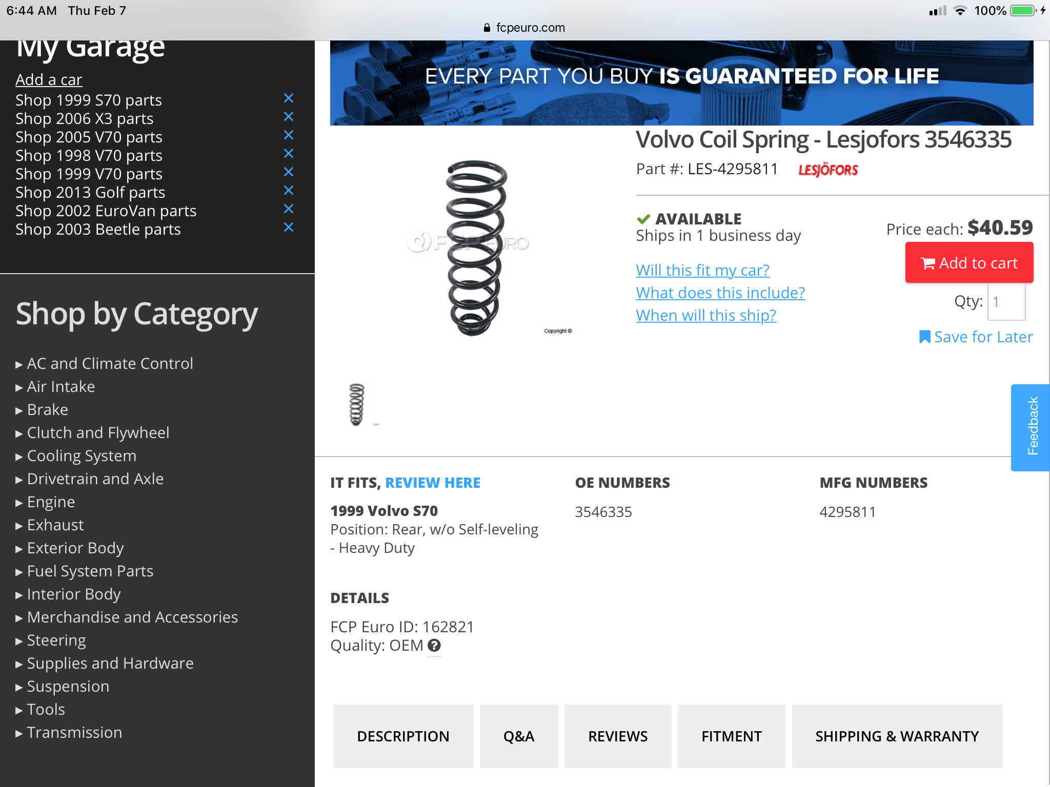

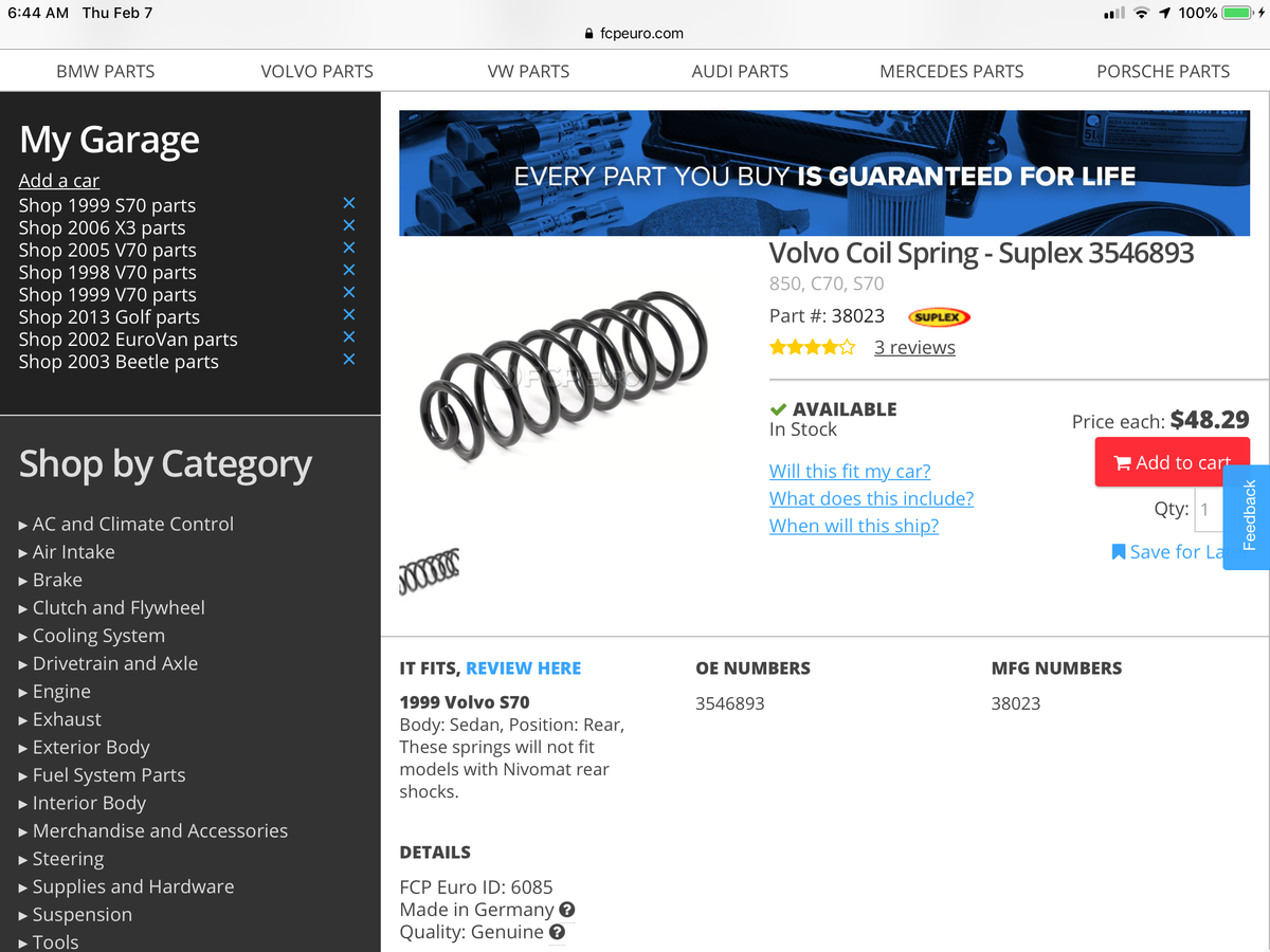

I’ve got a choice of standard and heavy duty from FCP. Anyone have input?
I might talk Jason into sending me both and measuring the spring constant in each
Original Volvo also backordered and no ETA BY THE WAY.
1999 S70NA rear spring choices 3546335 or 3546893

If you have a look at the PDF on top in this page;
http://www.proparts.se/sv/artiklar/chas ... index.html
You'll see that the first one you're suggesting is
12.50 * 126 * 385 mm
The second one;
12 * 126 * 392 mm
The second one;
12 * 126 * 392 mm
- Posts: 36142
Tack, LOB!
- Posts: 36142
Ordered the heavy duty ones. My roads are good and smooth and I prefer a stiff over soft ride. Love the HDs on my V70
