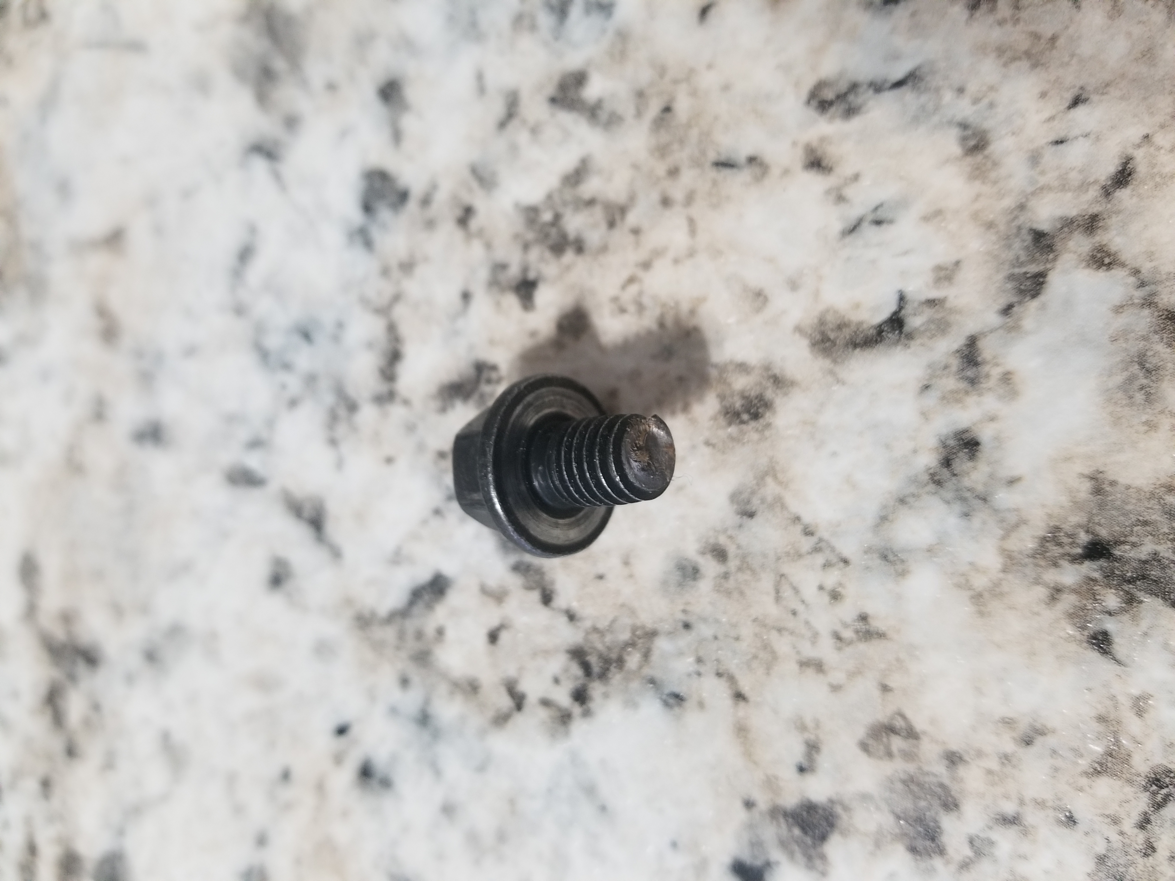

Long story short I was finishing the water pump installation and noticed it was dripping coolant. So I pulled out my torque wrench, set it to 15 lbs/ft, checked all the bolts again. Got to the bottom bolt and it promptly broke off inside the block. These were new Volvo branded water pump bolts! So I'm just dumbfounded as to what to do. Half of the bolt is stuck in the block and I am not sure how to even get it out. Plus the water pump is behind the unibody so I cannot get a drill in there. The good news is that I've officially changed a Volvo timing belt and that gives me something to celebrate.
Any ideas or advice? I'd really hate to have to pull the engine block to get that single bolt out!

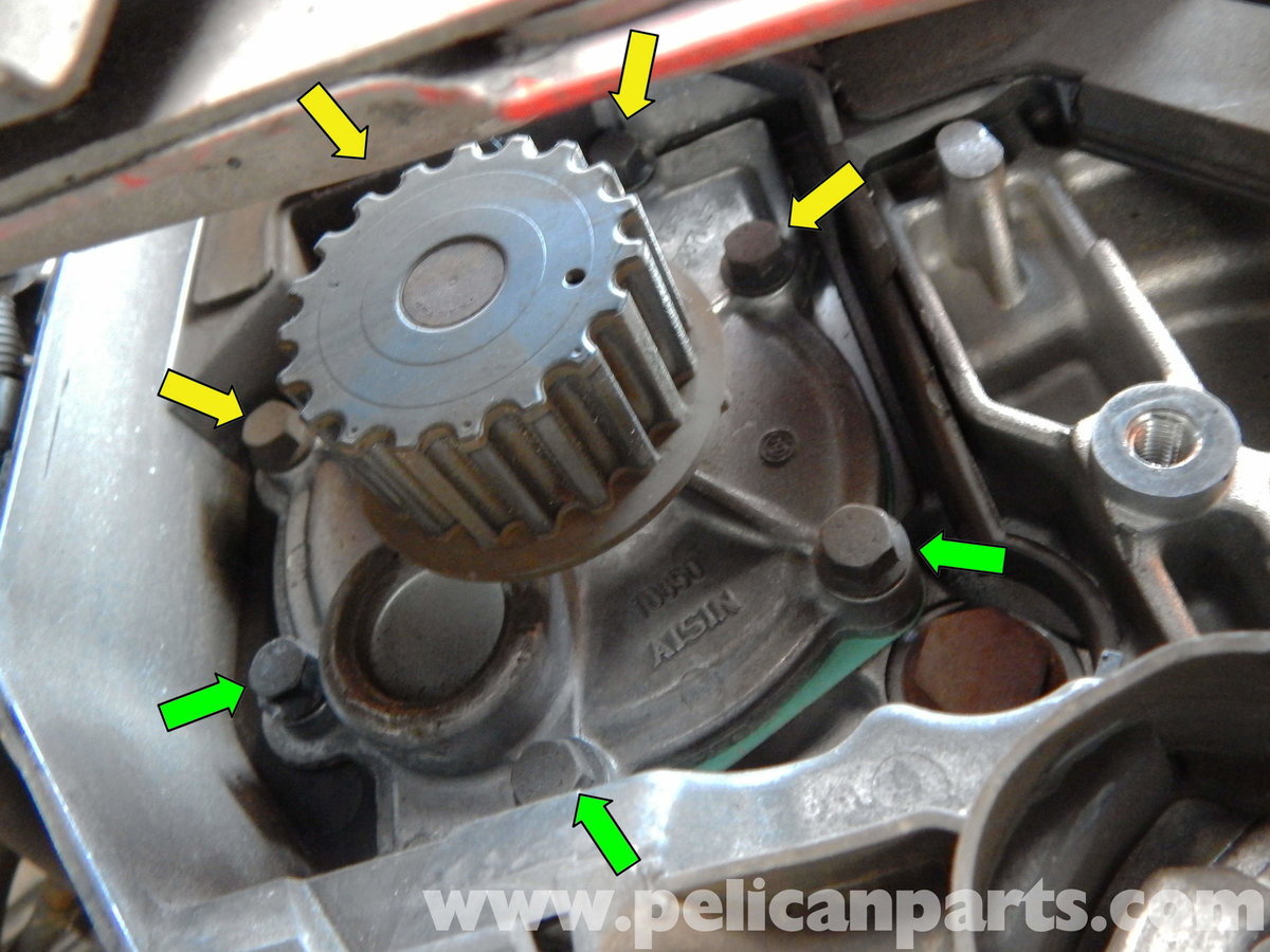

You may be lucky...the broken bolt you showed is probably flush with the mating surface.
I borrowed a photo from the web, is the broken bolt at 6 o'clock position?

Yes the one at at the 6 o'clock position is the one that broke.cn90 wrote: 10 Feb 2019, 21:55 You may be lucky...the broken bolt you showed is probably flush with the mating surface.
As far as the torque wrench is concerned it was clicking on all the other bolts. I never store it in the locked position. I try to take care of my tools. I was going very slowly and gently bc 15 lbs/ft is just a smidge off hand tight. I KNEW that it was making the bolts too tight. But bc my hands aren't calibrated to lbs/ft I trusted the device. I wonder if it was affected by the super cold weather. Looks like I'll need a beam type in the future!
Alright I'm going to try and fix the car today. I'll report back with success or failure
