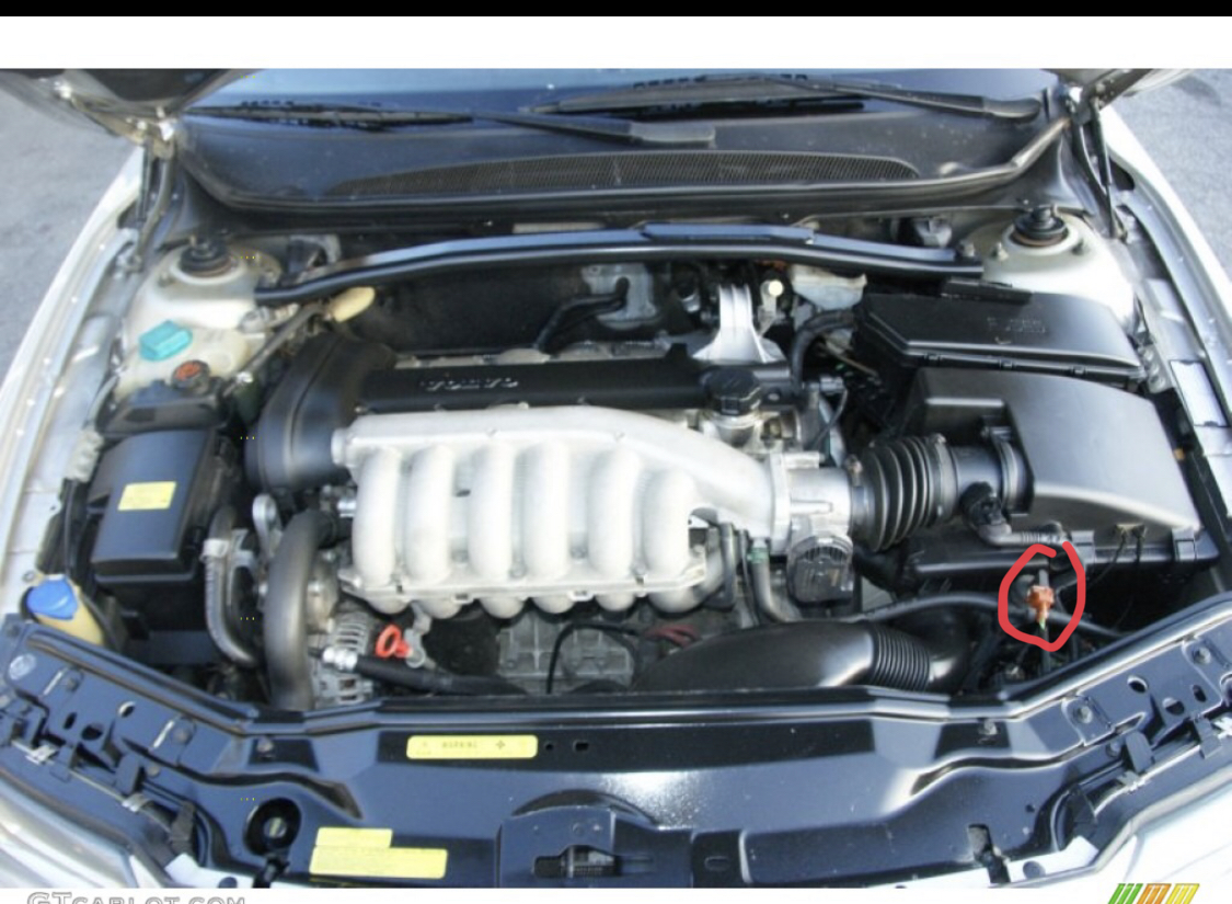

Starts but won’t drive will reverse

That is the electric brake booster vacuum pump switch. That switch failing will only case hard brake pedal for a minute when cold.
Is the transmission fluid level OK?

Yeah I checked it but still not sure if I have enough because the car starts up no problem it’s just when I go to drive it just revs and ges no where also got a code P0303

P0303 is misfire cylinder 3
