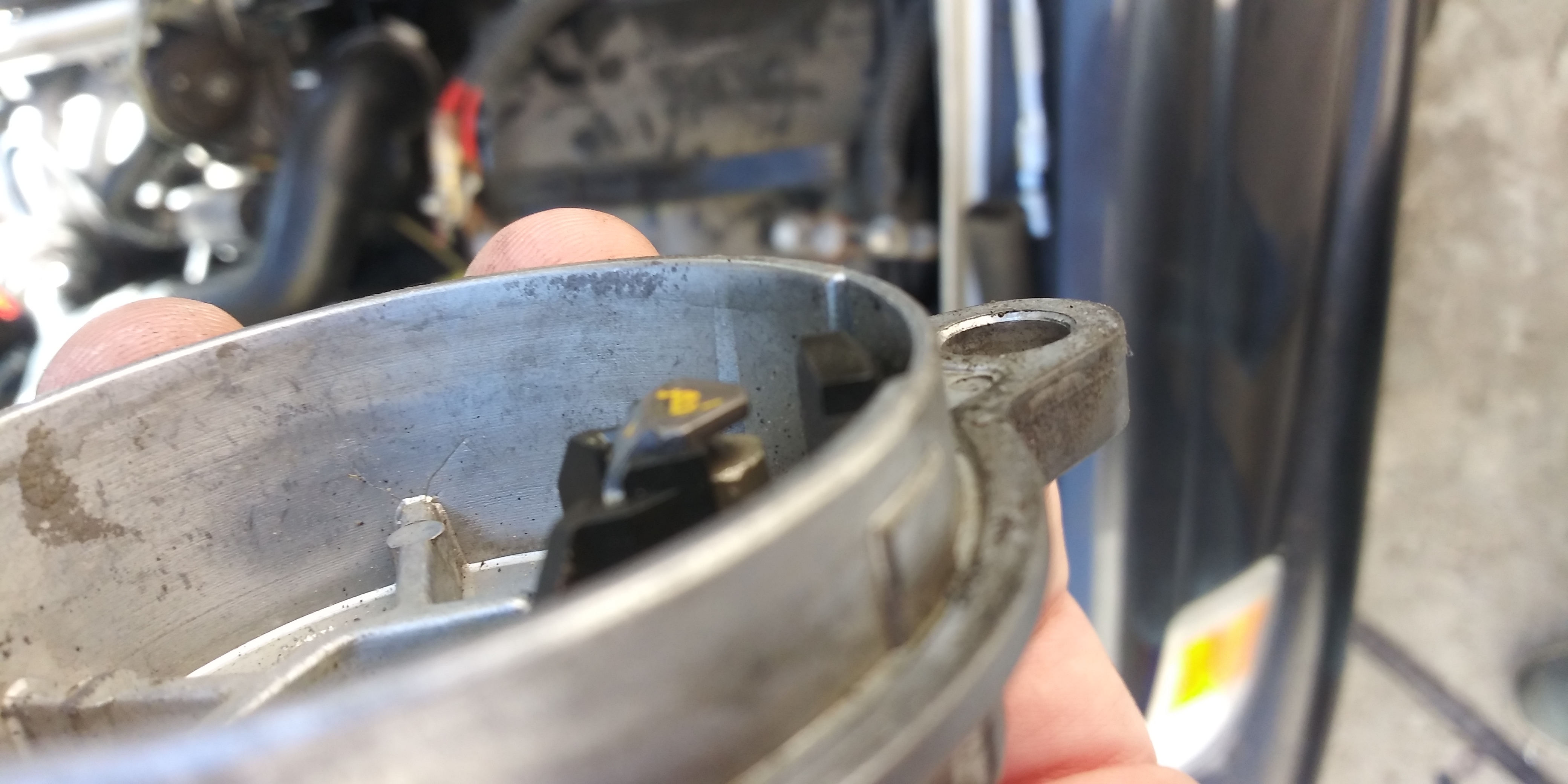

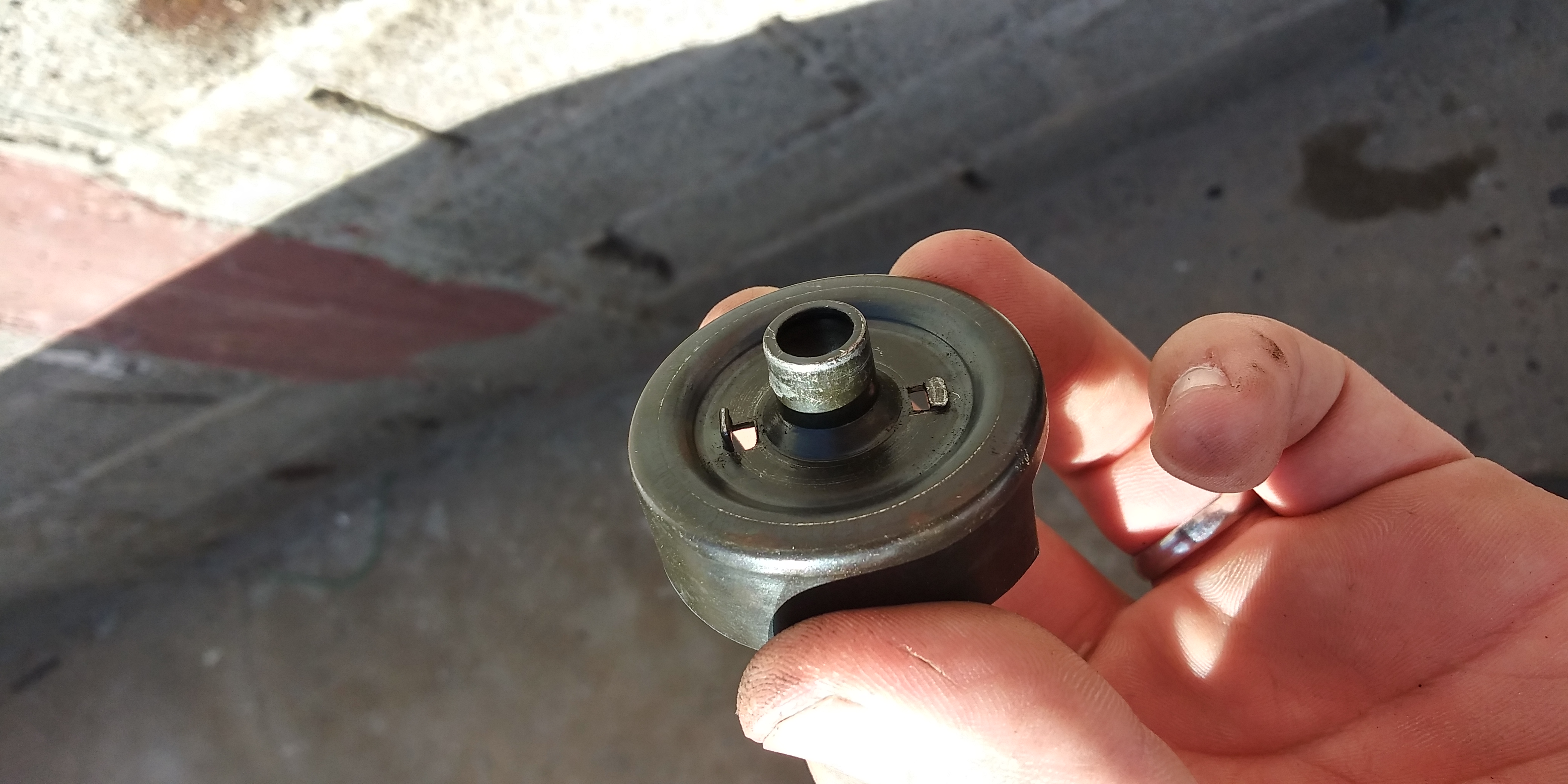

Check the circular, black metal brackets on the back end of the cams, there is one under the cap and there is a different one under the cam sensor. It is possible to put them on wrong and then you can get no spark.
It's also possible for the electronics inside the rotor to go bad, then you get no spark through the rotor. But sounds more likely related to the engine work, check those brackets.

Okay I'll try to check that apt I got the car to run a few seconds dad died and now I don't have any spark even at the coil or nowhere
- Posts: 11913
- Joined: 25 Jul 2009, 14:03
- Has thanked: 312 times
- Been thanked: 818 times
No spark from the coil is one possible result of a bad cam sensor. Could be the plate, could be something else. Worth also checking the cam and crank sensor connections.
Rubenrodri126
- Posts: 17
- Joined: 20 Feb 2019, 08:38
- Year and Model: 1997 850 t5
- Location: El paso
jimmy57
- Posts: 6696
- Joined: 12 Nov 2010, 09:25
- Location: Ponder Texas
- Has thanked: 5 times
- Been thanked: 322 times
The sensor wheel you are holding has been put on wrong. There should be two tabs sticking up. The tab to the right has been flattened by it being on top of the cam end instead of down in the slot ground on cam end. You might be able to pry that tab up and fit it correctly.
