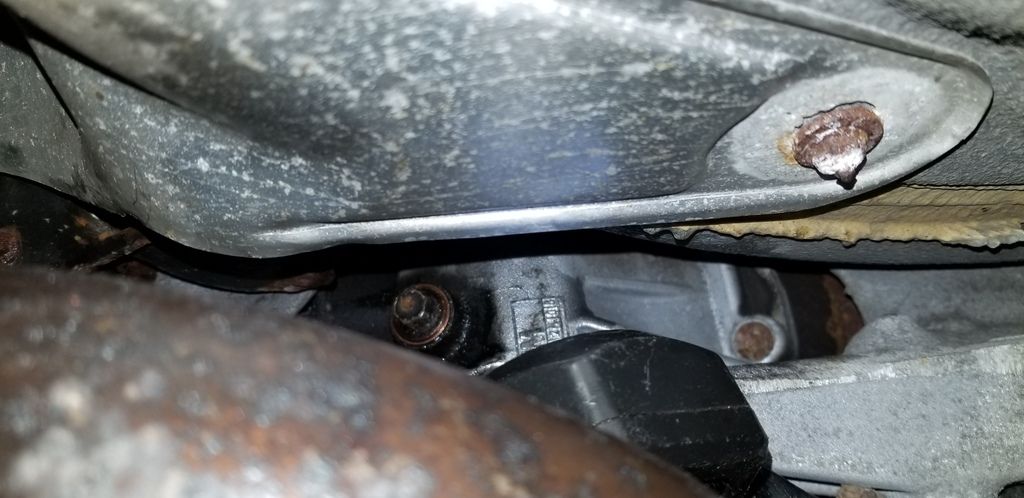

Here's a photo off the drain plug facing the passenger side.
Used a 13mm wrench to reach the drain plug.
The thick gear fluid was dark brown.

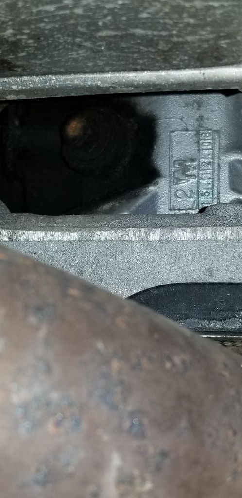

The rear bevel gear drain plug is harder to reach. The drain plug faces the rear of vehicle.
Here's a photo of an extended swivel wrench attached to the 13mm drain plug.
This is the rear drain plug after adding fluid and installing a crush washer.

There was black crud surrounding the drain plug due to the missing washer so it appears to of leaked.
This photo is the rear drain plug before touching it.
