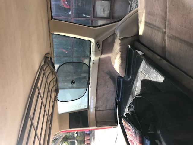

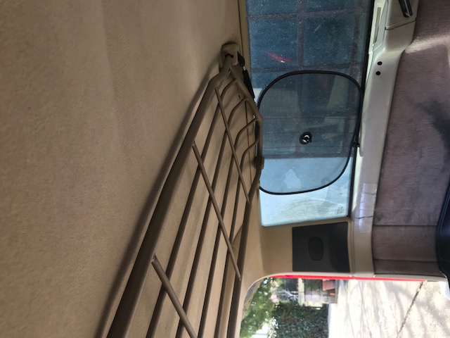

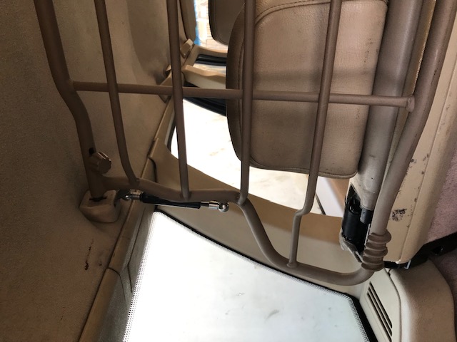

Hello guys, thank you for the kind feedbacks. I have not got any hook or place to clip on the back of the rear seat. I am wondering what Neil was writing, is it possible that the grill itself is not correctly installed? I attach a few pics how it is temporary solved, a double plastic clip attached to the middle headrest support. I am sure that this is not the way. BR, Tibor

Is it just me or is it mounted backwards?

No, the cage is not mounted backwards (i.e. not fitted the wrong way around) however it was indeed installed wrong. The roof mounts should hook backwards, not forwards. The left mount is on the right side, the right mount is on the left side.
I've installed these a few times, it will be easy to take them apart and correct this issue. Remove struts, remove cage from fitting, remove plastic covers, remove mounts, swap sides, reassemble.

the project is finished. As you said, the hinges were reversed. It took me 10 mins to finish the whole job. The metal hinges were tightened with one T25 srews on each side, easy to Access. The beige color plastic cover is heat welded to the metal hinge, don't force it, comes off together. To refit the gas struts, you need to lean forward down the seats, the grill to come forward more and than snap in place easy. After fitting everything back, the grill holds nice and firm against the backrest, when open stays nicely up inside the roof. Great, I am very happy with it! Ready for the next improvement! Have a nice day! DT
