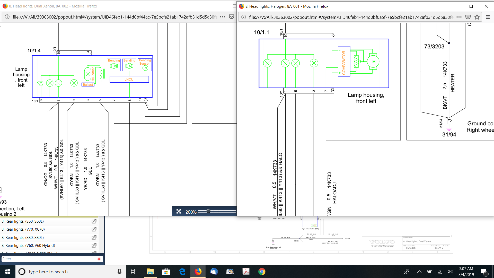

Hello all. I want to convert a 2015 xc70 t5 drive-E model from a stock halogen to a stock HID system. Any suggestions?
I'll purchase the stock HID headlight housings, ballasts, etc.
Will the HID harness plug in to the stock system?
Thanks

Looks like the electrical system is quite different between the two systems.

Thanks, Rick
