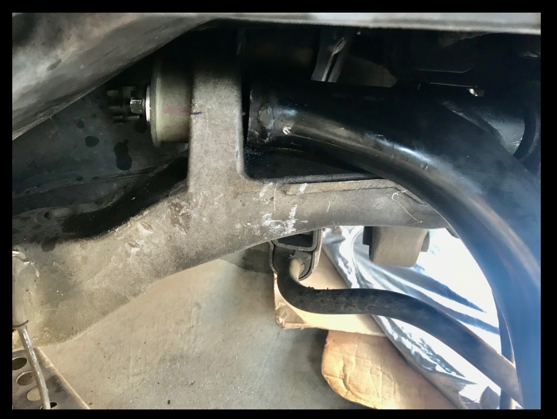

Hello, almost 2years ago when my 07 v70 2.5t was hit by a drunk driver while parked at the curb, rear left door caved in and flat tire, toe in approximately10degrees
.installed the doughnut wheel on and eyeballing rear wheel alignment. Next day removed the wheel and inspected the suspension then found out the upper control arm was bent and cracked .
Got quote for $800.00 parts and labor on suspension only.After a few hours of figuring what to do,an idea popped up. Went to a junk yard found an 04 s60. After removed nuts &bolts (save #18 bolt in diagram for use it later) and parts , out of rear suspension except upper control arm. I used cordless saw (would be better if I have the cordless multi tool saw it’s more handy than regular saw)to cut the front bushing holder (subframe) then pried up and away then removed the arm out

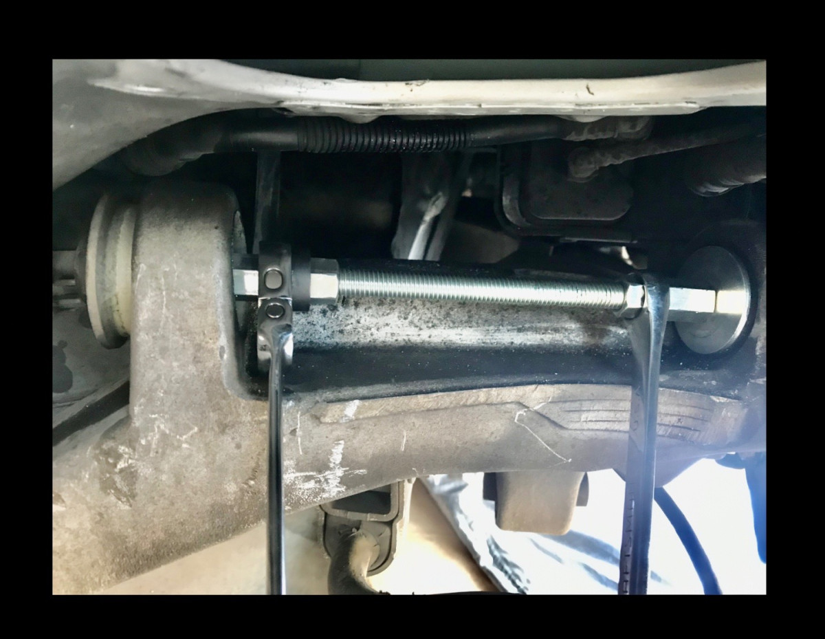

I went to Lowe’s and bought 12” long 1/2”-13 unc threaded rod,2 pieces each of: 1/2”-13 coupling nuts,1/2” washers, 3/4” washers (actually I used only one)which had 2” Outside Diameter which matched perfectly to bushing OD. I enlarged one of 3/4” washers hole from 15/16” to 1”1/8 dia.with Harbor Freight steps drill bit.

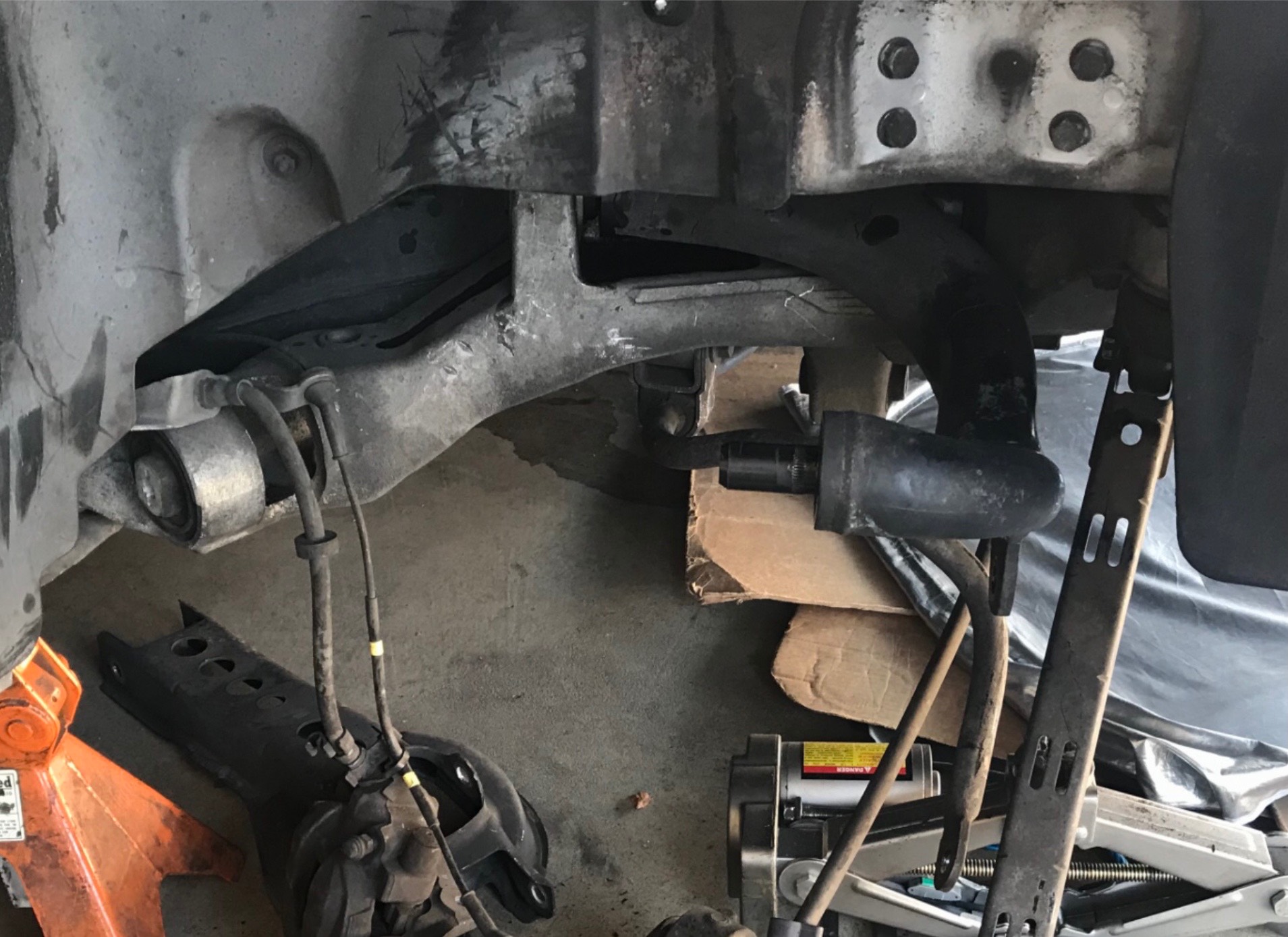

Let’s rear end sit on jack stands then remove everything as like I did at the junkyard.
Then I cut the damaged upper control arm into 3 pieces using the shortest saw blade to avoid cutting into subframe,multi tool saw works best or just cut both ends off. I didn’t think of it at that time.

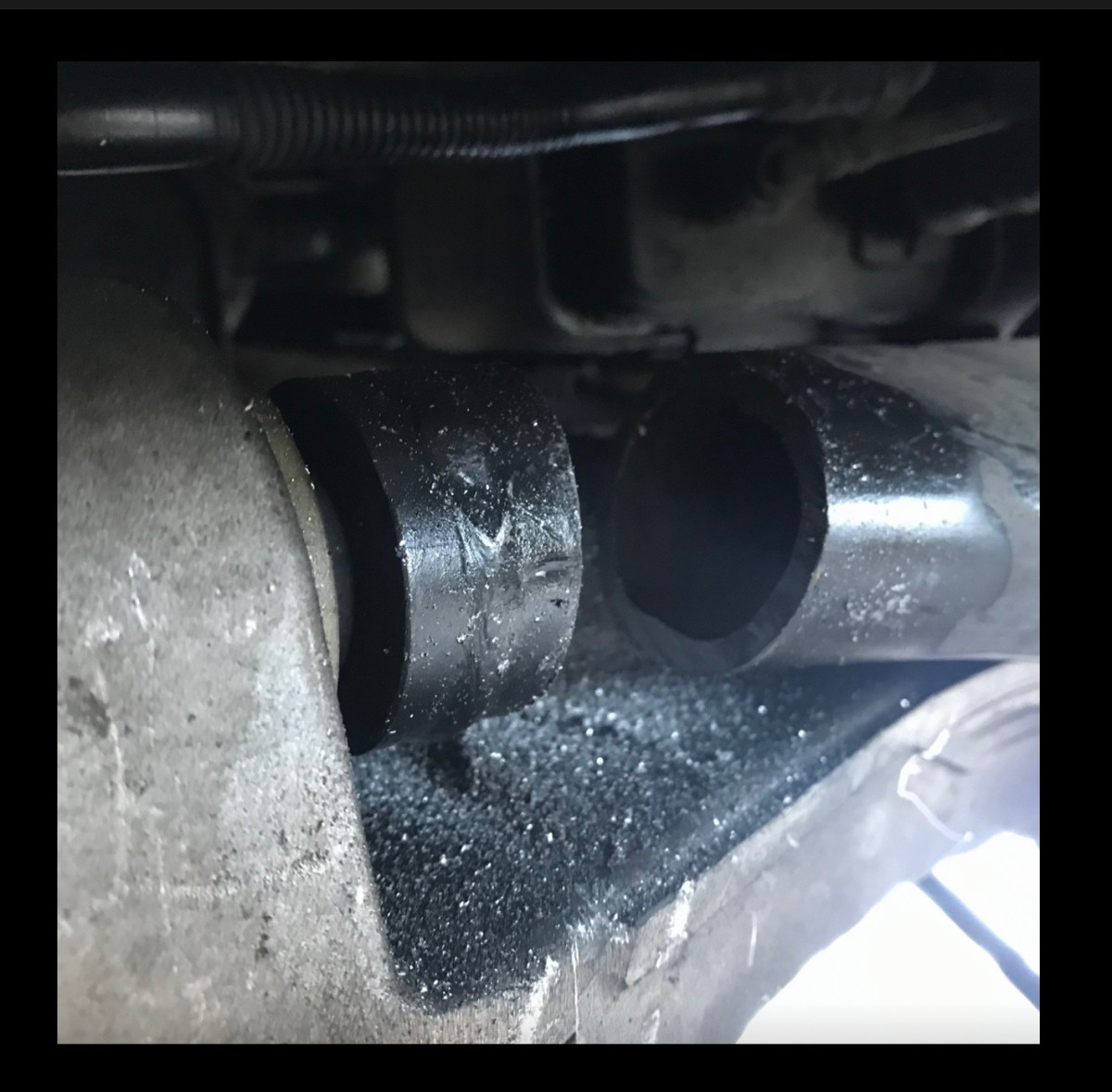

It’s easier to remove the arm, the 12”rod is too long, I cut 2”off making it easy to fit between those 2 bushings and press the front bushing about 3/4 lengths or all the way out of subframe I reusing old bushing
Insert front end arm into bushing holder ( subframe) and rear arm into rear bushing and screw the bolt a few turns into the arm, screw the ( saved #18)bolt with 1/2”washer in, because it’s longer length to reach front arm threaded hole, tightening both bolts at the same time til bottom out,loosening the rear bolt and remove front bolt (if can’t take the bolt out cut it into 2 pieces an remove the other ends out).
using 2x2x12 or longer pieces of wood put in front bushing gently hammer it in then screw the original bolt in but leave it loose. Screw the lower control arm to subframe not tight,upper spring seat to the frame,Shock with top nut in,spring in with the bottom push over the lower control arm bump , jack control arm up I have an electric scissor jack, very handy when no helper one hand press up button and the other hand push and hold the spring in place lucky it didn’t slip,high enough to connect the shock,sway bar linkage,install the knuckle to both arms,screw trailing arm to the knuckle the other end to subframe to get ends meet is to raise lower arm higher. Screw in the toe in &out control arm to the knuckle, raise up the lower arm til the car body starts to move then tighten up all the nuts & bolts.
It costs me about $200.00 on part & tooling and dents repairs tools, took me about 10hrs. from start to finish( first time job if I have to do again would be faster) that not including the junk yard and home made tools time, and another less than 8hrs.to work on the dents without replacing the door or repaint (quote more than $2,000.00 for body work and painting)turnouts okay but not perfect.
Yes got reimbursement from Insurance and bought 4new tires and 12v 100 amps lithium iron battery.
Hope this could help…
